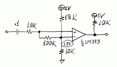

So I've been on a bit of a quest today. Trying to make this thing reach a 74HC' without a 74HCT' in between.
Attached is what I came up with. I think this works, I have been testing it with the 'scope with various levels of the pot.
I am seeing signal degradation if I try to hold the signal high too long. I see what's coming in and out of the OpAmp and it spikes at the beginning, but trails off rather quickly. Adjusting the pot lengthens or shortens the duration of a $FF type of byte, which is bad news. Single short bursts are unaffected. The $00 type bytes seem unaffected.
Anyways, the two 2N2222 transistors step-up the signal coming out of the OpAmp from around 3V or so to 5V. I'm getting a nice clean signal on a plain ol' 74HC00 with this! Does this look right to you guys? I am extremely new to analog stuff. Looking stuff up online has helped a bit of course.
Just wanted to by-pass a whole 74HCT' chip, that was the main goal of the day. I'm a little worried about signal degradation, though that's not the transistors fault (was getting that with the 74HCT' chip too), but I'll be working with this in software and hope to report back more results soon.
Thanks everyone!
Chad

Would you prefer that the output be low, or high, when there's no input signal? Or does it matter? (I would do it with a single comparator section of an LM393 dual, and omit the transistors; but which way you want it would determine the configuration.)
Re: Modern Homebrew "Cassette" Data Communication
Posted: Sat Mar 26, 2022 9:29 am
by sburrow
I don't mind high or low honestly, I'll be connecting it to a VIA and 'babysitting' the input. I could use interrupts, but even then either high or low is fine.
I went to the LM393 datasheet, well one of them, and I cannot find a configuration that matches what I'm trying to do. There seems to be a LOT of configurations though:
https://www.ti.com/lit/ds/symlink/lm393-n.pdf
If you give more input, I'll receive it gladly! Thank you Garth.

I note that on your schematic you’re biasing the opamp at GND. Is this intentional?
I would probably bias it at half VCC. Maybe it’s just the phase of the output that’s affected by that.
Posted: Sat Mar 26, 2022 8:29 pm
by GARTHWILSON
Biasing at ground is typical for if you have ± power supplies, which you don't.
Op amps don't do well as comparators because if they hit the ends of their output voltage range, they take longer to recover. That may not be a problem here at these lowish audio frequencies. A cheap LM358 dual or LM324 quad op amp can still do about 7kHz when clipping at both ends of the range, if I'm remembering my test results from years ago correctly.
Comparators are made to hit the end of their output range and do not expect to spend time between full positive and full negative. They're also made to be faster for a given price point, but they don't try to hold to a phase margin, meaning that if you try to use one as an op amp, you'll get an oscillator unless you take appropriate measures which will mean slowing it way, way down.
The LM393 dual comparator (and LM339 quad) has open-collector outputs, so they can pull all they way to ground, and the high end of the range is whatever you pull it up to, in this case 5V. There's no need of additional output transistors. The voltage you power it from is independent of what you pull the outputs up to, although it the diagram below I did it all for 5V. This is slightly simpler than what I originally had in mind, since you said you didn't care what it does when there's no signal. The bias point is 1.8V, not 2.5V, because the input range does not extend all the way to the positive rail like it does to ground. 1.8V puts it approximately in the middle of its input range when you power it from 5V.
Decades ago, I had considered the single-frequency on-off too, as it would enable a faster data rate, but decided against it for the reasons Jeff gives, about the automatic gain control (AGC) or automatic record level. These typically will clamp down very quickly to prevent distortion, but take time to bring the gain back up. I probably should have tried it, but I didn't.

Hey everyone! Updates:
Garth's circuit above is great! The only issue was that I had said, "I don't care what the output is without a signal." But what I meant to say was, "I don't care if the output is low or high, as long as it is constant, without a signal." Garth modified his circuit to pull the output high when not in use, see attached.
I then made a small C++ program to combine 2000 Hz and 1000 Hz sine waves as 1's and 0's. Output is nice square waves between 0V and 5V, perfect!
Then I programmed the 6502 to read PA6 on the VIA, "babysitting" mode, no interrupts. The operation is very simple: Wait until PA6 goes low. Then count down from some arbitrary value. If PA6 goes high before the count is zero, it's a short signal. If the timer runs out, it's a long signal, but then NOP until PA6 changes back. Very simple, even in my weird and non-optimized code it was only about 33 instructions.
I was having WEIRD readings for a long while though! Every short was coming in as a short, sometimes coming in as 2 shorts. But every long was coming in as a short, long, and then another short! HUH? It took me a couple hours until I figured it out. It's not my code, it was the signal! I zoomed way in on the scope and sure enough there are little spikes right before and after every long. What I then did was when I saw PA6 change I NOP'd 16 times and that fixed it immediately.
We have mass data input!!! Super excited to see this. I think I'm going to ditch my ideas to record from the 6502 though.
Off to the next project. Thank you everyone, and a HUGE thank you to Garth! Again, I couldn't do what I do without y'all.
