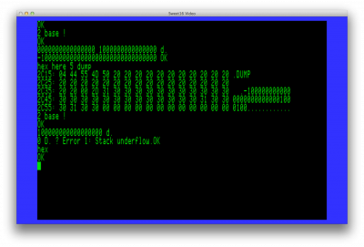

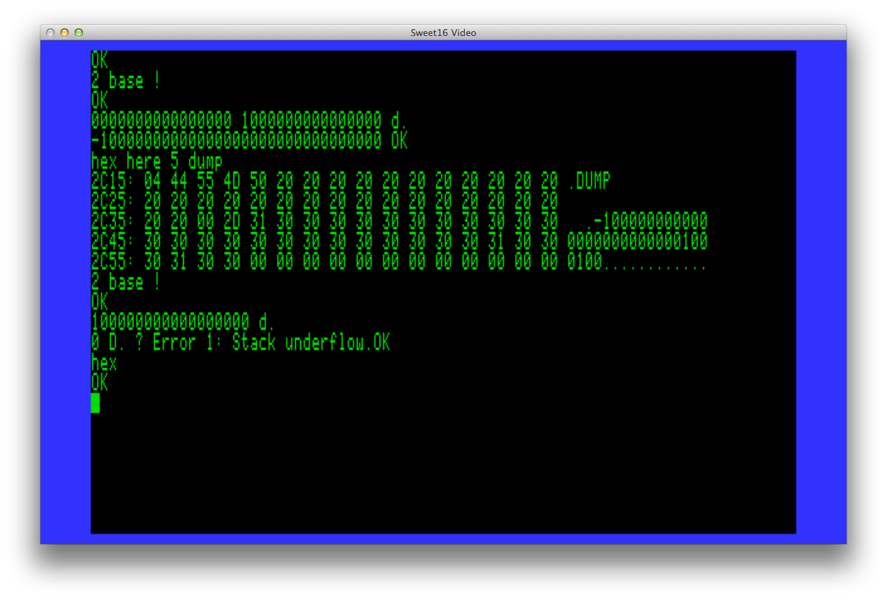

Ok, I am getting closer.
Dealing with binary numbers, the largest 16 bit-number that can be entered is 16-1's. But entering a 16-bit double number can not be entered as 32-1's. It has to be broken up into 2 sets of 16-1's. Which means that only 18 bytes is needed at HERE to form a 16-bit double word of 32-bits as each 16-bit binary number of the double number gets copied to HERE separately.
When printing the double word, still needs 32 bits in the PNO buffer to print out those bits.
We are now up to 18 bytes at HERE for the binary word being interpreted and 32 bytes in the PNO buffer to print the binary number to screen for a total of 50 byte space required between HERE and PAD.
Notice in the picture that the last line was entered with 18 digits for the binary number and I got an UNDERFLOW ERROR.
