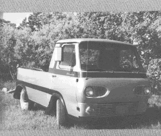

I am in the same boat. I have a 59 Ford Econoline, snub nose and open box, I would really like to get going again. The engine is right beside the driver in the cab.
One of those that noses over if you brake too hard? :lol: I drive an '88 15-passenger E350 Econoline Clubwagon with a 460 V8. I got it for camping, but we have not done any of that in years. It's huge, and has come in handy many times we needed to move big stuff. If I'm careful, I can get 11+ mpg in town; but I drive less than a thousand miles a year, so it's an economy car.

I've never had the pleasure of seeing or even knowing a '59 Econoline existed. Do you really mean a 1961? I briefly owned a '66 Econoline and a '74 Econoline, but they were both basket cases and I gave them up for scrap, along with a '73 Datsun 240Z and a '76 AMC Gremlin. They've all been gone for about 20 years, when I had to downsize my collection of hoopties. Come to think of it, the Ranchero started out for me as a basket case too (and plausibly still is), with its Flintstone floorboards, broken heater and rotten brakes, but at least I put a couple hundred semi-useful miles on it before I made the dubious decision to tear it down and "restore" it.

I guess it could be a '61 as some of the parts on it say 1960. But I think the registration I got listed it as a '59.
By the way, I took this picture and scanned it with a Quickie Scan on a IIGS quite a few years ago. Thus the grayscale.
