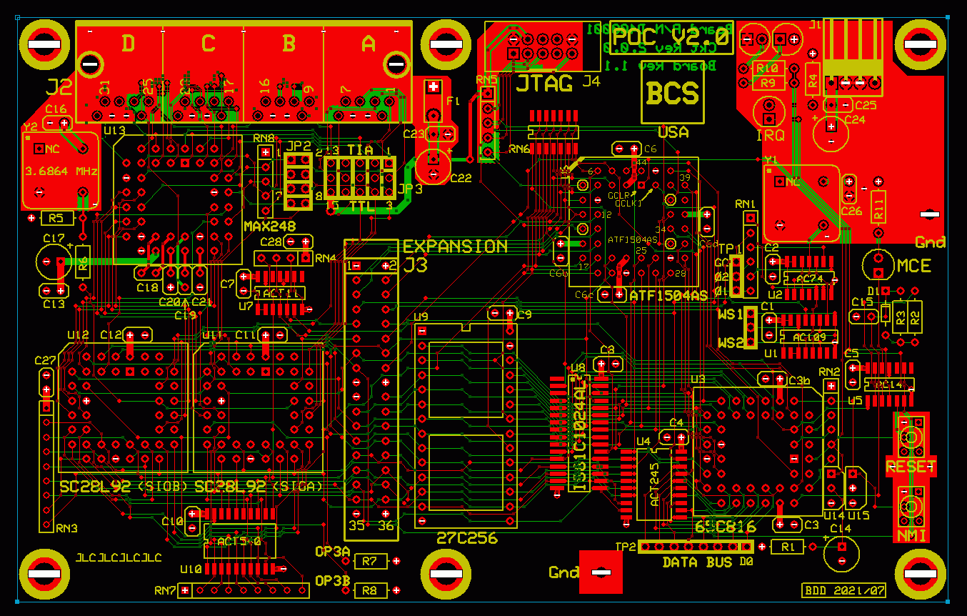

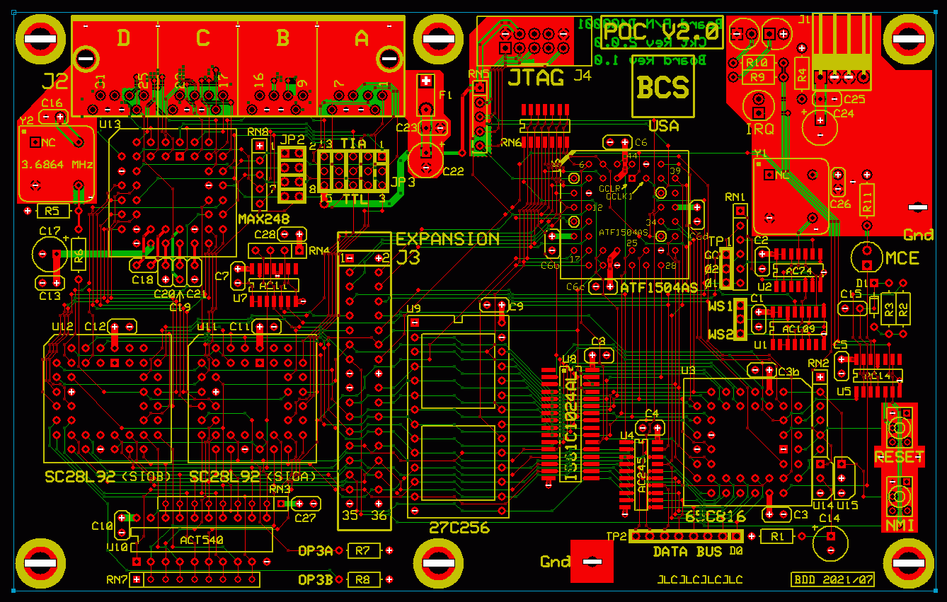

Woo-Hoo! PCBs in shortly then...
Got the ship notice from the board house yesterday. Now it's up to the courier...
Meanwhile, I've been fooling around with the CPLD code. I decided to go ahead and make I/O decoding more granular, which exposes more RAM between the top of the I/O block and the bottom of ROM. This version also has the ability to switch out ROM and expose the RAM underneath it. When ROM is in, a write to a ROM address will bleed through to RAM.
It all simulates as expected...which doesn't guarantee that it will actually work. :shock:

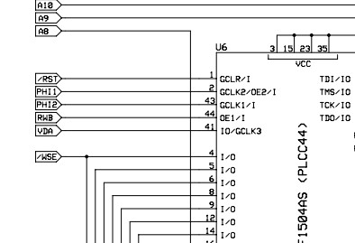

Has something changed in the clocking ?
The schematic has PHI1 to PIN 2 and PHI2 on PIN 43
Schematic snip
Schematic snip
Screenshot 2021-08-16 184558.jpg (23.92 KiB) Viewed 1998 times
The CUPL seems to have them the other way around:
pin  43                   = PHI1;          /* input   system clock (phase 1) */
pin   2                   = PHI2;          /* input   system clock (phase 2) */
You, sir, are commended for your powers of observation. :D :D :D
I changed that around after I had posted the schematic and board layout. The CUPL code is correct.

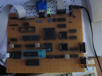

Well..... I have a reason for following along the design closely:
POC2 and a bit
POC2 and a bit
The lower 2/3 of the board is basically the POC2, the upper third has all the I/O from a recent Z180 build. Left to right Wiz810s Ethernet header, 82C55 & IDE header, 2 chip VGA Video solution, and dumb keyboard port.

Well, I received the stencil, but no sign of the PCBs. They were supposed to show up Friday.
The PCBs arrived on Monday, and as I was preparing to get the SMT stuff soldered in place, I discovered a major boo-boo in the layout. :oops: The board is electrically correct but the footprint I used for the 'AC245 transceiver was wrong. It has the right number of lands but is the wrong package width. Below is the incorrect PCB layout. The mistake is with U4, which is located at the southwest corner of the 65C816 socket.
V2.0 PCB w/Wrong Component Footprint
I thought it might be possible to scab the transceiver in place by reforming the leads, but that won't fly due to the part being too wide relative to the layout footprint, as well as being jammed up close to the 65C816's socket.
Having discovered this little contretemps, my only recourse was to fix the board layout and place another order with JLCPCB. Below is the repaired layout. Since I was forced to a do-over, I made some other layout changes as well. Let's see if any of you who read this can spot those changes.
V2.0 PCB w/Right Component Footprint
Supposedly, I'll have the new PCBs and stencil on Thursday. It really tees me off when I make a boneheaded blunder like that. :evil:
Oh, what the hell: it's only money! :twisted:
