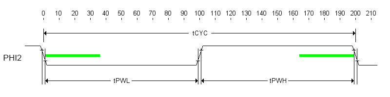

in the meantime, what about the duty cycle of the clock? could it be adjusted to either side to allow for even faster stable Clock Speeds?

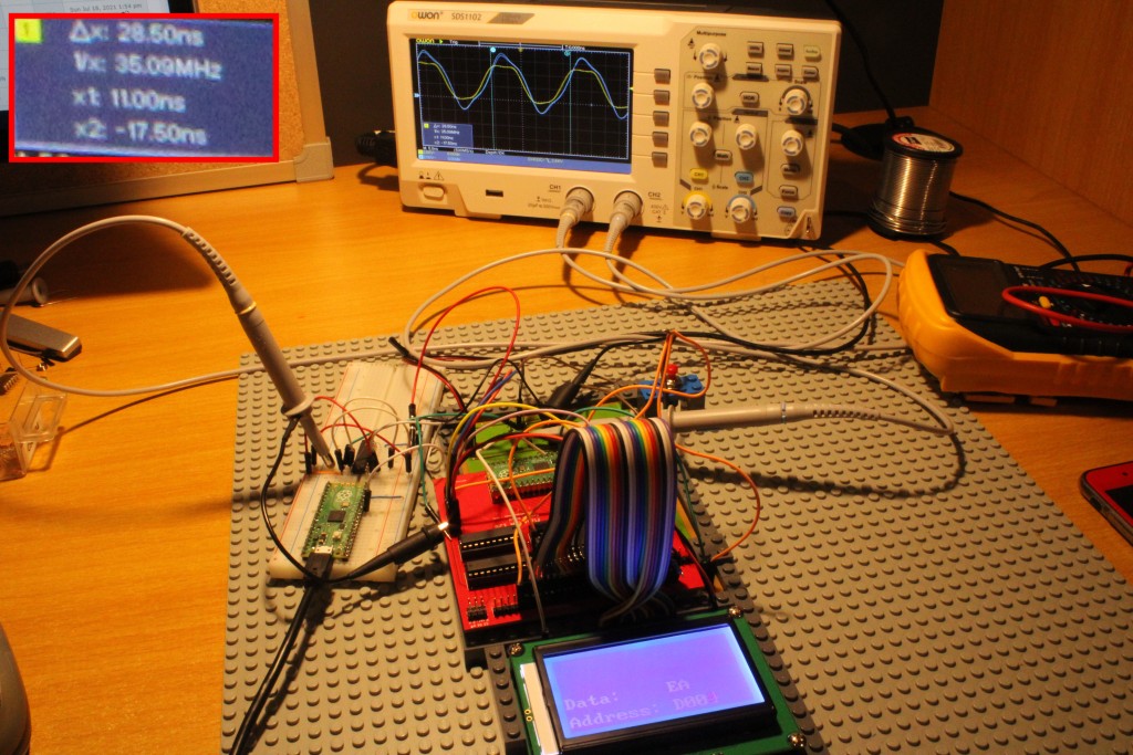

Still 5V and still running stable as I write this post. Clock is still being fed from a Raspberry Pi Pico, but now being passed through a 74ACT245 (instead of the 74HC04 that I was using previously).

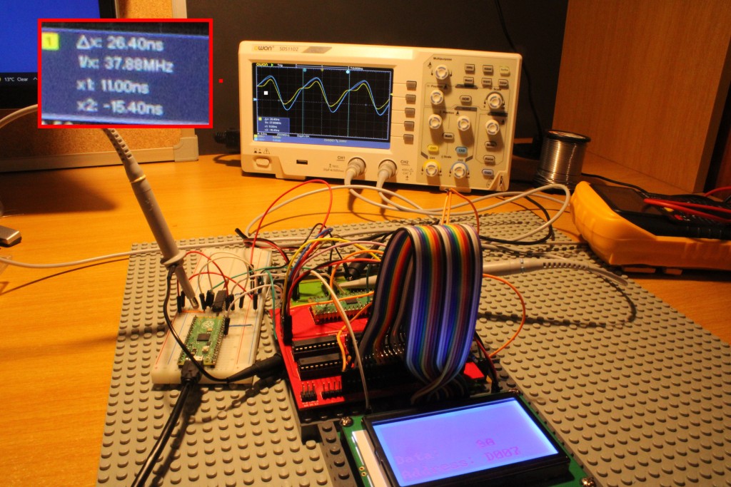

Just shy of 38 MHz at 5V! Getting unstable though, barely have to move to make it crash.
Will look at moving the clock buffer IC on to a very small stripboard over the weekend, so I can get the signal as close as I can to the W65C02. At ~40MHz the waveform is looking pretty nasty over that distance.
BTW and FWIW, clock timing (including duty cycle) is discussed in my Visual Guide to 65xx CPU Timing.

Just a reminder that your scope will to some extent limit what you're able to view, and things may not be quite as bad as they seem. For example, if we optimistically assume that the 40 MHz waveform is truly a square wave, then the "corners" of the wave will appear rounded, even on a scope whose bandwidth is hundreds of MHz.
The 'scope would need at least a 400 MHz bandwidth to display a reasonable facsimile of a square wave at 40 MHz. Naturally, the probe would have to be capable of the same bandwidth when running on the ×10 setting.

Sounds as though the 245 has improved the quality of the clock signal. Shame you don't have access to a 400 MHz scope. It would be interesting to have a look at Ø2.
