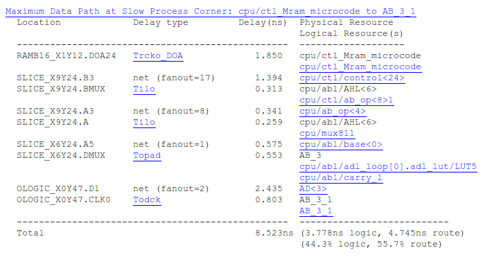

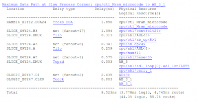

I've converted part of the ABL module into instantiated LUTs, because that was the longest path, and I saw an opportunity for improvement, especially around this code:
always @(*)
    case( op[1:0] )
        2'b00: {CO, ADL} = base + 00  + CI;
        2'b01: {CO, ADL} = 9'hx;
        2'b10: {CO, ADL} = base + ABL + CI;
        2'b11: {CO, ADL} = base + REG + CI;
    endcase
Synthesis produced 16 LUTs, even though it can be done in 8. This is what manual instantiation looks like:
generate for (i = 0; i < 8; i = i + 1 )
begin : adl_loop
LUT6_2 #(.INIT(64'h665aaaaa88a00000)) adl_lut(
    .O6(P[i]),
    .O5(G[i]),
    .I0(base[i]),
    .I1(REG[i]),
    .I2(ABL[i]),
    .I3(op[0]),
    .I4(op[1]),
    .I5(1'b1) );
end
endgenerate
This creates 8 LUTs, with two outputs: carry propagate (P), and carry generate (G). The LUTs have 6 inputs, but since you need 2 outputs for the carry chain, the LUT is divided into a pair of LUT5. The function of the LUT is defined by the hex INIT string, which is a 64 bit string for the truth table. These signals then go into CARRY4 instances that represent the carry chain.
Making the truth table can be done by isolating a module, putting it in a test wrapper that cycles through all possible signals, and prints out the hex string. Then you can just copy & paste that in your own code.
CARRY4 carry_l ( .CO(COL), .O(ADL[3:0]), .CI(CI),     .CYINIT(1'b0), .DI(G[3:0]), .S(P[3:0]) );
CARRY4 carry_h ( .CO(COH), .O(ADL[7:4]), .CI(COL[3]), .CYINIT(1'b0), .DI(G[7:4]), .S(P[7:4]) );
With these improvements, the total slice count is down to 49. I'm sure there's more that can be saved. The longest path is only a few logic levels, but I notice there's a lot of routing delay (more than half). The biggest delay is to the AB output pad. This means that if you want the fastest possible design, you also have to keep in mind which I/O pins you use, and make sure that related pins are close together, so that the logic can be mapped next to the pads.

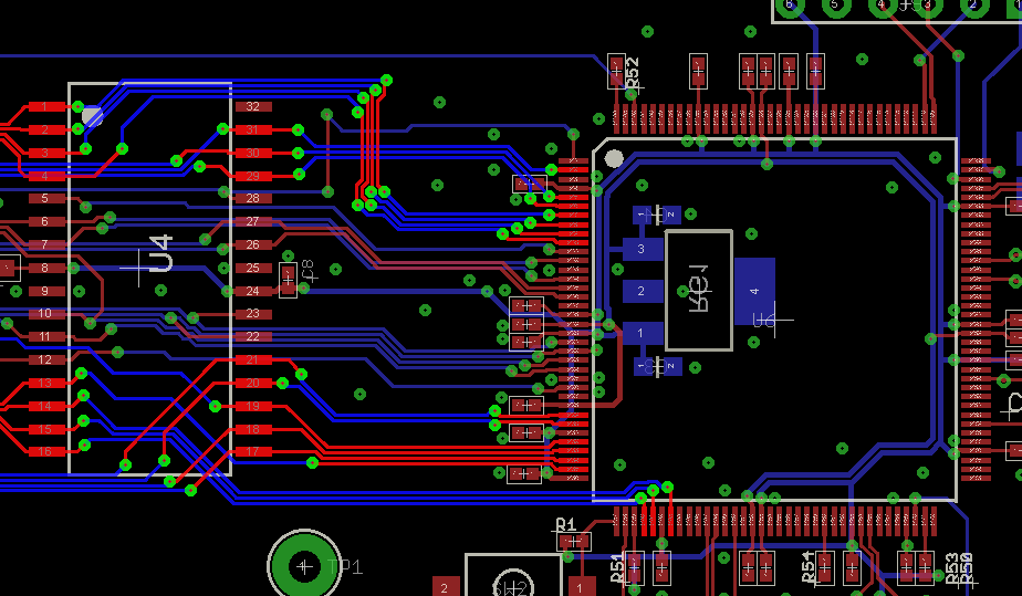

Arlet wrote:
In my board, I just mapped the pins where it was convenient for board layout.
I can see the reason now. I've highlighted the AB* pins in my board. Some are near the top of the FPGA, and some are at the bottom. This means that there's no good place for the logic to sit close to both.
Of course, when you're running at >100 MHz, you can't address the external bus that fast anyway. If you need to run fast, you can use the internal block RAMs for code, and add 1 or 2 wait states for external access, and then add a pipeline stage to the AB outputs. The problem was that I had configured my core for internal block RAM, but still had the AB connected (but not the Data Bus).
When I add a pipeline stage to external AB signals, I can get fmax to 150 MHz.

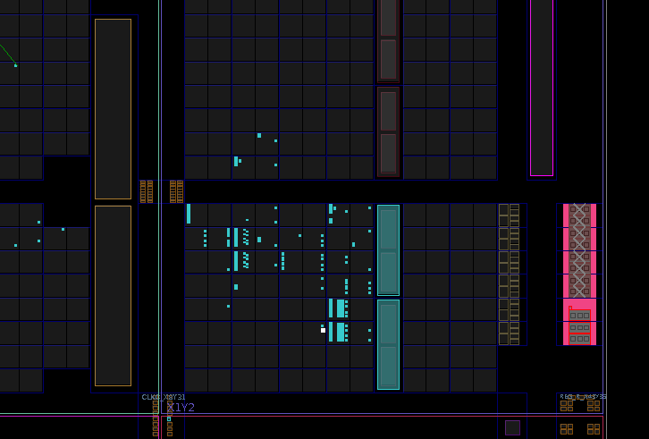

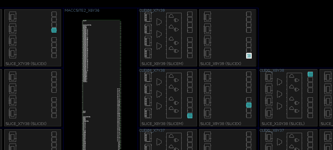

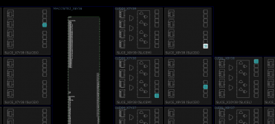

Here's a screenshot of the floorplan. You can see the two block RAMs next to each other, one for the bootrom, and the other for the microcode.
The light blue elements are used for the design, but they appear rather scattered, so I would think there's plenty of room for improvements. For some bizarre reason, there are a handful of flip-flops placed even further away, with no logic nearby.
