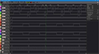

after over a month I come here with another problem :) A lot lot lot of debugging with very little free time .....
In my design I have a 8k window in the 64kByte address space to map in the VGA memory or future memory expansions. That worked as expected when using 2kByte HT6116-70ns SRAM. But when I used IS61C5128 in the same environment - with 8 address bits set to 0 - something strange happened. Sometimes writes would modify 2 or more addresses with the same value. I think I finally figured out the reason for that - take a look at this capture from the logic analyzer.
The addresses change before CE and RW lines go high. I guess the fast RAM just has enough margin to write additional cells before CE/RW go high.
I have an idea how to solve that - put in a buffer on the address lines (2 74xx574 chips) instead of the 245 I need anyway and trigger them on the rising clock pulse.
Any better ideas?

Try qualifying R/W with PHI2 to derive a /WE signal for RAM, like this:
Other signals going to RAM usually trail the fall of PHI2 by some margin and will therefore hold steady while /WE is low. That should prevent other addresses from being modified by the write.

Drass posted while I was searching for any way you might have to keep RAM from being written to when phase 2 is low. I did not find any. From the address-decoding page of the 6502 primer, about 70% of the way down the page: "You must have a way to make sure RAM cannot be written when Φ2 is low! Looking at the 6502's timing diagrams in the data sheet, you will see that the address lines are not guaranteed to be valid and stable before the R/W goes low; so it is possible to write to unintended addresses."

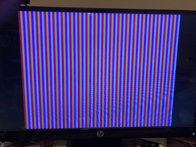

so that was a long break, but when COVID hits your son's daycare suddenly all free time evaporates. At least no one in my family got sick :)
Last report was on write problems to the DIMM. I could solve that issue by converting to CPU R/W line into a 20ns pulse, so that writes happen only during a short period of the complete 6502 write cycle. That solved all issues, and I could program the memory to generate all SYNC signals correctly. Unfortunately .... when I hooked up to the monitor it would not synchronize. The reason was simple. The monitor did not recognize the 640x400 resolution I had programmed, but tried instead to go to 720x400.
At that point my plan to be able to switch between various resolutions vaporized. Looks like modern LCD monitors are not truly multisync, but have a number of fixed frequencies programmed in. I have to stick to standard VGA, and with that in mind using a programmable memory did not make sense anymore. So I decided to do SYNC generation with 2 more GALs and 2 74LS00:

Nice result! It's a good point that the many many LCDs out there have different degrees of flexibility and tolerance. At least you found a way to drive what you have. If at some point you can try with various monitors you might find you need to make some tweaks.
I think the later VGA devices have an I2C facility so the video system can read off what the VGA device is capable of. That's a job for a program, of course, but the hardware would need to be able to do I2C reads. I think bit-banging can do that. But this is probably well out of scope!

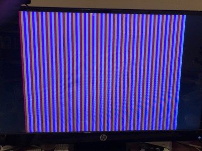

You and other forumites may find it interesting to study this proposed circuit, which requires fewer chips and no programmable logic (only EEPROM's). :)
Replacing the power supply with a battery and the error was gone
Congratulations on identifying the problem! And you'll be glad to know there are other solutions besides batteries. Probably your symptom results from a ground loop which can be resolved my reconfiguring the connections between the project, the power supply and the monitor. Have you shared any photos of the project (in another thread, perhaps)?
If I use a different power supply the problem also disappears. Unfortunately the other power supply is too weak for operation of the whole circuit so the result was dimm and full of instabilities. That's why I tested with strong batteries. My guess - either I will need to put in some large capacitors or use a different power supply.
By any chance does this different power supply have an AC line cord that's only 2-prong? Whereas the supply that shows interference on screen has 3-prong? If so, the interference may result from a ground loop (assuming the monitor also uses 3-prong).
Otherwise I'd scope the supply's DC output to see if any ripple is present. This interference problem can be solved. Batteries are not the only solution!

both power supplies are 2 pronged and connecting from the same strip. Using an Oszi is on the todo list - as well as trying some big capacitors. You are absolutely right - batteries are not the solution. That was only a quick way to see if the power supply was the problem :)

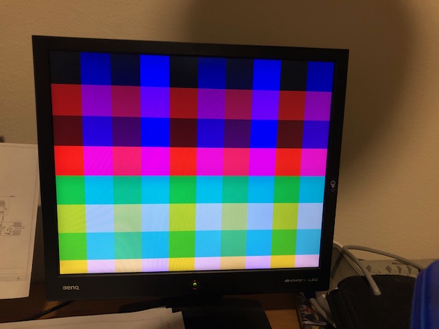

Oszi shows some strange dips of about 0.5V on all signals in line with the image. Putting 470uF capacitors on all small breadboards improved situation, but problem is still noticeable.
After a few changes to the firmware I could generate images out of the Video Ram.

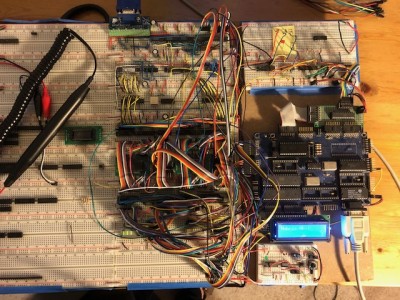

Posted: Thu Apr 08, 2021 4:19 am
by ThePhysicist
Quick update
it liiiiiiiives ......
The board is a little bit messy though .....

so next step - I want to add one more feature. A direct connection between both video rams to allow a direct copy of the data in a single frame. If that works out, I'll call it "rev 1 done" and will produce a PCB for it.
