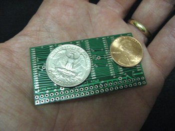

by GARTHWILSON
Were you aware of the 4Mx8 10ns 5V hobbyist-friendly SRAM modules I offer?  See the front page of my site (linked below).  People have been surprised when they saw how small it was.  Here's a bare board in my hand:
When fully loaded, there are four 512Kx8 SRAMs on each side, and there's a 46-pin header.  There are three header options.  I can supply sockets too, soldertail or wire-wrap.
I just offer these as a service to pormote our common interest.  I have a legitimate business to make sure I don't break any tax laws, but it's not a money-maker.
Re: 65c816 address decoding help
Posted: Thu Apr 02, 2020 1:42 am
by Skylie33
I see! I was not aware of these. Thank you for letting me know.
