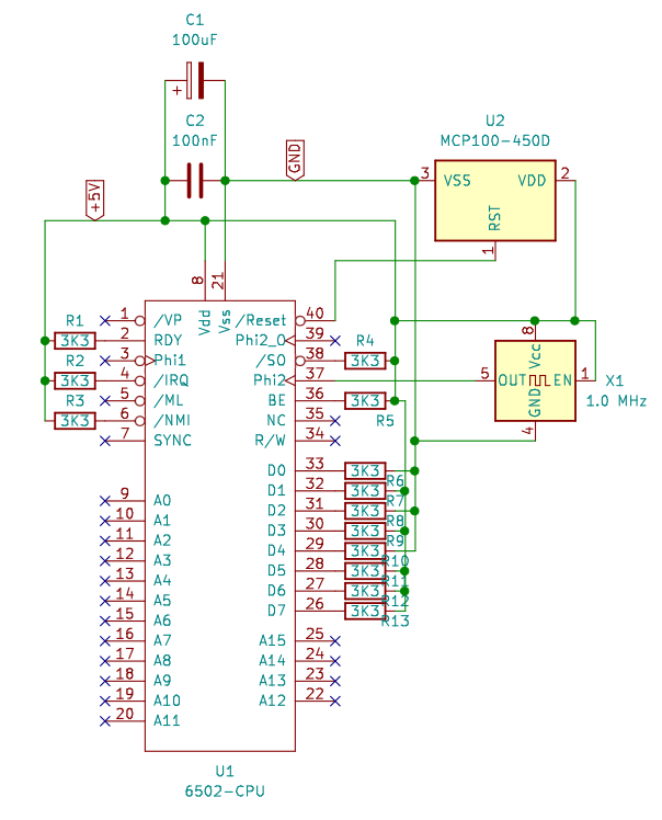

The attached schematic should work fine as a NOP generator for either a 6502 or an '816. You should see an approximately 8 Hz square wave (more precisely, 7.629 Hz) on A15, and successively higher frequencies on the lower-numbered pins.
Aside from the CPU itself, I've employed a 1MHz crystal oscillator can, a 4.5V power supervisor chip as a reset generator, and some ordinary passive components. Make sure the 100nF bypass capacitor is connected directly to both the CPU and the oscillator. If that's difficult, use two of them, one on the CPU and one on the oscillator.
Can't read it with all that color.

Just for you, here's a monochrome version. We really do need to find you a black-and-white accessibility switch for your computer.
Thanks. I will try it. It is very similar to the circuit I used to test plain 6502s. I didn't use reset controller, just pulled RST pin high with 3.3k resistor. Was it a bad idea? Could it produce different result of a NOP test somehow?
This probably explains why your CPUs appear flaky when tested. The 6502 requires /RST to be pulled low for several clock cycles after the power supply reaches a valid and stable voltage, then released. The MCP100 supervisor chip does that using a 350ms sequencing between a VCC threshold (4.5V minimum is correct for NMOS, works also for CMOS) and the /RST output. One of the non-obvious things this initialises is the microinstruction sequencing logic, which at least on the NMOS 6502 can lock up if it gets into an invalid state (eg. an $x2 illegal opcode).
Well, I can certainly verify that when I was testing my batch (which included both NMOS and CMOS parts), as often as not they would not start correctly until I had pulled reset low for a bit. I did this just by very briefly—perhaps half a second—shorting the reset line to ground using a jumper wire on my breadboard. (I don't recall what value of pullup I used, but it was probably around 3.3k or 4.7k.)
Ok. I will try testing them after adding reset controller, if only I will be able to find spare one.
During my previous tests I tried to manually reset some of this CPUs, by briefly grounding RST with jumper wire. They still weren't generating proper RST signals after that. But maybe there will be at least few more which will work.
This still doesn't explain why none of that chips (even those generating valid signals on breadboard) doesn't want to work with my computer. And yes - there is reset controller present in my design.
UPDATE: It turns out it wasn't because of lacking reset controller. I added DS1813 to my breadboard test circuit. CPUs that weren't working before still doesn't work. There is still slight possibility that some of them are different version, requiring different wiring but I don't think so. That leaves mi with six that passed NOP test, but still my computer won't work with them. Any idea why?

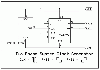

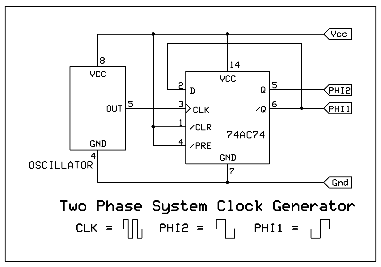

I don't have any colorblindness, but I do like schematics to be black lines on a white background.
You mean, like this? :D
Two-Phase Clock Generator
BTW, another reason to post schematics in monochrome is the resulting files can be smaller, which conserves server space.
