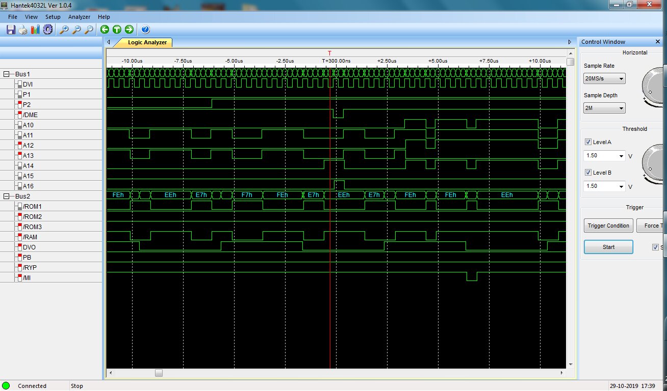

Today I took some samples from the ADEC ic. At the top left is shown the signals I'm looking at and bottom left the outputs. I put A16 as an input by mistake. A16 is clearly related to /DME, just inverted. Present also are /ROM, /RAM, DVO, MI. I don't think this is just an address decoder. The 2nd picture shows activity on the P2 line.
The signals on ADECsignals1-1.jpg just repeat in the loop. The was no activity on /ROM2 or /ROM3. Please feel free with suggestions on the next step.
In the boot file it is clear that there are lots of WR's but from the on I havn't found a single other WR. If I check the ADEC picture you can clearly see that /RAM is frequently selected but it's only a RD cycle.
Re: M50734 code
If that's the endless loop, then it feels like the master CPU IC1 reads a Byte from the IC4 MI-1 at $1800..$1BFF, and it doesn't like the result.
To me, this indicates that either something could be wrong with the SPI communication to the other boards,
or that something could be wrong with the communication with the IC2 slave CPU (HD63B01).
In the HS-5 schematics, IC2 pin 21 is labeled /IS, and IC2 pin 22 is labeled /OS.
In the HD63B01 manual, PDF page 565 (546), there is a description for how /IS and /OS are supposed to work for the HD63B01Y0.
//To me, the manual looks like only the HD63B01Y0 has that /IS and /OS feature. It seems to be missing for the HD63B01V1 and HD63B01X0.
If the master CPU does a read/write to the slave CPU, /IS is supposed to go low.
The slave CPU is supposed to acknowledge the falling edge at /IS after some time by generating a spike at /OS.
After power on, the master CPU probably wants to initialize the slave CPU at some point, so check for spikes at /OS.
IC4 MI-1 uses pin 31..37 for talking with microcontrollers on the boards: UK, LK, PK20L. Try to see, if there is activity.

IC2 pin 21 marked /IS is LO and there is no activity.
IC2 pin 22 marked /OS is HI and there is no activity.
IC4 MI-1 pins 31 to 37 all are non active and are HI excepting pin 34 which is LO but non active.
IC4 MI-1 pins 38 to 41 all non active.

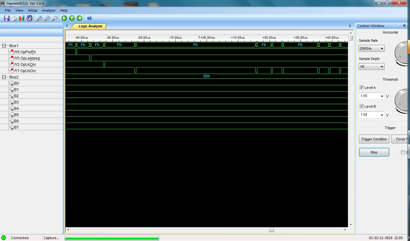

Interesting yesterday looking at IC28 the 40H138 3-8 line decoder used after the slave processor. The first trace shows the outputs from the chip select lines /Y1, 2, 5, 6. Looks pretty much as you might expect. The second trace, in which nothing was changed except for being turned off and then back on for a new trace, shows a completely different pattern where three of the outputs are low at the same time. I have now seen this a couple of times and wonder how this is possible.
