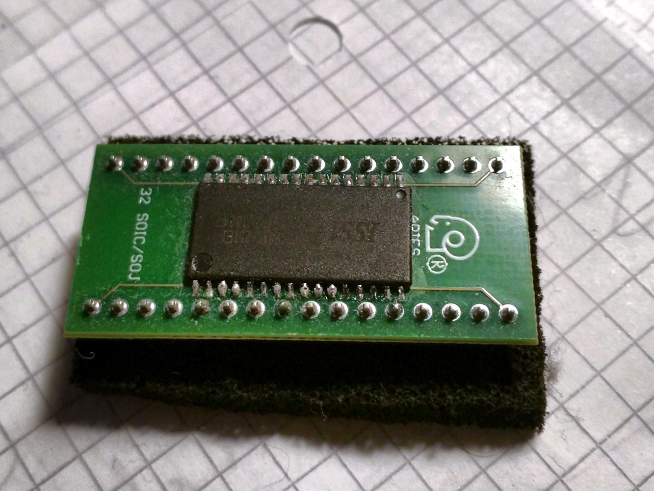

The other thing I've done recently it put TSOP2 chips on a DIL carrier which was wasn't hard to do with my usual temp. controlled soldering iron:
thats a 256KB RAM chip, but I think the principle is sound if you want to keep the PCB a much DIL as possible.
(And yes, the 'quality' of my soldering there is somewhat suspect, but it's works just fine - I just used ordinary multicore solder there as I'd run out of liquid flux, also if doing this, try to get carriers that aren't pre-made with the pins already soldered in - that made it somewhat tricky to get the part on)
