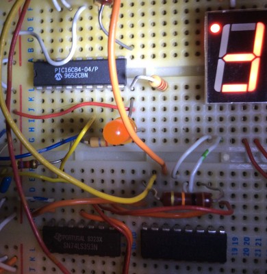

Posted: Wed Nov 21, 2018 12:39 am
by 1024MAK
Who says old school logic only runs at 5V?
A PIC16C84-04/P microcontroller supplying counting pulses to a SN74LS393 counter, which in turn is supplying binary data to a MC14495P display driver. This then is driving a red seven segment display. The whole lot is being powered from two AA cells, the current battery voltage is 2.93V as shown on the cheap multimeter ;-)
The MC14495P and the common cathode red seven segment display were obtained from China via eBay.
PIC16C84-04/P
PIC16C84-04/P
SN74LS393 and MC14495P
Video here https://youtu.be/bU-ObHCvj34
