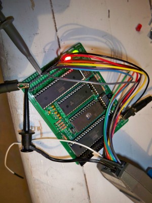

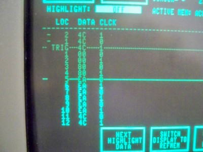

The boards came in and I'm very pleased with the quality. Thankfully they put the customer ID under the crystal oscillator can. I didn't have time to make a proper program, but I wanted to verify that it was reading the EPROM properly. In the picture it's just running a loop that sends it back to $8000 every time it reaches $8003.
What I would do different:
-Install a ZIF socket for the ROM. I wanted to do this originally but I forgot about it later on.
-Use fewer IC's. Next time I'll use only on 74XX device instead of two.
Thank you everybody who contributed!

So far so good (except the buttons and the jumper that selects the CPU being wired wrong)
Although I'm struggling to get the 6522 to work. I don't know what I'm doing and it's obvious....
I'm trying to write to port B. I writing to the internal register 0000 and probing the outputs, but everything is high. I don't get a single line that is low.
What am I doing wrong? The program just loads $#01 into the accumulator and then stores it at address $6000.
