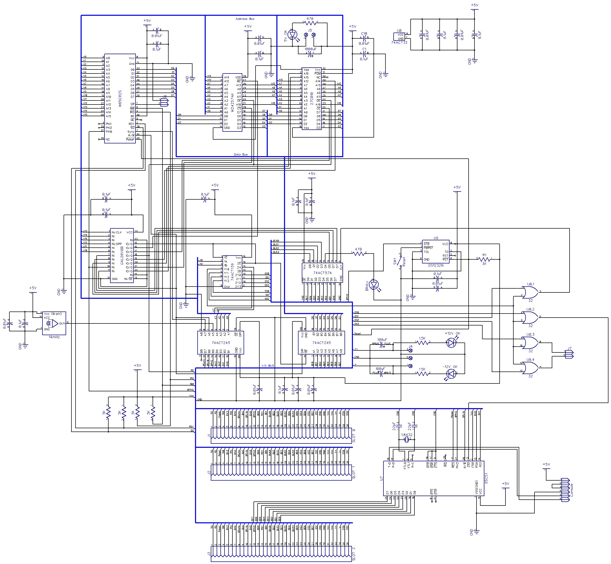

I have had a bit of a windfall today. My big meeting was cancelled. This allowed me to make the changes I detailed above and it works. This is comforting as my analysis for the RAM timing sowed that should not have been a problem, and moving to an access mode with /OE toggled low during the write cycle (inverted R/W) would even improve the timing by completely eliminating any possibility of data bus contention with a W65C02. Now all devices use the same PHI2 so it seems the problem as I had originally was that the buffered PHI2 going to the 65C51 followed the one going to the CPU by ~6nS. It does not seem like it would matter much, and it doesn't to the NMOS chips or the R65C02, but it apparently matters a lot to the WDC chip.
I could still do the timing traces on Sunday if anyone is really interested, but as this configuration 'makes sense' (it should work and does) I am pretty comfortable with it.
The attached schematic represents the current configuration.

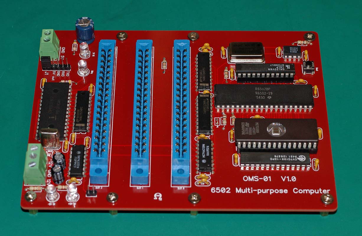

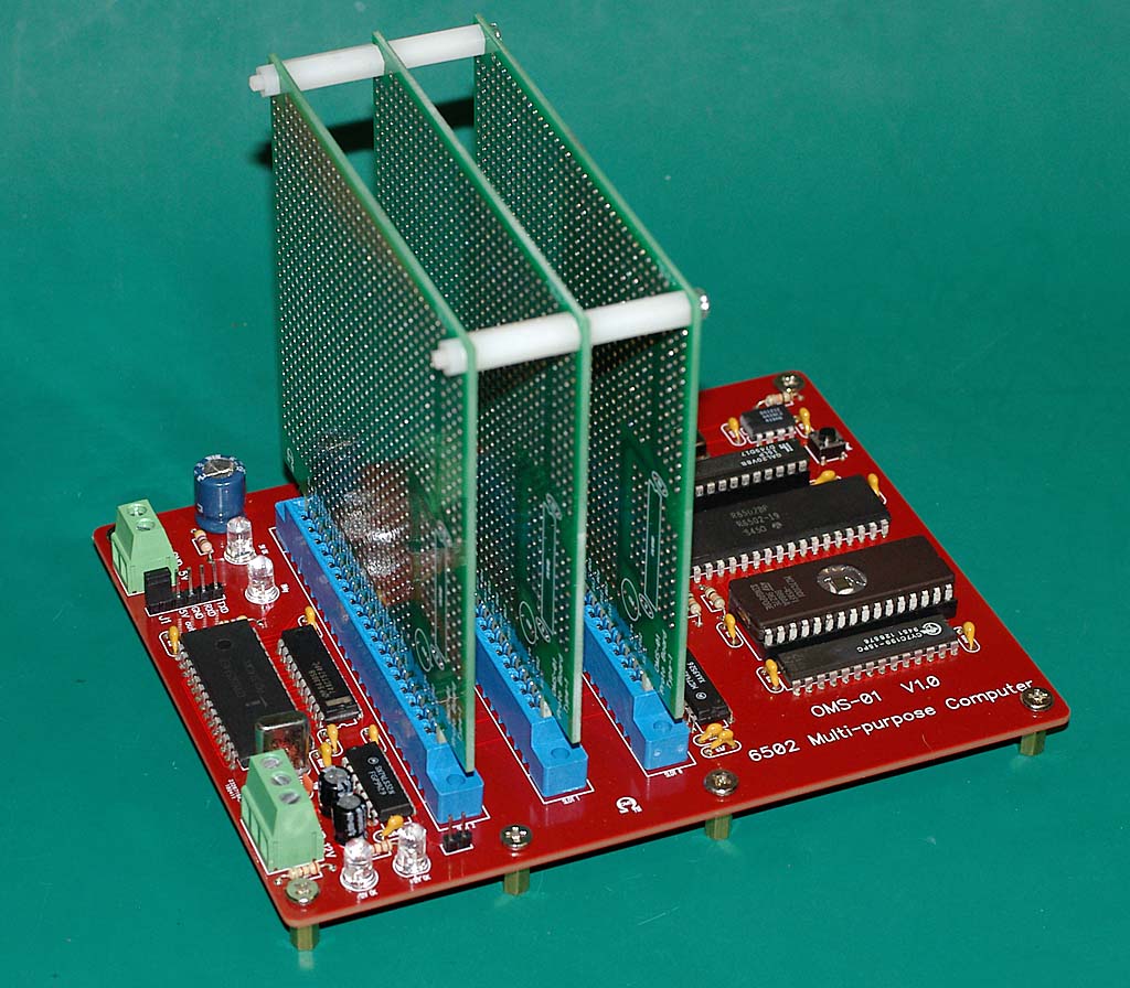

Just in case anyone is interested in what this looks like, I'm attaching a couple of photos. I'll do a little write up (and another project) at some later point. Perhaps when I get new boards made up. It's so cheap these days.
The one pictured uses a Rockwell NMOS 6502B and is running nicely at 4mHz.

Nice board layout! Glad you have everything working. It looks like you have an Intersil sourced 65C51 ACIA on the board. I also one of these rated for 4MHz. Mine is a NOS part, but I tend to get intermittent glitches on it once in a while, so I put a Rockwell CMOS part in and all is fine. Just saying in case you find some odd things with the console.
Any plans for the I/O boards yet?

You are using Phi0 on all 65x02 and gate /WE with BPhi2 = Phi0. So the lag between Phi0 and Phi2 (out of the CPUs) isn't that much that writes into RAM are affected? Even at 14 MHz? I would appreciate some timing traces (Phi0 / Phi2 / DBx / nWE) perhaps at different supply levels ( 4.5 / 5.0 / 5.5 V ) if you have the time :)
BillO
Sorry, that's an old IC model I'm using so the label says Phi0 (Phi-zero) for pin 37 rather than PHI2I . If you look, there is nothing connected to pin 39 and pin 37 is fed from BPHI2. The oscillator feeds into the '245 then comes out as BPHI2 which then goes to the CPU, the GAL and the 65C51. Everything is now dancing the same dance.
Thanks.
Yes, that's an Intersil 65C51. It's just like the one on the W65C02 test board that is now running as stable as a rock at 15.5mHz as I write this. I'm not sure what the rating on it is. The part number is CDP65C51AE2. Edit: Looks like that is only a 2mHz part - wonder why it's running at 15.5mHz?
Lots of plans for I/O boards. ADC, DAC, stepper controller, hardware PWM generator, dual W65C22S, I2C, relays, MOSFETs, Graphical and character LCDs, etc...
I'll build up prototypes on those generic boards I have to get the interfacing right, then do up multi-device PCB boards so that I can mix and match as required. The way I have it set up there can be up to 4 8-bit devices per slot with nothing more than a 74xxx32 to select between them. Or a GAL can be used for more complex stuff or go beyond the 4 devices.
Yes, correct. The timing charts of WDCs 6502 are referenced to Phi2 (in). I'm used to the NMOS charts where Phi2 (out) is referenced. But there is no information about the delay between Phi zero in to Phi 2 out, except for an old Commodore datasheet where they say its 5 ns. And 5 ns wouldn't matter anyway.
