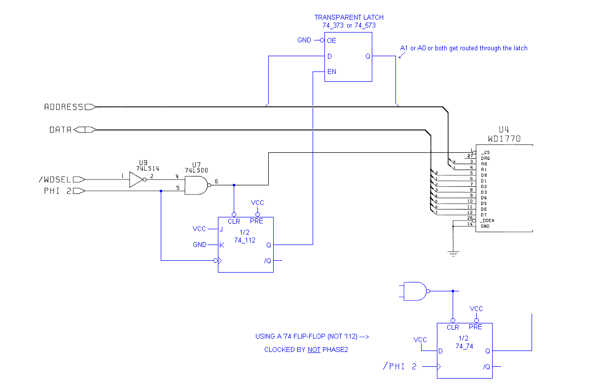

Looking at it, I think Jeff's has the right though. The address
decoder in the chip is slow and allows glitches to get through.
The 11 address seems to be sensitive to getting such a glitch.

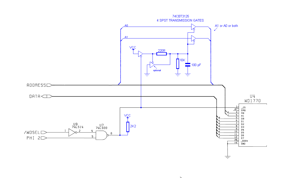

Are you game to try a little hardware hack, floobydust? The macro is a software workaround for the flaky FDC chip, but a hardware workaround is also possible. Just make it so the A1, A0 signals avoid the 11 address for about 500 ns after the status register has been read and Chip Select goes false. It's plain that the macro does ensure A1, A0 won't equal 11 in the cycle after the SR access, but it's not proven that that's why the macro is effective. (The macro also affects the address seen before the SR access.) By removing the macro and using hardware to target only the cycle after the SR access I believe the question can be laid to rest.
I doodled around and came up with a 2-chip solution and a 1-chip solution to keep A1/A0 stable longer and thus avoid the 11 address. Dunno what parts you happen to have on hand, but either of these -- or a hybrid -- could be made to work. Kinduva fun experiment, if you're up for it!

Dunno if you have one handy, but it would be interesting to replace the 6502 in your 1581 with a 65C02. The thought had occurred to me that the way the 6502 behaves with some instructions, doing a double write in some cases, may have something to do with the macro and its need.
Still, you could easily be correct that it's what follows the SR read that creates the anomaly.
Here's a more thorough presentation of the possible address sequences. I've been reminded that only accesses to the Status Register seem to require the macro, and I've noted that. The five cycles listed for each sequence are: the ROM access to read the LDA opcode; the ROM access to read the LS operand byte; the ROM access to read the MS operand byte; the FDC access to read the specified register ; and the ROM access to fetch the opcode of the following instruction.
- 00 is the address of wdstat, the Status Register. The following A1 and A0 values can be present during & after execution of a LDA wdstat instruction (depending on where in memory the instruction is stored):

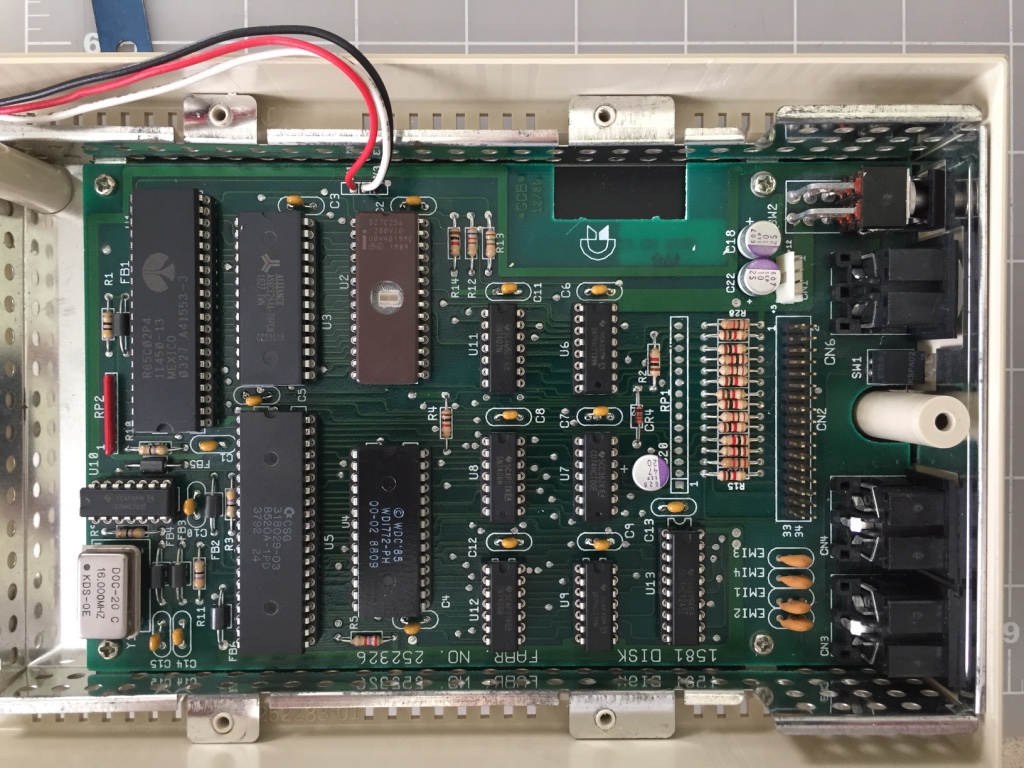

An update from my end:
1- Still can't walk right... knee, ugh.
2- Mouser order received - yay!
3- Entire 1581 PCB has been socketed (including Can Osc) and all new caps installed as well
4- Replaced all logic chips with 74HCT series
5- Rockwell R65C02P4 installed, Intel 27C256 EPROM, Alliance 8KB RAM
6- Only original chips reused were the WD1772 and CSG 8520A
Burn-in completed, everything works as expected. Attaching a pic of the PCB completed (also defluxed the board). With a working drive again, I can now do some additional tests on the code side. I'm also attaching a 3rd party datasheet for the WD1772. There are some specific timing requirements in polled-I/O mode per the datasheet. In some cases, these are not implemented in the 1581 code. In other cases, timing delays between register writes and reads are followed (as in 20 NOPs in a row). At least I'm in a better position to do some testing and changes and the only risk is popping the 8520 or 1772.

Socketing... I cheat a bit. For the 74LS logic chips, I just snip the leads at the chip itself, then use the iron to melt and lift each one out, then a solder bulb to clean them out. Pretty quick overall. I did the same for the RAM chip as these are cheap as well. The EPROM was socketed, but I put a better one it's place (matches the rest of the new ones). Of course, salvaging the CPU, CIA and FDC were important, so these took the majority of the time.
The 1581s I have use a Chinon FB-354 drive. I also have a few of the Teac FD-235HF/HG drives, but depending on some of the submodels, some of the line functions change. There are some tiny zero-ohm SMTs that can be removed/installed to change some of those options however. I am thinking it should be feasible to swap out to one of the Teac drives, but it may require a slight wiring change at the connector.
I'm using the stock Commodore power supply... but I'm thinking of using a single 5-volt regulated Condor switching supply once I opt on a Teac drive swap. Overall, the drive is running cooler as all of the chips, sans the CIA and FDC are now CMOS. Time to start making some code changes to see if anything changes with the 65C02.
