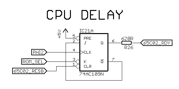

Re: Dual port ram
KhanTyranitar wrote:
....So my next major hurdles are: to either buffer or slow down for SID and ROM access. If I use faster ROMs, I won't need to worry about them. I may go with some type of flash memory for the ROMs as well, I'm not sure yet, just considering the option. If I can get the ROM figured out, then that leaves me with the SID chips. I plan to set it up for dual SIDS. Since the SID uses $d400-d7ff (a whole K) then is there a way I can trigger the CPU to slow down to 1 MHz when any address in that range is accessed? Or am I thinking about this the wrong way?
You can delay the CPU when needed using a simple but elegant JK flip-flop circuit which has been posted somewhere on these forums (I'll try and dig it out). If memory serves, the circuit uses 3 inputs: PHI2 (the main clock), the active low device enable pin (ROM select, VIC select, etc.) and (optionally) the CPU reset pin. The output is to the RDY on the CPU.
Here's a version of it, but please note that I did not design this (kudos lies elsewhere) and it's done from memory so I've hopefully remembered it correctly!
Re: Dual port ram
The original discussion (and a version for TWO wait states) are here.
cheers,
- BigDumbDinosaur

Re: Dual port ram
The 680 ohm resistor should be replaced with a small signal Schottky diode, with the anode connect to RDY on the MPU. Otherwise, that should work.
That said, Jeff published a more elegant circuit, which he mentions above.

I also don't understand the benefit of using a diode as suggested. Am I missing something? (Edit: Hmmm... It does let the MPU pull its own RDY pin low, as happens following a WAI instruction, without drawing excessive current from the Q output of the flip-flop. But so would the resistor -- that's why it was put there.)
Going the other way, when Q is low, as it would be for a wait-state, the low forward drop of the Schottky will guarantee that RDY will be pulled close to Q's voltage. Assuming use of a 74AC74 flop and an SD103 Schottky, RDY will be sunk to about 0.4 volts when Q is low, well below VIL max.
Re: Dual port ram
Yes, but weren't you going to tell us why you consider a diode superior to a resistor? The diode has two drawbacks I can think of (though they're not actual show-stoppers).
The best choice may be "none of the above." In the other thread I duly note Garth's suggestion of a capacitor (shunted by a resistor). And in the other thread is probably where this discussion belongs -- not here, as we're kinda straying from the dual-port RAM topic!

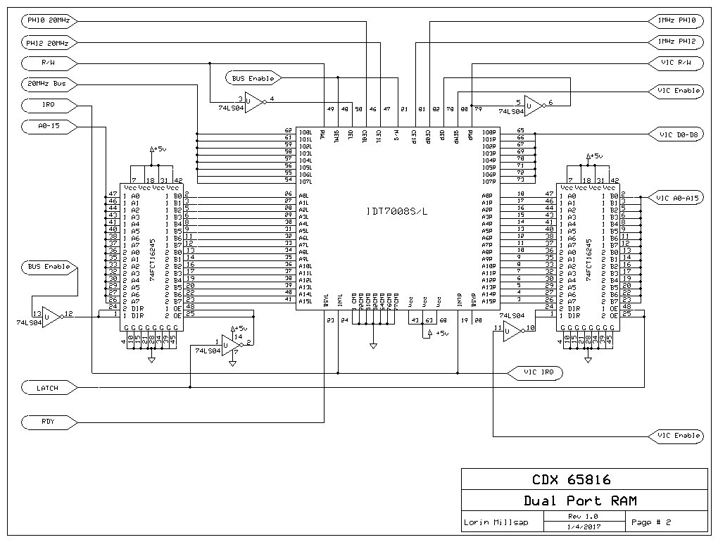

KhanTyranitar
- Posts: 81
- Joined: 21 Dec 2016
Re: Dual port ram
Ok, here is the schematic I have so far. It probably has some newb mistakes. It is obviously not the entire board, just the interface to the DP RAM, and the LATCH trigger (which is another circuit as well).
