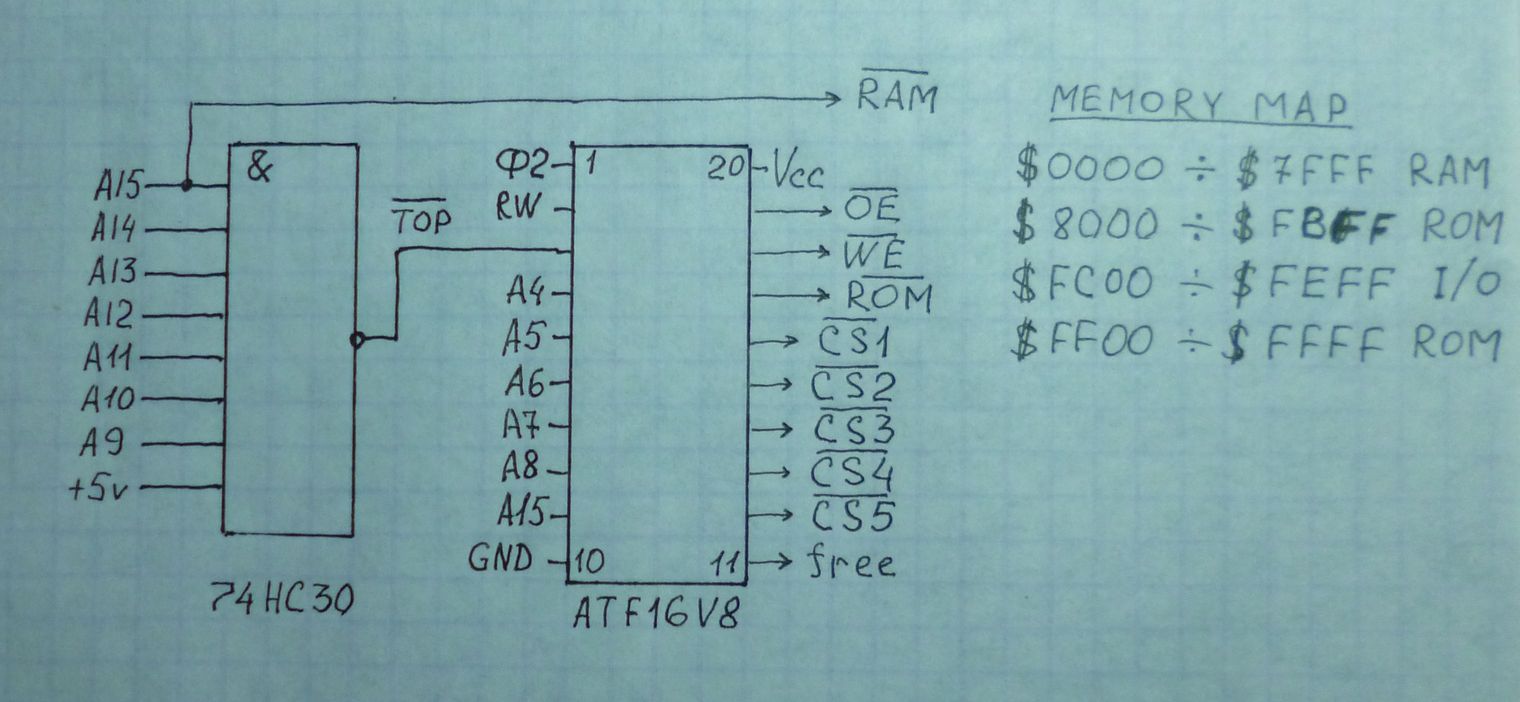

Creating an address decoder on PLD 16V8 (or 22V10, not matter), the biggest problem, IMHO, is a lack of PLD inputs. One of possible solutions you can see on the picture below.
How to divide the I/O address space among the CS-outputs is up to you (and up to your PLD-program). The slight increase of [A9..15] propagaton time in 74HC00, IMHO, does not matter, the address information have nearly a half of clock cycle to get in time. In a pinch there is 74AHC30. What do you think, guys, about all this?

That 74HC30 is a slow device. Perhaps a better choice might be a 74ACT11030, which is some 15 times faster than the 74HC30.
Your need to add external logic to the GAL to make up with insufficient inputs illustrates why these devices have largely disappeared from the scene. In comparison, the Atmel ATF1504AS, which is the smallest CPLD that Atmel produces, has 32 uncommitted I/O pins, as well as considerably greater logic resources. Plus it's in a package that doesn't take up any more space than the NAND gate and GAL combined.

The other option is to chain 2 PLD's, a 2nd ATF device would also have a much better response than HC logic.

Looking at your diagram, I don't think you have the right address lines going in to the ATV16V8 to implement the address map you proposed.
You could move up to a 22V10 which would give you another 4 inputs.
But I think you can achieve you goal with just a 16V8.
It's possible in a 16V8 to use the Clock (pin 1) and OE (pin 11) and normal inputs, as long you you don't need to use any registers. In the data sheet this is referred to as "Complex Mode".
You would need to adjust your memory map slightly, and loose a few pages of ROM:
0000-7FFF RAM
8000-F9FF ROM
FA00-FAFF I/O CS1
FB00-FBFF I/O CS2
FC00-FCFF I/O CS3
FD00-FDFF I/O CS4
FE00-FEFF I/O CS5
FF00-FFFF ROM
The pinout would then look like:
Clock (Pin1)
RnW (Pin 2)
A15..A8 (Pins 3..9, 11)
nCS5 (Pin 12)
nCS4 (Pin 13)
nCS3 (Pin 14)
nCS2 (Pin 15)
nCS1 (Pin 16)
nROM (Pin 17)
nWE (Pin 18)
nOE (Pin 19)

Hi Dave.
My design allows (if it is needed) flexible variations of I/O space size allocated to each of CS-outputs. For example, CS1 has 256 bytes, but CS2-CS5 16 bytes for each one. Unallocated space remains for possible expansion or relocation in the future.
How important is the accuracy of decoding - I do not know. Perhaps for programming convenience. If no one needs this , then, maybe, your circuit is better.

H Vladimir,
I don't think it's actually possible to implement the address map you proposed with the address lines you have going into the GAL.
Have you actually tried to write the logic equations yet?
At the very least, I think you need to move A9 from the 74LS30 to the spare input of the GAL.
Dave
Dave
Yes Dave. It is my fault, A9 really must enter into PLD, but not into 74HC30.
Equations may look like this:
ROM = A15 & !(TOP & !A9) & !(TOP & A9 & !A8)
CS1 = TOP & A9 & !A8 /* Page FE entirely, for example */
CS2 = TOP & !A9 & A8 & !A7 & !A6 & !A5 & !A4 /* 16 bytes from page FD, more precisely $FD00 ÷ $FD0F */
CS3 = TOP & !A9 & A8 & !A7 & !A6 & !A5 & A4 /* $FD10 ÷ $FD1F */
and so on... CS-outputs looks as active-high, but in pin-definitions they are defined as active-low, so that all will be well.
Really, I would have to write the equations before the scheme.
Additional chip (74HC30) only required for accurate decoding (for each register personal address). Let someone tell me wether such a need (accurate decoding) exists...

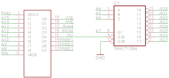

Hi Vladimir,
I think for a simple system a ATF16V8 is perfectly right. Of course it lacks PINs. But for a simple system this is not really the problem. The 74HC30 is a slow device, but for a 1MHz or 2MHz system this device is fast enough. Worst case delay is 26ns at 4.5V. This is fast in a 2MHz system. Your SPLDs have 15ns so this will give a total of 40ns worst-case. Your CPU is a 10MHz version so all signals will be settled well before the rising edge of PHI2. Nothing to worry about. However I suggest you use another decoder scheme, with the GAL16V8 being the primary decoder and using a 74HCT138 as a secondary decoder, although slightly slower (30ns versus 26ns) it gives you some additional free PINs on the GAL for future expansion and the mapping of ROM, RAM and IO Page only depends on the GAL and not on a fixed logic device (74HC30). You can also use the 74ACT138, which has only about 10ns delay. This decoding scheme has some advantages in case you want to change the mapping.
Simple Decoder
Simple Decoder
Peter

Hi Vladimir,
the logical diagram is not necessarily what is electrically implemented and the delay of internal stages is much less then for stages with outputs. So in fact the 138 has only one internal logic stage more than a 30.
As for your RAM, the 24257 is a CMOS device and its outputs are high enough to interface with the CPU. I and others use all sorts of static CMOS RAM and did not have any issues. The RAM achieve normally an output well over 0.7VDD, potentially not at the guaranteed access time, but the additional delay is very small. Just go on and use your RAM
Peter
