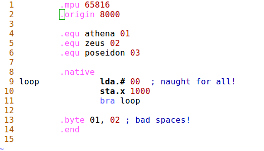

by scotws
So the basic formatter was quicker to write than expected. Even better, my secret hope has been realized: It seems to be good enough that you don't have to give a damn about indentation while typing, but can just let the machine take care of it afterwards (yes, I'm really that lazy). At the moment, we can go from
.mpu 65816
.origin 8000
.equ athena 01
.equ zeus 02
.equ poseidon 03
.native
loop lda.# 00 ; naught for all!
sta.x 1000
bra loop
.byte 01,    02 ; bad spaces!
.end
to
        .mpu 65816
        .origin 8000
        .equ athena 01
        .equ zeus 02
        .equ poseidon 03
        .native
                sta.x 1000
                bra loop
        .end
automatically. Of course, that's not what it looks like in vim, because of the Tinkerer's Assembler plugin:
What is still missing (apart from some edge cases I've probably overlooked) is the block formatting for .equ and .byte directives. So by the time I'm done, the Greek gods should look like this:
        .equ athena   01
        .equ zeus     02
        .equ poseidon 03
But that's enough for today.
