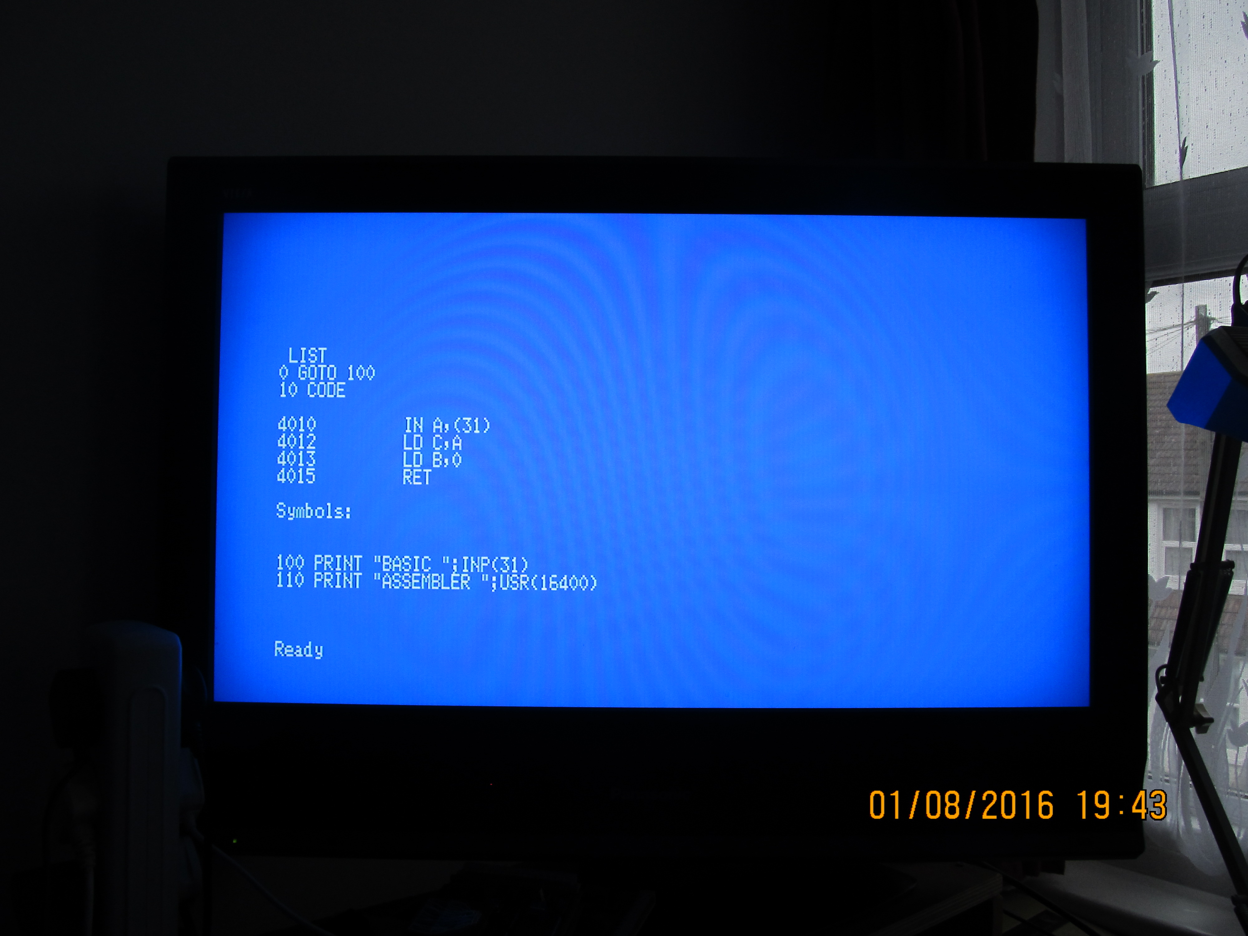

That looks very cool; you'll have to let everyone know how you get on. I'm especially keen to hear what kind of picture you get from the CXA1645. I tried various approaches to get a decent picture from the V9958, including a AD724 (PDF), but finally gave up and just went for a trani amp, the same one used in the MSX2. This was a shame because I really wanted a composite or SVideo output so I could attach my computer to a TV capture card - it seems finding a capture card that takes RGB video is almost impossible.
Take a look at Dave Stevenson's MTX+ board.
http://www.primrosebank.net/computers/m ... design.htm
He uses the CXA1645 too. Perhaps he can provide some insights or pics?
Have you tried running the RGB video into one of the new "SCART to HDMI" adapters, then feeding that into an HDMI recorder (those designed for recording people playing video games)?

I've got the "other" MTXplus prototype system, enclosed a high res photo of the display on a 1280 x 720 LCD TV.
The VDP/CXA1645 is outputting an NTSC signal to the TV via SCART
The fringing is a camera artefact, as there is banding on the display though maybe not quite as evident as it is with the 9929A in the original MTX.
