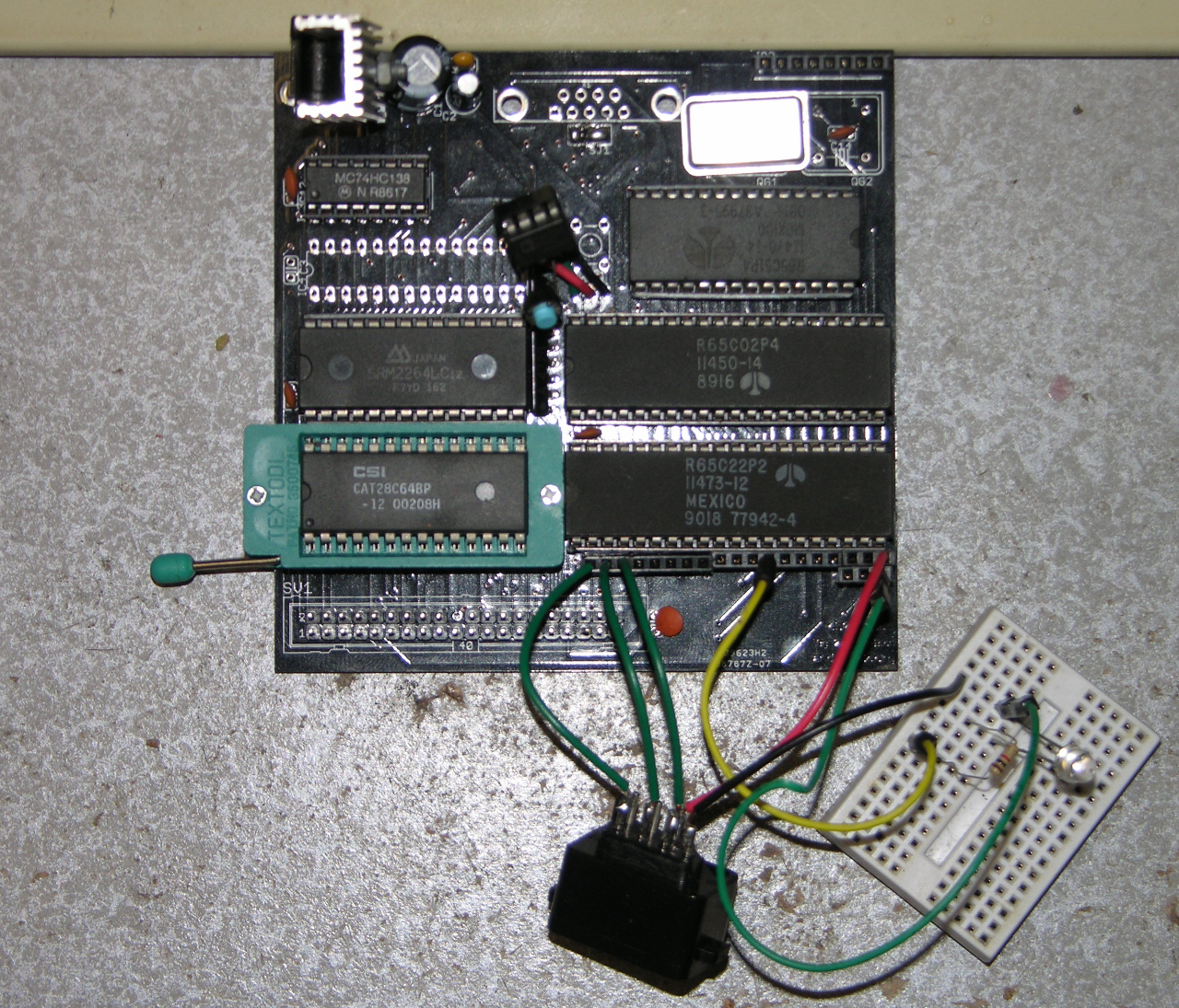

Picture is attached. It has some ugly kludges in place: full can osc wedged in, old reset DIP floating in place of ds1813, oversized regulator heat sink, UART crystal on underside and a wrong sized resistor SIP.

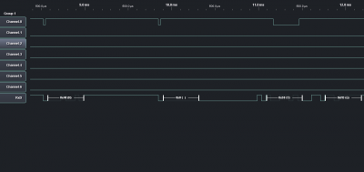

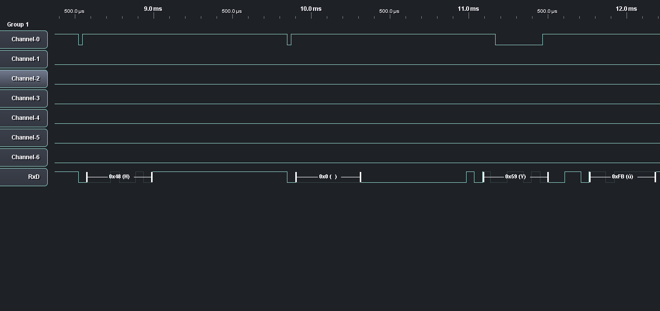

Re: First SBC design, need a second set of eyes
I've attached a picture of the analyzer's output. I tweaked the code so PORTB is high during the delay function and low while waiting on the UART. This is shown on Channel-0.
As you can see, the output sticks low, the UART spins a bit, soon reports it's ready for another character and then garbles the output. It seems to fail in the same way each time.
I'm not sure how to force tx low even if I wanted it. What's going on here? Is something wrong with the handhaking pins? DSR, DCD and CTS are all grounded.

I don't understand what is going on here. You don't have stop bits at the end of each frame. The start bit is low, then there's the data (lsb first), then the stop bit should be high; but you have bytes ending with a low after the msb. The $48 ("H") is followed by an invalid frame, then the next character would be $65 ("e") and the following frame looks like it's trying to be that, but lacking the falling edge of the start bit. If you look at these with an oscilloscope, are they really such clean 1's and 0's, or are they wandering around the no-man's land between valid logic states? Is there any possibility something else is trying to drive the line at the same time?

You are right on the money, Garth. We have some kind of AC problem, not logic.
As a shot in the dark I put a 4.7K pull-up on the line. Now it works perfectly. That being said, I have no idea why that works. Nothing is wired to TXD beside a passive header and a non-populated inverter footprint. Nothing should be fighting for that line.
I don't know what to make of it. Can the TXD line not drive any kind of load?
I'll put my scope on it and edit this post with the results.
Edit: Just before the falling edge on TXD it swings ~1vpp at 500kHz. I guess a division of the 1MHz system clock is being picked up. I probably shouldn't have placed the osc and the UART so close together.
I've already littered that part of the board with bypass caps. What are my options now?
The CMOS output should have a stronger, wider-swinging output than the old NMOS ones did.

Skidlz:
I noticed that delay, but I was stuck on having a high-speed core, so loop times not calculated correctly in my head.
I too am a bit confused by the logic analyzer trace you posted.
Have you checked that the pins, particularly VSS and VDD, of the 65C51 ACIA are not bent under and not making good contact? I've had that happen with the type of socket you appear to be using, and it's difficult to spot.
If I remember correctly, you have a low speed logic analyzer, but is it possible to measure the XTALO and RCLK pins of your ACIA with it? It would be good to know if the oscillator signal is good enough for the ACIA.
From the picture of your SBC posted earlier, I would also check that the screw/bolt of your regulator heatsink is not in contact with the case of your large electrolytic capacitor. I would expect that both the regulator tab and the cap's case are ground (because this is a case of positive linear regulation), but I'd ensure that they are not touching as a precaution since I'm not intimately familiar with all of the circuits that you are using.
I don't expect that you have a power problem, but one common problem that I've encountered is that I get some thermally induced power supply noise when I operate linear regulators at a high enough current draw to require a heatsink. It's an easy oversight, so have you checked that your linear regulator is not supplying so much current that its output is not stable due to thermal issues? If you can't lower the input voltage, you may try dumping some power by installing a series power resistor on your input voltage line.
I can't see on your board photo where you've placed the single gate 'HC1G04s you use as drivers for your TxD and RxD signals. Have you checked/inspected/reflowed their power and ground solder joints recently?
On the schematic that you posted earlier, on what node(s) are you connecting your logic analyzer on?
Just curious, but what is that device in the black package near the bottom of your board photo that looks like it has a DB-9 pin out to fit the unpopulated connector spot on your board?
As far as I can tell, the chip is seated properly. No pins are bent, missing etc. I'm away from my desk at the moment, but I'll double check later.
My analyzer has very little sample memory, so I ran it slower. At faster speeds it shows the osc running at 1.8432MHz.
The regulator and caps are in very close proximity(probably not the best design on my part), but are not touching.
I don't think the heat sink is strictly necessary. I put it on because my broken VIA chip put a huge load on it and made it hot.
The 'HC1G04s are routed on the underside and are not populated.
I'm probing the MicroVGA header and the PORTB header.
I think you are referring to the NES controller connector at the bottom. It was just part of an IO test.
I would post a capture from my scope, but I think it's too old for windows to support it. Measured without load, TXD's logic high is around 4v but noise on the edges brings it as low as 3v.
EDIT: Inexplicably it now works perfectly. Maybe something wasn't seated quite right, no clue.
EDIT II: And now it doesn't work again. I'm so confused.
Here's a development that makes even less sense: Removing the VIA exacerbates the problem. The line is stuck low more frequently and for longer. Once the VIA is reinserted, it improves significantly. The code is in no way reliant on the VIA; It is written to but never read.
I think I'm just gonna buy another 65c51 and see what it does.
