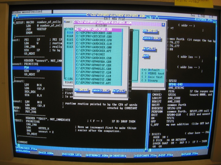

I had 15 files loaded, 9 of them minimized (showing at the bottom), 2 on top, and 3 behind them, then I used the mouse to pull down the "file" menu, clicked on "load new file," then clicked on the down arrow for history. I could move the menu windows around with the mouse too. Just in the menu boxes, I see 33 things to click on. (There would be more if one box were not partly hiding the one behind it.) No graphics.

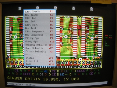

The only graphics in my PCB CAD are the ones you draw. Its interface is mouse-powered but menu items are shown in text. You can point and click, although I usually use the shortcut keys and skip the menus.
Some here will recognize this as my 4Mx8 SRAM board. I clicked on a hot point at the top of the screen to pull down one of five menus.

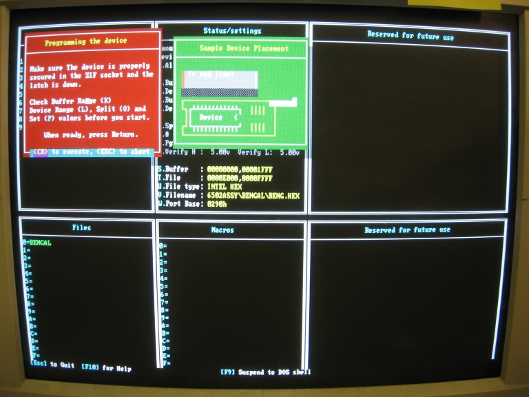

Besides point-and-click selection, the (E)EPROM programmer software also uses the special characters to form a picture showing how to put the EPROM in the socket:
