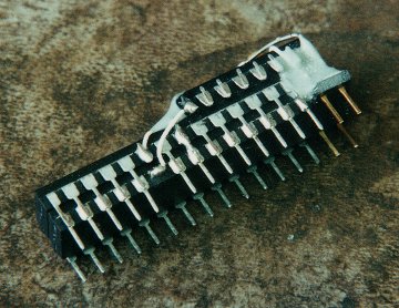

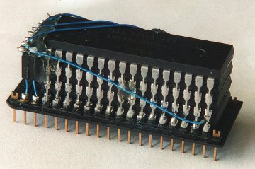

It's still do-able, assuming SOJ packages. You straighten out the pins so they go down over the pins of the SRAM IC below them to be soldered. I'll try to post a picture later.
This is my first effort at a 4Mx8 SRAM module to plug into a single 40-pin DIP socket. It worked, but was a huge amount of labor. It's 8 512Kx8 SRAMs in SOJ-36, plus a 74ABT138 mounted dead-bug style (or was it 74AC— I can't remember) stacked on an Aries SOJ-to-DIP adapter. The copper foil was to reduce the ground connection inductance especially to the upper SRAMs.
The bump you see partway down the side is a chip capacitor for bypass from Vcc to ground. As you can see, the J leads are straightened out and soldered to the IC below. Heat is not a problem since only one IC is enabled at a time, and not more than about half the time with a 65816 system.
What I finally did as you know was to make a PCB with four ICs on each side. This is less work, cheaper, and takes less room on the host PC board:
Power supply bypass capacitors are actually embedded in the PCB, directly under the die of each IC. I can provide these to anyone who wants one. It's on my website.

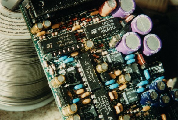

That's not practical for production though. The maximum density I've gotten with production thru-hole, in analog circuitry where you have a lot of resistors, diodes, and capacitors, as an across-the-board average (IOW, big parts pulling the average down), was 45 parts per square inch. What I used to do for our aircraft intercom products was to put up to 11 resistors and diodes staggered in five rows underneath each 14-pin DIP. For the bigger DIP sockets (.6" wide), you can of course put one or more narrower DIPs inside the socket, under the DIP that plugs into it. The board below is the main board for a product that had about 500 parts in a box the size of a large bar of soap.
It had a couple of boards that plugged into the top, with the parts facing each other but the tall parts missing each other, so it fit like a glove. Laying that out in the CAD was interesting. I made a reverse copy of the plug-in boards and drew the outlines of the parts that stuck up different heights, and put it over the main board as a guide as to where I could put different heights of parts so they wouldn't interfere. This was back when I used a 16MHz '286 with 1MB of RAM. Worked great.
