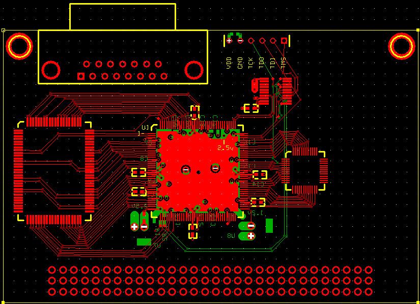

Super slow at work today, so I got around to general placement of the main IC's: RAM, FPGA, and video DAC. FPGA Proms/JTAG still need attention. But I'm already about half way done I would say. Came out very nice and tight first time around. Looks like there'll be enough space for all IC's to be on top of the board. So far 33 pins to spare on the FPGA.
Earlier I had wanted for the Master board to be able to peer into the video ram and this could've been done with another CPLD to MUX the address and data buses, but it also would have added close to 10ns delay, which for high speed video could not be tolerated. And thus I have a big honkin connector. Originally I had wanted the connector to be standard on all boards, but I am rethinking this.
I must come up with a system of communication from an outside controlling board to this board. I'm thinking of some simple X, Y 16-bit registers and a command register for plotting pixels, shapes, etc.

Anyone know how difficult it would be to mix or overlay 2 or more VGA images, either digitally or after the DACs?. Same resolutions and HSYNC VSYNC.
Difficult to find info. I'm currently looking for ICs that may perform this function.
EDIT: To do it digitally, is it as simple as XORing the RGB digital before the DACs?

Thinking about it more, it's probably not a good idea to do it digitally as there will be a delay affect as each board is cascaded. I need something like a summation of each board's R,G and B after the DAC. I wonder if a simple resistor divider network will work?

Resistor divider won't work either. If one board had a blue propeller spinning clockwise and another board had a red propeller spinning counter-clockwise, where the propellers intersected would be purple, which is not going to work. I need a layer type of organization with a priority for each board. May be too difficult. Will have to think about it further...
My idea would've worked for a monochrome system though.

I think digital is best, especially as you have a whole FPGA to play with.
You can always delay the local strea to match the remote stream as you cascade things.

Yes, I think you're right. We can use notation in Verilog to set a delay. I've never played around with this and don't know how precise it is, but it can't hurt to try. Plus there might be some neat effects from the delay during experimentation... I wonder what the bottleneck will be for the number of boards running in "parallel"? or is it serial?
Quickly running out of pins on the FPGA. 24 more for RGB in, leaves just 8.
So now the 96-pin main header begins to fill up:
16 pins for databus
24 pins for RGB in
24 pins for RGB out
64 pins used + some extraneous clock/control signals.
Now I must rearrange how the RAM is connected to the FPGA to make room for RGB in.
The verilog delay notation is not synthesizable. In hardware, you can delay a signal by using flip-flops, fifo, or shift registers by a whole number of clock cycles.
That's good to know. I thought I had read somewhere, that FPGAs have delay taps. I had thought Verilog was taking advantage of this. In any case we also have the PLLs which can phase shift a common pixel clock/phase 2 by 45degrees. UD382, pg.101, also mentions other phase shift values are possible. Also, since I am aiming at a 100MHz clock I should probably start out with a 200MHz clock and divide it down inside each FPGA to reduce jitter.
My plans today are to refresh my memory with UG393, I/O pin planning, and make progress with finalizing the layout quickly in order to determine how many pins I'll have for control communications. Unfortunately, I'm thinking that it's going to be serial with the lack of necessary pins for any kind of parallel.

Mixing digital VGA images should be fairly simple if you cascade the boards, and make sure you supply the pixel clock with the RGB signal.

No promises but with so much space left on the back of the board I am looking into adding HDMI 1.4 with a 100-pin QFP ADV7511. The video portion looks easy, although the I2C control signals may have to come from offboard, maybe the future soundboard since HDMI makes provisions for I2S audio. There's room for these signals on the main connector. More research is necessary...
