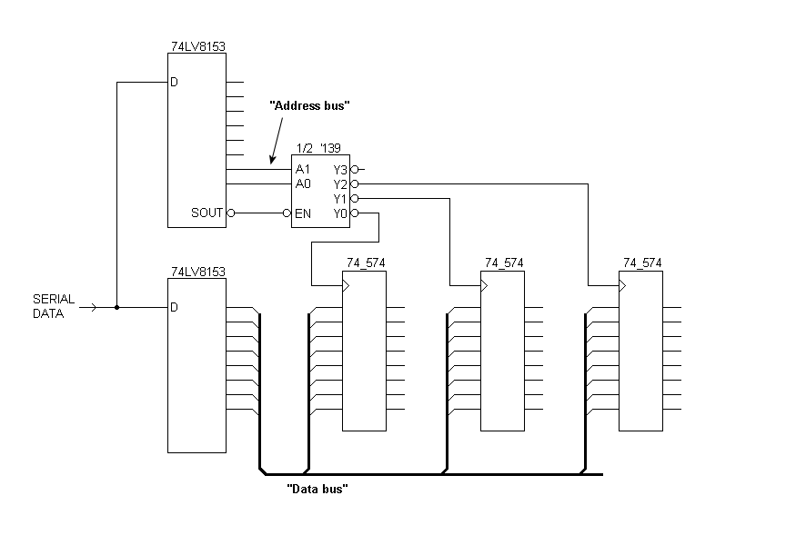

Here's a rough rendition of one possible version of the bus scheme I mentioned. Such an approach won't often be needed, but the potential scope is very broad.
For a 6-bit data bus, use 74_174 in place of '574, and eliminate the upper '8153
