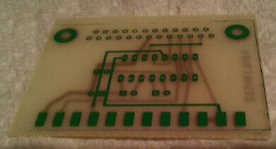

Here is the first board I made with the PCB Fab in a Box process.
It's not pretty, but it's far better than anything I did previously. Ones I made since then were much nicer.
