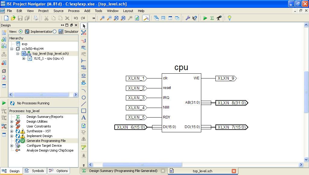

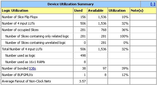

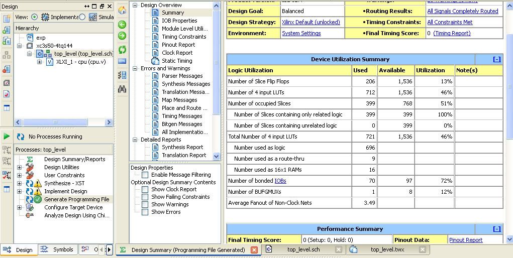

Ok, now I've got a few hours to spare and have downloaded the files, and put them through ISE synth (I'm sure you guys have too). I tried first to fit the 65ORG16 core into the smallest FPGA Xilinx has to offer that can hold RAM & ROM, i.e. the smallest of the Spartan 3 series, the XC3S50 in 100-pin QFP. It did not fit, I think only because it didn't have enough pins. However, it did fit into the XC3S50 144-pin QFP package and here are the passing synthesis results for the core only:
Also, here is the pinout:
I'll tell you what, a while ago I would've considered the MC68000 for a true 16-bit CPU... This 65ORG16 is now on my top shelf for experimentation when it comes to a cpu with a true 16-bit databus...

Here's the synthesis results for Arlet's 8-bit original just for comparison...
If I were going to maximize the 144-pin package, I would use the Spartan 3 XC3S400 or the Spartan 6 XC6SLX9.
