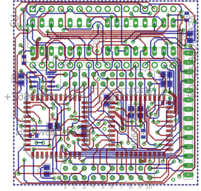

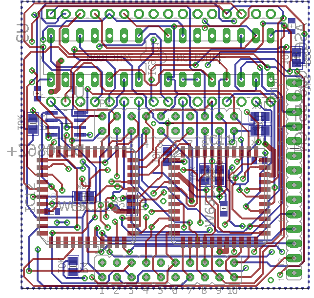

Well, I know that in many instances it take less or more than 5 cycles per shared memory fetch. That is were the BE line comes into existence to hold off the 6502 core to prevent conflict. It will give delays, but one can either design (optimise) or forget about it (=runs any code, but slower). I am not saying 5 is a magic number and some kind of statistics might provide a better basis for choosing a divider (e.g. 1/5th clock cycle access time, 1/4th and so on..).
Edit: A simple analysis for a case were each 6502 accessed the shared bus 1/5th of the cycles gave 1 cycle delay in 20% of the time with two 6502, 36% of the time with three 6502 and around 50% of the time with four 6502. It means that each 6502 requires 5.5cycles (in average) for a shared SRAM access. By using CLK2 HIGH/LOW multiplexing you can have eight 6502 on such a shared bus and it only slows them down by around 10%.
As per today, I have a single core solution for my 6502/65C02 multiplexed system with a 65C22 on a 4-layer "CPU board" in production:
A 65C02 based cpu board
Its missing some logic, but I may build a new interface card and add some of these boards to see how well they can cope with different shared memory divisors. There is also a connector for the 65C22 parallel port which would make point-to-point communication possible (although software driven). I am not sure there is much to gain by sending data over the 65C22 instead of the shared SRAM in this small system, but maybe for larger.
