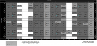

Interesting instruction tables. In the one for transfers, don't forget the stack as a memory addressing mode.
I would try structuring the opcode table with a different grouping of bits, which better reflects the way opcodes are internally decoded by the 6502. Broadly speaking there is an aaabbbcc pattern, which gets confused if you make the table "square" with an xxxxyyyy pattern. I think it makes sense to have rows with the aaa000cc bits, and columns with 000bbb00 bits.
the site i linked before actually has those tables like that, and while it is kinda neat to look at... it's much less convenient, harder to understand/use (especailly if you're new to the CPU), and much less compact (you would need to scroll a lot to actually use it).
there is a reason this xxxxyyyy way of ordering Opcodes is so common with 8 bit CPUs (including the 6502, as said even the offical datasheet does it like this (page 10)). it's just that good.
What's with all the 'X'es in the column and row headings?
the X basically means "don't care", its common to have the top be the low nibble of the opcode, and the side the high nibble.
other sites like these just use a 0 to represent the same thing, which i could do as well....
for example "AND zpg", you go to the left and it says "2X", you go to the top and it says "X5",
then you just add them together in your head:
  2X
  X5
= 25
there you go that's the opcode. (in hex of course)

I know how to read an opcode table. :D It's the first time I've ever seen that sort of representation. Just about every opcode table I've perused in the last 50-odd years that refers to byte-size opcodes has a single digit in the headings. The opcode tables in the 65C02 and 65C816 data sheets are a good example.
well but then how would you know what is the upper nibble and what the lower nibble of the opcode?
i guess a good way would be something like this?

Proxy wrote:
the X basically means "don't care"...
I've seen the 'Ax' and 'x3' labels in other opcode tables (oxyron's for example), and I very much like it when they do that. It lets me immediately see which direction to read it in, which is handy because I certainly will never memorize the particular (and differing) directions for the various tables I use from time to time. So Proxy, I recommend you keep doing that!

If you'll excuse the colour coding, the attached is what happens when you do as I suggested. Large parts of the opcode map start to look organised.
Re: Starting with my first SBC Project, Plans and Confusions
Posted: Sat Apr 04, 2020 11:17 am
by Proxy
while yes the opcodes are ordered, the numbers are now scrambled, making it harder to actually read....
just stick to the standard Opcode matrix/table that has been used from the start... it's common, and it works across different CPUs.
though i guess it's useful for finding what hex value a specific instruction has,
while the regular opcode table is more useful to find what instruction matches a given hex value.
so they kinda complete eachother...

Maybe this one is a bit easier to read, with extra header rows where the last digit changes:
Posted: Sat Apr 04, 2020 2:05 pm
by Proxy
not bad, but i got a much beetter idea
basically you just have the 8 bit opcode split into 3 parts... so all you need is a table with 3 axes!
this means in order to properly display all opcodes and numbers in a ordered way you need a 3 Dimensional Table/Matrix, easy as that.

cjs wrote:
I have never seen such a thing in any official microprocessor data sheet and find it unnecessary and somewhat distracting. As long as I've been working with this stuff, convention has been like that seen on page 22 of the 65C02 data sheet.
Posted: Sun Apr 05, 2020 12:11 am
by cjs
But surely you must be glad that the original data sheet convention for the instruction table (used not only by MOS/Commodore for the 6502, but by Motorola for the 6800, among others) wasn't forced on Rockwell and WDC, so that you can have this format you like, too, right?
I personally find it a bit weird that in this format one looks at the numbers on the right to get the left-hand digit, and then the column of numbers on the left to get the right-hand digit. I'm sure you get used to it if you use it regularly don't use tables that are the other way around.
That really does bring out the opcode organization. Nice work.
