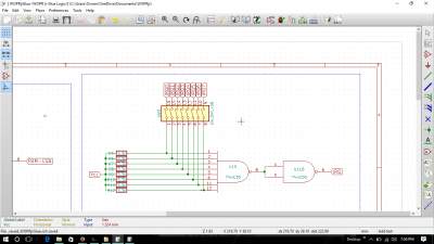

Here's my version with the 74HC30 Garth suggested. I also re-configured so that switches switch the IRQ lines, not the pullups as it did previously. That was a dumb mistake I only just now saw :roll:

If you want a DIP switch to cut off an interrupt, you need to put the switch in series with the IRQ\ line, not the pull-up. The way you show it, the IRQ\'s are still connected all the time, but if you remove the pull-up, the IRQ\ may go true full-time, which is the opposite of what you want.
Keep in mind that:
  • An I/O IC will not generate any interrupts at all if it's not set up to. You may only have one or two ICs generating any interrupts at all.
  • Any given I/O IC might have quite a few interrupt sources in it, and you might only have one source in the whole IC enabled. Not a lot.
  • However, if you do have multiple sources within a given IC enabled at once, a switch will cut them all off together, not allowing "line-item veto" so to speak. Depending on what the sources are though, you might also be able to stop one source or another from generating interrupts by removing the input that's causing them, for example by unplugging a peripheral that's causing interrupt-on-change, or sending data, etc..
These things may or may not change your plans, but keep them in mind.
FETs have source, gate, and drain, no collector; but the term "open-collector" kind of remains from the TTL days. You'll also hear "open-drain." Either way, the idea is that a line is pulled to ground through a transistor when it's on, or left to float up when the transistor is turned off, whether it's a bipolar transistor, or any of the kinds of field-effect transistors. The effect is the same.

I you look at my most recent schematic, I thought I fixed the switch placement problem.
I realize chips sharing a line will be switched as a group. Realistically, 8 lines seems like overkill for my plans, so in practice, I'm confident that none will have to share.
I figured it was habit that caused folks to say open collector, even when technically a device was open drain. Just wanted to confirm :o

Yes, my apologies.  I guess I forgot to click on the diagram to enlarge it, and just assumed the top was Vcc (or VDD) so you were switching the pull-up resistors rather than the IRQ\ lines.
