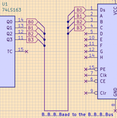

I think you shouldn't use global labels (e.g. A15) that are subsets of the bus, for sure, as the "A15" on the bus is not necessarily the same. I believe you should use the whole bus every time, with a consistent range of members, and break out the wire you need from it - or explicitly export wires like A15 on one of the sheets to a global A15 label, to make sure that in other sheets the global label A15 does refer to that wire.
But the main reason you're getting ERC errors, I think, is that you're using "bus-to-bus entries" to make 45-degree lines - they are not normal connections, so one side of them is not actually the same bus as the other! Either draw 45-degree lines by hand (tedious) or just don't draw the 45-degree lines at all. If in doubt, I think Alt-4 will highlight everything connected to a wire you hover over, so you can verify what is or is not connected.
I can't confirm the above however as Kicad 7 no longer seems to have the bus-to-bus entries, only wire-to-bus entries. I'm not even sure what the bus-to-bus ones actually were meant to do.

I have found that Kicad gets sulky if you wire the bus connectors the wrong way around...
1) draw and label the bus e.g. [A0..15]
2) place your part to attach to it
3) label each pin to be attached (I usually do a short stub, but I'm not sure it's absolutely required). These should match the bus e.g. A0, A1 etc
4) select the bus connector tool and rotate the 45 joining wire until the control end - the end it rotates around - meets the just labelled stud and the other end meets the bus. This requires the bus to be in the right place relative to the stub - 0.2" away by default.
I speculate that if you do it this way around, the stub acquires the bus label and therefore attaches to the bus correctly; the other way around it's trying to acquire the complete bus name, or just doesn't know what to connect to... I don't know for certain but I haven't had any unconnected issues since I discovered this by trial and error.
Curiously once you have a spray of connections to the bus you can copy and paste them elsewhere and they remember their names.

I'm on my phone so it's hard to type, but what I'm referring to is the 45degree blue corners you have in some places. These are possibly a special type of bus-to-bus join, and may be causing the issue. I'd delete them and just join the blue bus lines together directly.
Note that all identically-named labels on any single sheet are connected, whatever their type. So buses do pretty much nothing within a single sheet as both endpoints already need to have the same net label (e.g. A4)! They are mostly just decorative. The only case they do something significant is when you export them between sheets either using global labels or hierarchical labels for the whole bus (as you have done). But this is why any case where you use the same bus member twice within one sheet is not triggering the error - because it is connected to at least one other thing through the label alone. But not all the things you wanted!
Kicad's legacy handling of buses is quite poor - just a thin veneer over labels. It is more "first class" in version 7.
Edit, oh one other thing - make sure you press the dialog button to rerun the ERC after opening the ERC dialog, or it will just repeat the errors from last time! I've been confused by missing this step before.

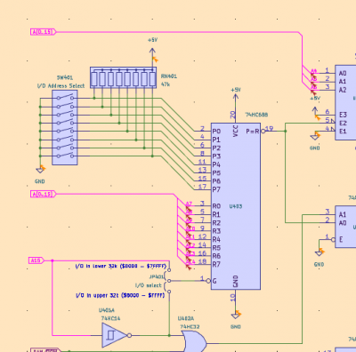

Anyway, here's a more or less done schematic. It's in black & white in case BDD is lurking menacingly someplace nearby. :P I didn't do the VGA page, because I thought I'd wait until I'm back home to do that so I can make sure it accurately reflects what I really built on the breadboards. Also I plan to add a "Serial" page eventually for an ACIA. I've gotten behind on my Ben Eater videos. :D

Nice! I'd suggest learning how hierarchical pins work, they can be quite nice to use depending on how modular your sheets are, and make you less dependent on getting the global labels matched correctly.
J301 is missing some resistors otherwise it's going to short VCC to ground.
I'm not sure why RAM/~ROM has a pulldown resistor, R401?
Also where did you get your symbols from, did you make them yourself? I've looked for decent 6502 symbols in the past and ended up making my own or customising them I think, so I'm curious where you found yours.

Man, you have a good eye!
This originally had a separate VCC for each jumper, I think, and I messed it up trying to clean it up visually (it was overlapping with the address bus. I will go rejigger it.
Ah, that's a leftover. I had originally planned to use a VIA port rather than a flip-flop, and I wanted to make sure that ROM was activated by default after a reset. It can be deleted!
I use forum member Alarm Siren's KiCAD library for the 6502 and 6522s. For the others I mostly just edited existing symbols from the symbol library. The only one I had to make from scratch was the DS1813, which didn't seem to have a similar device in the library. (Although, the library is huge, so maybe I missed one.) I just took one stage from a flip flop and gave it new pins.
