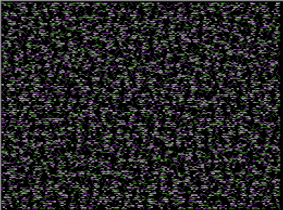

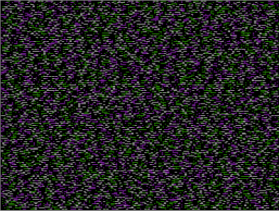

Arlet, superficially, this looks very promising with an immediate of #39:
I wondered what the ASL was doing to help, and TBH it looks pretty good without it:
These images are of an Apple ][ hi-res screen after filling the screen approximately 30% full of "random" dots. The one without the ASL seems to have a slightly coarser "texture", but I think either one suits my purposes just fine. Do you (or anyone else) have any further comments before I add it to VTLC02? It's going to have a net cost of nine bytes, but I think the improved quality and slightly improved performance outweigh the cost.
