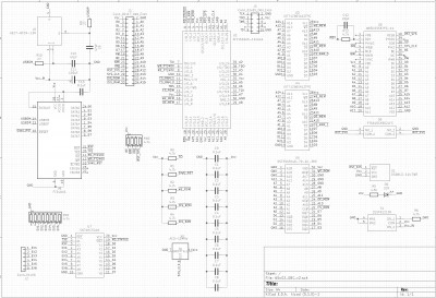

Ok here is the second revision of the board, well atleast the Schematic of it.
Important changes:
Fixed the Reset button.
Added a Resistor array to pull down the unused inputs of the 541 (U3) (also added a pin header).
Added a decoupling capacitor to the 3.3V rail of the FT240X.
Connected all unused inputs on the GALs with GND (there was only 1 usused input on U2, for the rest of the IO Pins i can set them to output in WinCUPL).
Added a power switch, when off it connects the board's Vcc lines to GND (through a resistor to avoid any kind of shorts).
am I missing anything?

Here's another idea (if I am correct) about the '541 enable, since we were worried about that being slow.
Right now /RD_STATUS is slowed by having to wait for the first GAL to generate /EN_IO before it can bring /RD_STATUS low. Since you have two enable inputs on the '541, you could instead bring /EN_IO to one of them (leaving /RD_STATUS) on the other, but change /RD_STATUS in the second GAL not to be qualified by /EN_IO, reducing the delay to enable the '541, I think.

Proxy wrote:
Ok here is the second revision of the board, well at least the Schematic of it.
In the future, I recommend you decrease your pull-up resistors to 3.3K. The lower resistance will improved noise immunity without affecting the ability of any connected devices to pull a strong logic 0.
I think that would work, although it could be classified as a kludge. :D
Ultimately, the solution will be in using a CPLD for the glue logic. An ATF1504AS has much more in the way of logic resources than any GAL, plus has 32 uncommitted I/O pins in a PLCC44 package. Also, the entire ATF15xx family can be programmed in-circuit via JTAG, which makes logic changes a quick and easy process. An ATF1504AS will easily handle what this circuit is doing, plus more.
that could actually work, it would parallelize the generation of the enable signal, basically making it twice as fast.
well i would like to start with the ATF1504, but i need a programmer.
plus i wasn't sure if i should directly replace the GALs with the ATF1504 because i never worked with it before.
but i guess you guys have, so as long as i show the schematic of how i want to wire it up on the board you could tell me if there is something wrong with it.

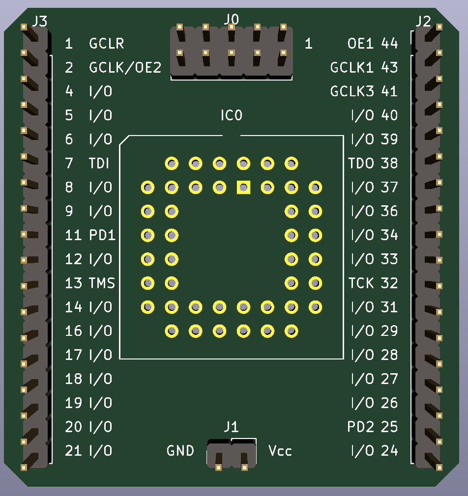

also i wanted to order a breakout board for the ATF1504 so i could experiment with it on it's own.
I know i could've made it a lot slimer but i wanted to see what each pin does.
I'm also not 100% sure on the pinout of the JTAG connector. i assume this is correct:

ok now a few questions about somne of the pins on the ATF1504.
I know the use of the 4 JTAG pins, and will avoid using them for IO stuff. (I assume my JTAG connector is correct as i cannot find a pinout of the Atmel Programmer's connector online)
I have an idea what some other pins do, like the GCLR (Global Clear) which probably resets all internal flip flops.
and the GCLK (Global Clock) pins, which are likely used for the clock input of the flipflops, why there are 3 of them though, no idea.
but now the confusing pins:
OE (Output enable), there are 2 of these and one of them is on the same pin as a Global clock, no idea what they are for.
PD (???), there are also 2 of these, again no idea what they might be for.

The multiple GCLKs, OE and so on will be configurable in their use, based on what you program into the device. You'll need to look at the internal structure of the device to figure out what it's capable of and how those signals can be used.
how the frick did i miss that. just looking at the datasheet it explains them.
and i thought i read through the whole thing...
ok with the help of that i tried to assign all the pins in such a way that makes it easier to route.
overall i used up all IO pins, and there were only 2 input pins open that i connected to GND. (pin 2 and pin 44)
it also fits on the PCB, though i had to move some Ground Traces around for that.
I tried to read your JTAG connection schematic but, once again, color is preventing me from clearly seeing what's in it.
OE is exactly what the name implies. That said, those pins are not dedicated to that function and can be used as regular I/O pins.
PD is "power down" and would be used to reduce power consumption when the circuit is idling. As with OE, PD can be used for regular I/O.
