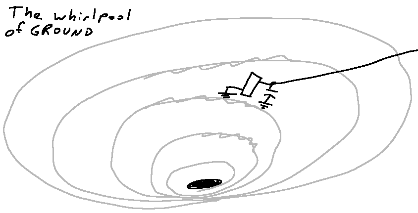

That's good news - I posted just before going on vacation in the hopes it would help, but didn't get to check on the outcome until just now. I'm happy to hear you got it figured out. There is a graphic I saw once (maybe even here on this site) that helps to illustrate the issues you can run into with grounding. Here is my very poor rendition:
A circuit floating in a whirlpool of electrical GROUND
Each IC on a board is somwhere in the whirlpool of ground. Some ICs and circuits make a lot of waves themselves. When focusing on a particular IC or circuit, its "local ground" is what matters. We use decoupling caps to make sure our power supply stays a fixed distance from "local ground". If that portion of the ground on the board floats up or down a little bit, the decoupling caps will keep the power supply 5V higher than the local ground (for a 5V supply). Any circuits that are sensitive to noise should use the same ground as the IC or circuit they connect to. It's true that connecting all of your grounds can make things worse sometimes, because you might be connecting to an IC that makes a lot of extra waves.
This is also why it's important to use the ground that the IC is using when you a probing with an oscilloscope. If you use ground all the way back at the power connector, it may be at a different potential and with a different amount of noise than the local ground at the IC, and this noise will show up in your trace even though it doesn't exist at the IC itself.

Thanks for that diagram. It definitely helps as a visual guide for where to group support components.

I'm delighted to see the oscillator problem resolved. :) Hats off to SamCoVT for taking the time to carefully eyeball the routing of the PCB ground traces!
SamCoVT wrote:
You may just want to add a little jumper
Let's be clear that success was achieved by increasing the interconnectedness of the various points that are grounded. This is clearly a case where more ground paths are better than fewer ground paths.
And that's no surprise. Extrapolating the "more paths" principle to the extreme, we ultimately achieve a ground plane, which can be considered ideal (because every point connects to every other point). Of course, projects like Martin's can't achieve a complete ground plane because the PCB is only two-layer. Thus the Ground and Vcc distribution is something that has to be consciously and explicitly laid out by the designer.
Often this is achieved by means of a grid of interconnected vertical & horizontal Gnd traces (and likewise a grid of Vcc traces). Note that the primary function of the Gnd and Vcc distribution network -- be it a pair of grids or a pair of planes -- is to connect the chips and their bypass caps to one another. Yes, the goal is to connect the chips to one another (ie, connecting to the power supply is secondary).
Despite my appreciation for certain parts of SamCoVT's post (eg, the scope tip), the remark quoted above seems out of place or at least needs to be strongly downplayed -- IMO it's too fine a point for a summary. Novices won't reliably be able to identify circumstances where it applies, and such circumstances tend to be quite uncommon anyway.
Vastly more common is the issue of NOT ENOUGH interconnectedness of the Gnd and Vcc points. :!: I don't recall ever seeing a problem on this forum that was resolved by reducing the number of ground/vcc interconnections. But cases (like this one) where bolstered Gnd/Vcc interconnections prove beneficial are comparatively common. That's why it seems to me to be a point worth noting.

I generally agree with all of Jeff's points. I work with a lot of mixed analog/digital/power-switching circuits so I, unfortunately, do run into situations with tricky ground interconnects more often than usual.
