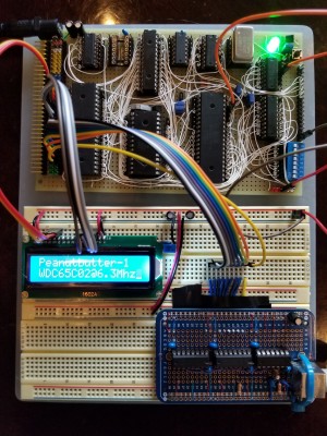

Here's a little update! Still procrastinating from building VGA circuits (hehe) but I thought it might be useful to have keyboard input in case I want to do some real-time debugging with a monitor. So, I stole Blue April's keyboard interface card and rigged up a breadboard for it:
It actually runs at 12.6MHz, but it's a little glitchy. Just a little glitchy. They're kind of funny glitches. Almost all the keys work, except M. When I push M I get a space instead. Just M, and always just a space instead. Weird. One hypothesis I have is that the keyboard card uses some AHCT logic (Blue April uses AHCT, and I didn't have any HC595s to replace them with), so maybe the bit pattern for 'M' just happens to generate line noise that the AHCT shift registers object to. I didn't investigate too hard. Everything works fine at 6.3MHz and I will have to slow everything down again when I hook up the CRTC anyway; it's a much slower part. So... :lol:

Turn up the voltage slightly up to 5.3V and see if it is more stable. 12.6MHz is 1/2 of 25.175MHz; it is nice to keep the design synchronous with one clock driving everything (except serial in this case--hard to make standard serial clock with 25.175MHz source).
Yep! I don't think I mentioned it, but that flying orange wire is the clock line; I have 12.6, 6.3, 3.14, and 1.6 MHz available off of a 74HC1633. That flying wire could also be contributing to the glitch. I have some nicer shorter jumpers coming, but they're taking forever to get here!
My voltage wall wart puts out around 5.1 volts. I don't have a nice adjustable bench supply, but I do have some spare ATX power supplies laying around. I've seen some videos where people convert them into bench supplies. I haven't quite got up the nerve to do it though; it's been a long time (read: decades) since I've done anything near the mains...
Does it put out 5.1 under load though? Wall-warts aren’t noted for their great regulation.
I use an old ATX power supply to run my POC units. No internal work is needed for the purpose, only a toggle switch patched on to the power “pilot” lead and ground to turn it on and off.
It's 5.15 where it comes onto the board. It drops to 4.94 across the A/K of the LCD backlight, which is the furthest point from the supply. All the IC sockets have at least 5 volts across their power pins.
I think it's having more trouble keeping up with the current demands; the Model-M is a power hog! If I understand how to use my meter properly (which is not necessarily a given) the SBC itself draws about 9 µA. When I plug in the LCD it jumps up to about 12 µA. The backlight for the LCD jumps to ~440µA!
With the Modle-M plugged in, it draws 133 MILLI-AMPS
Edit: I dunno, the wall wart is rated for 2A; maybe the LCD is just not a very good one... it was pretty inexpensive!
