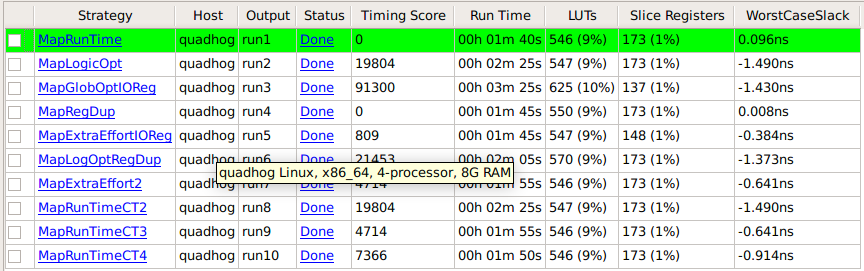

It certainly works, but there's a slight impact to the overall speed:
- the old version makes timing at 80MHz (12.404ns)
- the new version doesn't (13.453ns):
Here's the critical path in the old version:

Let me give Start Explorer a try in both cases...
Dave

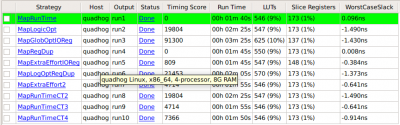

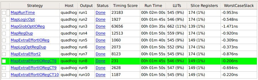

FYI, here are the two Smart Explorer runs:
Old:
New:
It does seem to be consistently worse.
Dave

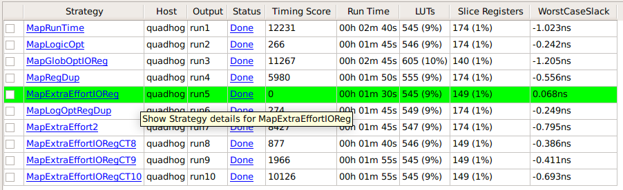

I've made some more changes to generic ALU/microcode for BCD carry flag. No idea if this makes things worse or better.
hoglet
Posts: 367
Joined: 29 Jun 2014
Re: My new verilog 65C02 core.
Post by hoglet »
Somewhere in between; there was one run that meets timing at 80MHz:

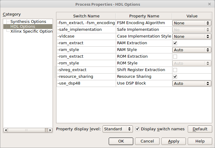

I've added the BCD support to the FSM controller, but that made it grow a lot bigger. Before doing interrupts/reset, I want to see if I can understand why it is so big, and if there's anything that can be done to improve it. Also, I don't like that the outputs are not registered.
If I remove all control signal outputs, and just keep the state machine, I get 29 flops, which makes sense because the state machine is one-hot encoded, and there's a flop for each state. There are 26 LUTs used, which seems reasonable given that some states don't need one, while other states need one or a few for address mode decoding, or for incorporating some choices based on the independent flops.
If you right click on 'Synthesize', you can select 'Process Properties ...' which shows the dialog below. On there, you can choose between various automatic state machine implementations, or 'None', to stick to whatever is written in the source code. When I do 'None', I get 5 flops, which is much smaller, but I get 35 LUTs, which is bigger than for one-hot.
Since each FPGA slice has a total of 8 flops, each driven by a LUT5, it is a good idea to keep the number of flops and LUTs balanced. There's no point in using the compact encoding to save flops, because they will be wasted anyway in the slices that are used for logic only. Also, while it is possible to use flops in a slice without the corresponding LUT, and use the LUT for something else, I think that should be avoided, since it creates more routing pressure. Ideally, you would have a balance, where each state flop uses exactly one LUT to drive it.
Of course, the state machine is only part of the total control module. Since the states drive the control signals, the exact state encoding impacts how much logic is needed for the other parts. The disadvantage for one-hot is that it produces a very wide "bus" of state signals that make it hard to select other muxes.
