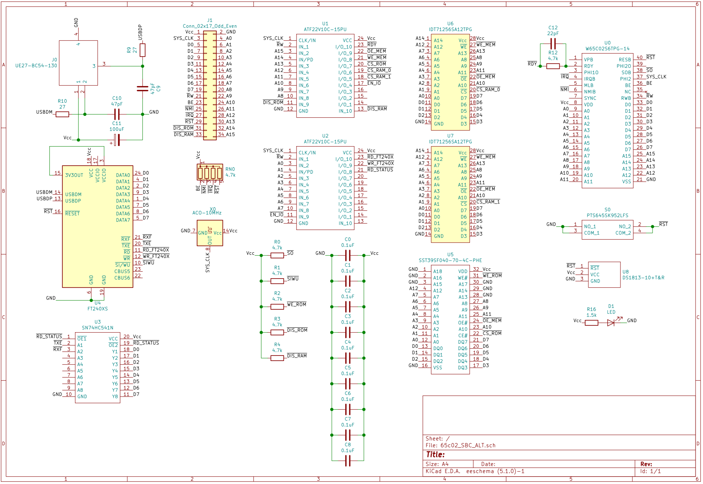

ok to kinda go back to this problem, i tried it with the BIT instruction.
.WAIT_RX:				; Loops until there is data available in the FIFO (ie. until bit 1 = 0)
	LDA STT				; Load the Status Byte
	BIT #0b00000010		; Check if bit 1 is set
BNE .WAIT_RX				; (or BZC), if it is set jump back to the start of the Loop
now again, if my understanding of the Z Flag and the AND instruction is correct, it should go like this:
in this case: 0bxxxxxx10 AND 0b00000010 = 0b00000010. therefore the Zero Flag should be cleared.
and when there is data in the FT240X that bit gets set to 0,
so then it's: 0bxxxxxx00 AND 0b00000010 = 0b00000000. therefore the Zero Flag should be set.
but that doesn't work for some reason...
I can check with my logic probe and see that the line gets pulled low when i send data to the Computer
I wrote a program that simply constantly reads out the Status Byte and sends it over Serial and can see when data arrived because the byte changed. (from 0x02 to 0x00)
so i know it's not a logic error and the CPU can read the status correctly, so it has to be a logic error on part somehow, but i just don't get why...

Your logic is correct. The BIT instruction is a logical AND of the accumulator with memory, setting or clear status register flags according to the result, but discarding the result itself.
Are you certain the device's status response to having data is as you describe?
Incidentally, I'd write the above as:
         lda #%00000010        ;test mask
.wait_rx bit stt               ;data in FIFO?
         bne .wait_rx          ;no

Yes i'm sure it works as said, here a snippet from the datasheet:
"When high, do not read data from the FIFO. When low, there is data available in
the FIFO which can be read by strobing RD# low, then high again."
and i made a small program that just reads out the Status byte and sends it directly over USB.
and using a terminal program i was able to basically see what the CPU was able to read, which was 0xFE (xxxxxx10) before sending any data, and 0xFC (xxxxxx00) after sending any kind of data. (technically it's 0x02 and 0x00, but the upper 6 bits are floating so it's usually just 1's)
So i know the CPU is reading the status correctly and that bit 1 is effected like expected.
i can try your code though, even though it should be functionally identical.
and if that doesn't work i can hook up my arduino logic analyzer again to single step through the program...

ok i checked with my logic analyzer and everything was working correctly... so it must be a speed issue...
looking again with my status byte sending program there was some weird glitching in the bytes i received. before sending any data i always expect 0xFE to come in, but sometimes it would also send a single 0xFC which should only appear after receiving data... so i guess the checking loop would catch one of those glitched bytes and just assume that there is data present and therefore read and send nothing...
i tried to slow the checking loop down with a little counter, but aparently counting from 0x1F to 0x00 isn't slow enough yet
plus it's weird that the 3 state buffer would have problems with a 1MHz 65C02. it's an HC part as well, i thought they were supposed to be "high speed".
datasheet
and it wouldn't explain the fact that only sometimes the bytes are glitched...
looking at the datasheet of the FT240X i don't notice anything about the RXF pin randomly changing, plus my probe doesn't show any glitching either
sooo... i don't know. I can try a bigger counter to make it even slower, but at some point it just becomes ridiculous... I'll just go to bed now, maybe tomorrow i can think of something.

think this would also be a good time to finally get an oscilloscope?
i think it would be useful to catch fast signals or similar... i still got the Rigol DS1054Z in my amazon list.
I'm also not sure about starting a completely new thread.
I think i'll just post everything i have here as a post... though later as i'm getting late for work, cya then!

Having a 'scope may help, assuming it won't hurt your budget. :D If your problem turns out to be due to some hinky timing issues you'll surely see them on a fast 'scope. That said, you may also need to build a clock single-stepper (a very simple device described on this page on Garth's website—scroll down a ways to see it) so you can hold the buses in a steady state to assist in seeing what is going on. I've used a single-stepper in conjunction with a logic probe to unearth hardware problems, often not even getting my 'scope involved at all.
However, before you spend your hard-earned money on more test gear, I think you should follow Ed's and Jeff's suggestions. Not meaning to cast any aspersions, but your topic has jumped around too much and has gotten to be ungainly, for lack of a better word. I don't fully understand the problem you are chasing and I suspect the others following your topic don't as well. You need to describe what you are trying to do, what the circuit should be doing, and what it is or isn't doing—and you need to be methodical and exacting in your description. Don't assume that anything is unimportant!
Without a full schematic to examine, as well as the data sheet for the FT240X, it will be difficult to see where you are going wrong and why. So please post those items (schematic in monochrome, please) and perhaps start up a new topic so we aren't wading through a lot of mumbo-jumbo. You've built your unit and now you are trying to debug it. Let's approach it from that angle. Also, we need to keep the Z80 stuff out of the discussion, as it will only add confusion—your MPU is very different from a Z80.
If you do this I think it will greatly improve the chances of one of us spotting something in the design that is causing your trouble. As Ed noted, we've seen this sort of thing before.

Alright, so to update everyone to the current status of the board
Here is a full picture of the Schematic:
and technically it's also a full list of all components, but i'll do that extra, with datasheets:
U0: WDC65C02 (CPU)
U1/2: GAL22V10D (Glue Logic, the Schematic says ATF22V10C but i did use the GAL22V10D on the actual board)
U3: SN74HC541N (used for the Status Byte of the FT240X)
U4: FT240XS
U5: SST39SF040 (512kB FLASH, 8kB used)
U6/7: IDT71256SA12 (32kB SRAM)
U8: DS1813-10+T&R (that Reset Circuit thingy, not sure what else to call it)
Here the download for the KiCad Files in case that can also be helpful: DROPBOX
and Here all the tools i currently have available to me:
			LDX #0x1F
			.DELAY_RX:		; Do Nothing for a while
				DEX
			BNE .DELAY_RX
			BIT STT
		BNE .WAIT_RX
		LDA INP				; Reads a Byte from the FT240X
		PHA
		LDA #0b00000001
		.WAIT_TX:			; Loops until there is space in the FIFO to write data into
			LDX #0x1F
			.DELAY_TX:		; Do Nothing for a while
				DEX
			BNE .DELAY_TX
			BIT STT
		BNE .WAIT_TX
		PLA
		STA OUT				; Sends the red byte back into the FT240X
	BRA .LOOP
STP
The actual problem i'm having at the time:
the "WAIT_RX" loop is supposed to exit only when there was data recieved by the FIFO.
The loop just repeatedly checks bit 1 of the Status Byte (STT), which is the RXF# pin of the FT240X.
if the bit is "0" it means there is data in the FIFO that can be read by the CPU, and that also makes the loop end.
Problem is that the loop ends without that bit ever being set to 0.
What i checked:
I first used my Logic Probe to see if the FT240X had some kind of quirk that would randomly pull the RXF# line low, but the Logic probe didn't show anything strange.
the pin stayed high until i send something via a Terminal Program.
Then i made a second program that just reads out the Status Byte and sends it directly over the FIFO to my PC so i can check if it is reading the Byte correctly.
START:
	.LOOP:
		LDA STT
		STA OUT
	BRA .LOOP
STP
Note that the upper 6 bits are floating, so by default they are always 1, i will show them as "x" in binary.
what i expected was just a continuous stream of "0xFE" (xxxxxx10),
but what i got is strange. mostly it was "0xFE" as expected but at random it would also output "0xFC" (xxxxxx00)
I assume this is why it was escaping the loop, it would randomly just read this sort of "glitched" value that makes it seem like there is data present.
After that i hooked up my Arduino to slowly step through the program to see exactly what is happening, and the problem didn't occour.
Overall this makes me think of 2 possiblities:
1. something strange with the FT240X, i doubt it since the datasheet doesn't mention anything about random signals and it wouldn't make any sense to be honest
2. something with the 3 State buffer i use to read the bits. (SN74HC541N)
I think this is everything?

Great detail, thanks! There's every chance the grumbler will ask for a monochrome schematic, but much more important, I suspect, is for you to share the equations for the two 22V10 devices. I wouldn't be surprised for the glue logic to be holding the clue.
Re: Starting with my first SBC Project, Plans and Confusions
Posted: Wed Mar 25, 2020 5:02 pm
by Chromatix
The one thing that really jumps out at me is those floating inputs on the '541. They really should be tied off to one logic level or another; if they float around in some intermediate state, you're liable to get instability within the device, higher power consumption, and possibly even interference.
Similarly, make sure that unused pins on the GALs are either tied off as inputs or set as constant outputs. The internal structure of the GAL may produce glitches from a floating input, even if it doesn't actually contribute to any of the minterm products.
oh i knew i forgot something!
here the code for U1, it handles the Memory Map:
Name     65C02_GAL_H ;
PartNo   00 ;
Date     24.01.2020 ;
Revision 01 ;
Designer Engineer ;
Company  Team Rocket ;
Assembly None ;
Location None ;
Device   G22V10 ;
PIN 1  = PH2;
PIN 2  = RW;
PIN 3  = A15;
PIN 4  = A14;
PIN 5  = A13;
PIN 6  = A12;
PIN 7  = A11;
PIN 8  = A10;
PIN 9  = A9;
PIN 10 = A8;
PIN 11 = DIS_ROM;
PIN 13 = DIS_RAM;
PIN 23 = RDY;
PIN 22 = !OE_MEM;
PIN 21 = !WE_MEM;
PIN 20 = !CS_ROM;
PIN 19 = !CS_RAM_0;
PIN 18 = !CS_RAM_1;
PIN 17 = !IO_EN;
/* ****************** LOGIC ************************/
/* RDY.D     = RDY & !(CS_ROM & IO_EN & RDY); */
OE_MEM   = (PH2 & RW);
WE_MEM   = (PH2 & !RW);
CS_ROM   = A15 & A14 & A13 & DIS_ROM;
IO_EN    = A15 & A14 & !A13 & A12 & A11 & A10 & A9 & A8;
CS_RAM_0 = !CS_ROM & !IO_EN & !A15 & DIS_RAM;
CS_RAM_1 = !CS_ROM & !IO_EN & A15 & DIS_RAM;
(note it has code for a RDY circuit but it didn't work so i commented it out. plus it seems to run stable at 10MHz without RDY Circuit anyways, atleast my "Hello World" Program did)
here the code for U2, it handles the fine decoding for the FT240X:
Name     65C02_GAL_L ;
PartNo   00 ;
Date     24.01.2020 ;
Revision 01 ;
Designer Engineer ;
Assembly None ;
Location None ;
Device   G22V10 ;
PIN 1  = PH2;
PIN 2  = RW;
PIN 3  = A7;
PIN 4  = A6;
PIN 5  = A5;
PIN 6  = A4;
PIN 7  = A3;
PIN 8  = A2;
PIN 9  = A1;
PIN 10 = A0;
PIN 11 = IO_EN;
PIN 23     = !RD_FT240X;
PIN 22     = WR_FT240X;
PIN 21     = !RD_STATUS;
A1_7_EN    = A7 & A6 & A5 & A4 & A3 & A2 & A1;
IO_A_EN    = !IO_EN & !A1_7_EN;
RD_STATUS = IO_A_EN & A0 & PH2 & RW;
RD_FT240X = IO_A_EN & !A0 & PH2 & RW;
WR_FT240X = IO_A_EN & !A0 & PH2 & !RW;
the reason i let them float is because i wanted to add a pin header to potentially add more status bits without having to use up an additional IO Address...
i guess for the second revision i can still do that but have a 2 wide pin header so when the inputs are unused i can use a jumper to connect the pins to GND, and when i want to use them i just remove the jumper to connect a wire.
should solve the floating pin problem without having to permanently connect them to GND.
with the floating pins on the GALs, can i just set them to outputs without any logic attached? will that just defualt them to one state?
