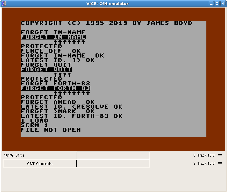

Here is a screen shot of trying to forget a word protected by FORGET's internal 'fence'.
