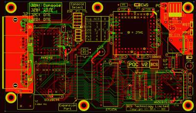

That seems to be the most sparsely populated area of your board, so it looks like you should be able to do it, at the expense of some bill-boarding and jumper-map real estate.
Mind-reader! :lol:
Current POC V2 PCB layout with an Atmel ATF1504AS CPLD.
Above is the current layout.

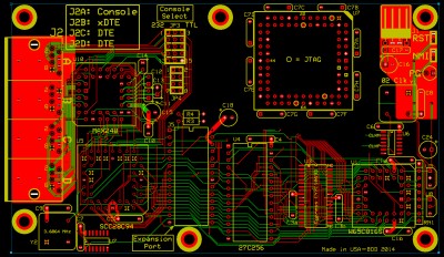

Partial POC V2 PCB layout using an Atmel ATF1508AS CPLD.
The above is the start of a new layout using the 1508AS. As you can see, the PLCC-84 package is like an elephant sitting on a toad in this design. Plus there are all those bypass caps. The top rows of pins won't be usable, because I can't get the connections out. Despite that, I'll actually have some usable spares, since only 36 I/O pins are used in the circuit and I figure 40-42 will be accessible.
The EWS jumper block you see on the small CPLD layout can be relocated, as it is a static DC circuit and thus isn't position-sensitive. Some silk screen artwork will have to go, which is no big deal. Otherwise, I think I can get everything hooked up. There's always a way...

Seems like it, eh, especially when compared to the PLCC-44 device it replaces. Hence my "elephant sitting on a toad" wisecrack. The 53CF94 ASIC on the SCSI host adapter is also PLCC-84 and accounts for about one half of the total PCB real estate. No wonder QFPs and such were developed.
BTW, the object representing the PLCC-84 package includes the socket. I could slightly shrink things by soldering the CPLD directly to the board, but that would mean I'd have to have a JTAG port to program it. I can live with the socket.

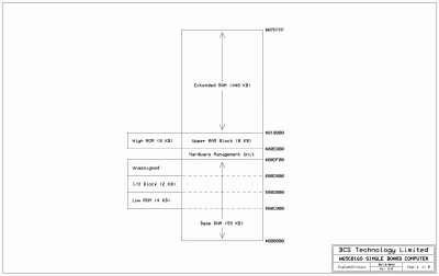

The ATF1504AS (the PLCC-44 device) was supposed to handle memory mapping, bank address capture, SCSI DMA logic, wait-state generation, /RD and /WD generation, and I/O device selection. The 1504 has 64 macro cells, so I also was planning on synthesizing a simple "hardware management unit" (HMU) to allow selective mapping out of low and high ROM, as well as write bleed-through when a ROM address is written. This would have allowed me to shadow the ROM in RAM and avoid wait-stating ROM accesses at high clock rates.
Since it appears I will have to make the switch to the 1508AS, the door will be opened to a more elaborate design. Here's the memory map:
POC V2 Memory Map
POC V2 Memory Map

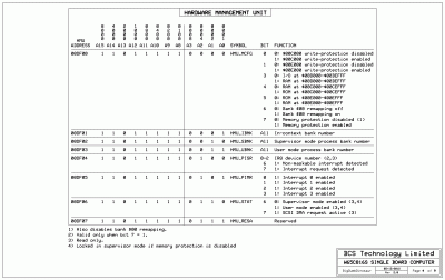

Ultimately, the HMU would be as follows:
Hardware Management Unit Assignments
The extra I/O pins on the 1508 can be connected to ABORTB, IRQB, NIMB and VPB. With 128 macrocells, I'll have adequate resources to implement some memory protection, user and supervisor modes, bank $00 remapping and other features that I've hashed out in older posts.

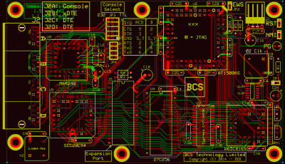

It took some doing, but I concocted a PCB layout for POC V2 that uses the PLCC-84 version of Atmel's ATF1508AS CPLD. It's fairly tight—definitely a case of stuffing a bushel of apples into a picnic basket. :lol: I even managed to preserve some of the silkscreen artwork. I'll probably fiddle with it some more to see how tight I can get it. Also, I spotted some minor boo-boos after I created the GIF you see below.
The entire board is a piece of art in itself. :)
What's your smallest track width and via size? My boards - comparable to yours in complexity - are 2 layer, use 10 mil tracks, 10 mil via tracks with a 20 mil hole and pass a 10 mil DRC just because I like to be extra safe. But it's a hell of a lot of work hand routing this stuff. I really need to start on 4 layer boards, with smaller features.
6 mil traces and 26 mil via with 8 mil holes. The board is four-layer, with internal ground and power planes.
Four-layer boards definitely simplify the layout, as well as allow you to pack things together more closely. You also get better noise immunity and avoid ground bounce problems. It's worth the slight extra cost over a comparable two-layer board.
Manual routing PCBs is a strange activity. Sometimes frustrating yet immensely satisfying.
I liken PCB layout to playing chess with an inscrutable master.
BTW, I said I would try to tighten things up a little more with the new PCB layout. I was able to crowd the CPLD a little closer to the rest of the parts, achieving a slight reduction in trace length. I'll let it sit for a day or two and then review it again to see if there's anything else that can be shrunk.

Well, it sat for more than a day or two as other matters used up my time (see first picture), but I did review the PCB layout and couldn't find anything else to do to refine it. I believe I have a "production" version (see second picture).
