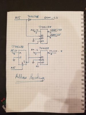

An address decoding scheme:
$0000 - $007F 128 bytes of ZP I/O
$0080 - $5FFF System RAM
$6000 - $7FFF Dual port VRAM
$8000 - $FFFF ROM
I hope!
Re: Blue April - RC6502 Project Space
Posted: Fri Jan 06, 2023 9:18 pm
by sburrow
$8000 - $FFFF ROM
I hope!
Someone (one of the greats of this forum) once told me to program for the system first and see if you like it's layout. Because I made a simulator using C++, I was able to quickly turn out some code that proved to me that my memory map was something I actually wanted. What do you have in mind for this machine? What are visions for how programs will function? What projects do you think you would/could develop using this platform? Have you tried any prototypes using software yet?
Just something to think about. This step is always very important to me too. I personally like minimizing glue logic so sometimes where things fall is because I wanted to reduce chip count.
Why I/O in zero page? As of now I think 50+ people have viewed your picture, and yet nobody has yet asked? I have seen a *few* systems use something similar to this, but many others I have talked to (on this forum) hold the zero page as 'sacred' in some regard. I personally don't use it at all as I am far too 'secular' for touching such holiness, but hey, to each their own. My personal favorites for I/O space are $0200-$03FF or $7F00-$7FFF, depending on what other glue logic I already have on the board.
What do you plan on hooking up to the I/O space? Just one VIA? An ACIA? both? 2+ VIAs? [ "What's another VIA?" - Garth Wilson ]
By chance, which Dual Port RAM did you buy? Could I know a part number so I can go look it up myself? I'm interested.
Just some questions, not really for my sake, but for yours. These are the things I think of, so just passing them off to you too :) But if you'd like to answer, I'm interested to read and learn!
Good work!
Chad
Posted: Fri Jan 06, 2023 11:37 pm
by Proxy
using up half the ZP for IO is quite a lot. and the only real advantages you get from IO in ZP are being able to use the 65C02's bit instructions and ZP Addressing modes on IO. but the obvious disadvantage is that it takes some of the space that would otherwise be used to fast temporary varibles and pointers. so you need to decide for yourself what you think would be worth more.
faster IO Access and bit manipulation, or having more RAM in ZP for pointers and fast variables?
atleast you can be sure that CC65 would work fine since it doesn't use a lot of ZP anyways.
Posted: Sat Jan 07, 2023 12:20 am
by Dr Jefyll
Yes, that's exactly right... and it's normal for the decision to vary according to the situation. (Different situations present different challenges and priorities.)
faster IO Access and bit manipulation, or [...]
It's also worth mentioning that IO in Z-page results in smaller code. And faster, yes (especially in light of the bit-test, bit-set and bit-clear instructions), but also for bytewise read, write and R-M-W.
In some situations the speed boost won't matter at all, but in other cases it can make or break your ability to reach a goal (such as meeting a hard timing deadline to input a data stream from an external device).
[...] having more RAM in ZP for pointers and fast variables
Just a reminder that in some situations you don't necessarily need maximal Z-page space for pointers and variables. Much of that need can be eliminated by using a virtual stack. As Garth says in his Stacks Treatise, "The resulting easier stack operations reduce the number of variables needed along with [reducing] the risk of overwriting data that another pending routine expects to find still intact."
Posted: Sun Jan 08, 2023 6:12 pm
by Paganini
Hi Chad!
At the moment dual-port RAM seems to be really expensive (like $10 - $15 per 1K!) or just plain unavailable from Digikey / Mouser. After trolling eBay for a few weeks I finally got lucky and found a guy selling a lot of 18 NOS CY7C144 35ns ICs. At least, I hope I got lucky! These seem perfect, except that they're PLCC68. I ordered a PLCC68 breadboard adapter, but it hasn't arrived yet, so I haven't been able to test them. The seller was a US-based amateur radio guy with 100% feedback, so I'm hopeful. Anyway, it worked out to about $2.34 per IC, shipped (shipping was high, the ask for the lot was low) which seems OK to me. I doubt I need 18 of them so if you'd like me to shoot a few of them your way I'd be happy to.
About I/O in Zero Page:
I/O in Zero Page is Very Old Voodoo. It's not the first time I came across the idea, but one of the Compute II articles I linked to earlier has a succinct description:
Gene Zumchak wrote:
When designing 6502 controllers from scratch, the address stealing method illustrated can be used to extract I/O addresses from zero page. Rarely is all, or even half, of zero page needed for scratch pad. Putting I/O in zero page not only can considerably cut program length, but also speed up execution time. In some of my early controller designs, I used a pair of 256 × 4 RAM chips, and decoded addresses so that the RAM straddled pages zero and one. The low half of page zero was thus available for I/O.
Of course, as soon as I started googling the idea I found Jeff's very thorough treatment of the topic.
If you think about the 6502 as a kind of hybrid RISC architecture, 128 general purpose registers seems pretty roomy (compared to 32 registers in a regular RISC processor). OTOH, if you think of ZP as a kind of slow CPU cache for system variables and such, even the full 256 byte page isn't very much. I can't answer every one of your questions because I'm kind of evolving this system step-by-step; but I do prefer to think of ZP as a big register file, rather than a tiny area of fast RAM. I realize these are only logical distinctions, but if I start thinking about register files I start thinking about (for example) how I can see a way forward for making a library of 32-bit operations by combining R00-R03 / R04 - R07 / R08 - R0B into 32-bit registers; whereas if I start thinking about RAM, I start thinking about how my jump tables won't be able to hold very many XINU system calls (if I ever get that far!) if they have to fit into 256 bytes.
Another way of looking at it is, if I eventually get this to the point where it really can operate as a video terminal for Blue April, fast I/O could be really handy. I don't know if I will need it or not; but it seems easier to make space for it now than to try and add it later if I want it and haven't got it!
As far as how much I/O, two VIAs, one or two ACIAs (do I need a separate one for RX and TX? I don't know how they work, yet), a CRTC (maybe), and some space for future expansion. I'd like to add some mass storage, at some point, and maybe some bank-switching. I've always kind of liked the idea of the cyber-decks from Neuromancer where you configure your system software by jamming in a big row of ROMs a la the BCC "sideways expansion." :)
