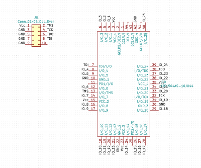

so, i still need help with the ATF1504. as said i don't have a progammer for it and i don't really know how and which to choose.
plus i'm a bit confused by some of the pins as mentioned last time (around a billion posts ago)
this is around all i have currently for the breakout board.
