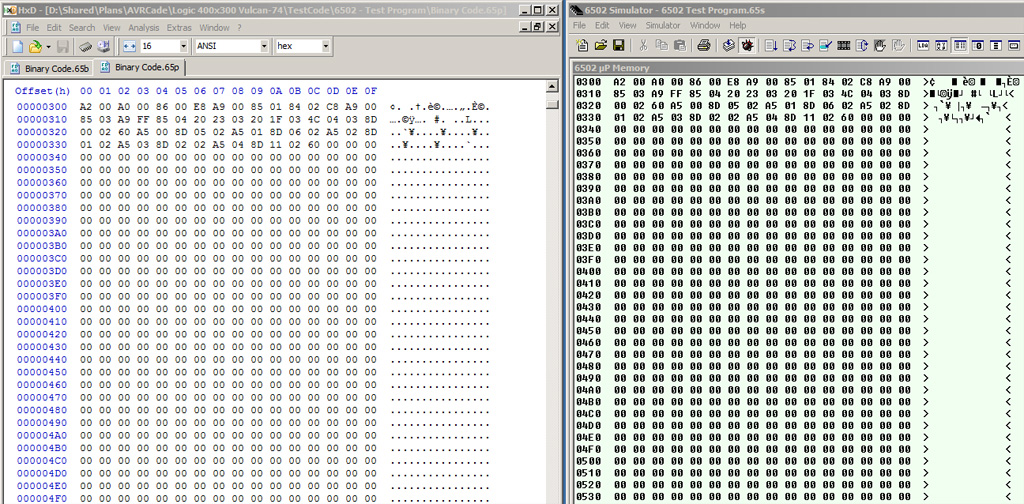

Update -> The 6502 is up and running!!
This is a milestone for this project, as I have exceeded every original goal.
For the last few days on my daily hour commute, I have been thinking about how I should approach my 6502 migration and learning curve, and eventually came up with the plan to start with one of the many good basic web tutorials available, and eventually get an LED to flash from my IO decoding scheme.
I then remembered that this is totally not my style, and within an hour had the AVR yanked and the 6502 completely wired up to SRAM and the 80 IO decoding logic based on my napkin sketch!
From there I wrote a Visual Studio program that would take the HEXDump from the amazing Easy6502 site, and convert it into a .DC.B (byte file) that I could load into the AVR that preloads the 6502 program memory. I then wrote some 6502 code to do basic control tests, added it to the AVR, which allows the AVR to bootstrap the SRAM while holding BE and RS low. From there, the AVR goes invisible and allows the 6502 to take over. Besides the reset vectors, the rest of the program code lives at address 768 and higher, with my 80 IO lines mapped at address 512.
With the 6502 clocked at a very conservative 4MHz, everything worked perfectly on the first power up!
The result was the Vulcan-74 Video System swapping the Live and Back Buffers at 60 frames per second while drawing a few pixels directly to the Video Memory.
If one command (IO toggle) works, then they certainly all work!

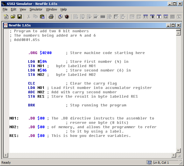

Thanks for all of the suggestions.
I have an odd style of coding, so my requirements (or lack-of), in order of importance are...
1) Single button HEX file.
By that I mean going from code to a data file with no messing around. Since I have created a loading system for my Flash Memory based "Cartridges", I want the toolchain to have as few steps as possible. Code, Compile, Send. I don't want to have to use multiple programs (especially command line) just to go from code to HEX file. AVR32 did this to me with AVRStudio + FLIP, so I refuse to use it.
2) No C compiler, Debugger, or Wizards! I want the ultimate MINIMAL IDE.
I have zero interest in C for this project, and I NEVER use debuggers / simulators / test-bench, etc. I code, compile, and then fix what's wrong the hard way... by looking at the code. In all my years of writing very complex assembly for AVR, PIC, ARM, and HDL for CPLD and FPGA, I have never used a debugger and do not intend to. I also have a rule to NEVER use code that I didn't write, so I don't want a compiler that holds my hand with suggested bloat code, or links to volumes of pre-made code that will ruin the challenge. I can't imagine that the 6502 tools are like this, but every other toolchain I use seems to be going down this rabbit hole! This continual dumbing-down of electronics and coding is what drove me to build this monstrosity in the first place!
3) Clean Windows IDE.
I like a huge window for coding, with code that will highlight properly. Comments should be one color, data would be another color, etc. Scrolling should not be clunky on large files, because I write very long code. I will have no problem writing 64K worth of pure assembly. Atmel Studio (Visual studio based) is almost perfect this way except that scrolling gets clunky when your code starts to exceed 500 lines or so. That pisses me off to no end.
So if anyone has a suggestion for an IDE that will do nothing but display nice colored code for me and then allow a single click to a .HEX file, that would be great!
I am thinking it may be easier to simply write this myself as an extension to my Vulcan-74 Graphics and Sound converter. All the compiler really needs to do is insert addresses for labels and turn instructions into numbers. Seems easy enough!
For now I will continue with this one...
https://skilldrick.github.io/easy6502/#first-program
I have coded a simple program in Visual Studio that captures the text generated by the "HexDump" button on the web page which turns this...
Into this code I can drop into my AVR based 6502 program Memory Loader...
That is the Snake Game example from the same site.
Note the lack of HEX numbers... I am still resistant!
Ok, back to testing the 6502.
Once all functions have passed the IO test, I will do a wire clean-up and post photos and a video.
Cheers!
Radical Brad

After some searching, and a recommendation from a buddy at Apatco.com, who makes and sells 6502 kits (shameless plug!), I think I finally found what I need here...
http://exifpro.com/utils.html
Has all of the features (and lack-of) that I wanted.
Highlighted code, compile, and save binary.
I will work with this for a while and see how it feels.
Radical Brad
Radical Brad

Re: Vulcan-74 - A 6502 Retro MegaProject
Thanks, will look at that on later as well.
So far EXIF is working perfectly, I have started my "Kernal" and hope to see the 6502 drawing some moving Sprites very soon.
The only thing I have not figured out yet (due to broken help) is which output format I will end up using.
I can export my code in the following formats...
- Intel Hex
- Motorolla S
- Binary Image
- Binary Program
I am steering towards Binary Program, is it is "probably" just a 64K image of the comiled program, which is perfect for loading into my AVR boot code for now.
I will have to peek around with HEXED soon to see how the binary files are made. If they were simply 64K images starting at 00000 and ending at 65535, then life will be good!
Radical Brad
- Intel Hex
- Motorolla S
- Binary Image
- Binary Program
Radical Brad

If I am assembling code to be loaded into my POC unit I select the Motorola S-record format. S-record output consists of one or more S1 records and an S9 record. There is no S0 or S5 record. Only the address range in which your code has been assembled will be output to S1 records. That is, if the start of assembly is at $2000 and you generated $1000 bytes of object code, the first S1 record will load at $2000 and the last byte of the last S1 record will load at $1FFF.
The binary program output is broken. I've never used the Intel hex output, so I can't vouch for it.

Hey Thanks Dino, good to have the latest version.
I have been exploring the file formats, and did find that the Binary Image is the one I will want.
In looking at the output in a HEX Editor along side the Memory Dump Window, it shows that both are identical.
I do want an entire 64K file, so this works perfectly.
