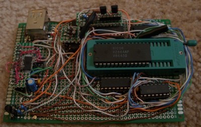

Thanks BigEd, I am used to some other forums where the attachments do not work well and people suggest you upload it to a different site.

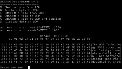

Martin, I was able to write binary files including some compiled asm I have made. The python script was using print() as a function and ran fine in 3.0, it had syntax errors with 2.0, so that was not the issue... It's cool you got a windows version working.
Next up is moving this contraption to a perfboard so I can free up my breadboard and actually test the z80 with memory. I already have a sketch of how I want everything laid out. My shield will include a reset button incase anything hangs (it's hard to hit the on board one), along with read/write active led's to see what is going on.

Neat projects! I have been working on my own programmer too and thought I would share. It uses an FT232 for USB communication. I decided to do everything over a serial terminal with XMODEM so it would be compatible with any OS, but using Java for a GUI seems like it accomplishes the same thing. For shift registers I'm using 74HC595s and a 74HC165 all running at 5v with a few transistors to level shift for my MSP430 microcontroller running at 3.3v.

I was working on transferring my breadboard design to perfboard and got really annoyed at trying to cut and place all the many address and data lines - it was a huge hassle. So since I have given up on that route I have started looking at PCB options as all the wiring can be done by the factory
I did not use Uniclocker's V2 shield as not all the caps and parts were labeled and I don't need the charge pump circuitry as I am just interested in the 28C chips. I probably could have modified his V1 shield to support a larger zif socket but I decided to take the challenge and learn how to make my own pcb for the fun of it.
I used kicad since it's free and you don't have to deal with some of the free eagle restrictions or trials. It's a simple design with just the ZIF socket (up to 40 pins) and two 74HC595 shift registers required (like many other designs here). I also added a reset button which could help with programming, and two led's for read/write to make sure the board works (although they are not needed for operation). I did not bother with decoupling caps as they increase the part count and price, and the breadboard and v1 designs appeared to function fine without them.
I am probably going to send the design off to be produced soon. If anyone is interested I would love to sell the extras to people here to help spread out the cost. $30 to 3 people is a better deal for everyone then $30 for one person who then has extra boards he does not need. Regardless I will still put up the pcb design, including all footprints, to my github page along with the modified python software I was using so future people may use it if they desire.
