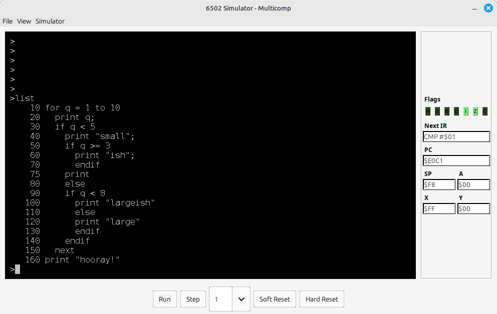

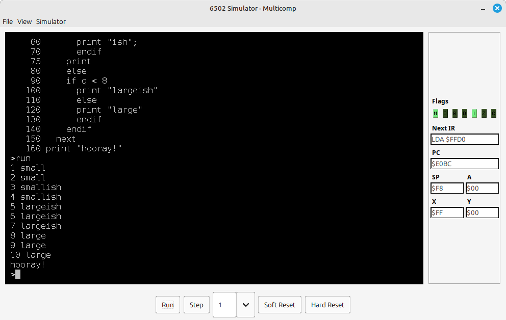

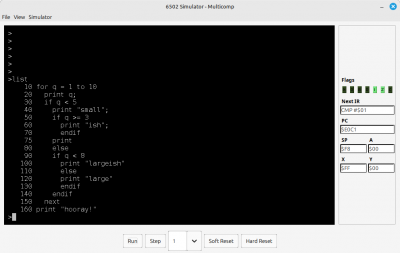

and after running
demonstrating nesting within if/endif and within for/next, and also showing both with and without the optional else.

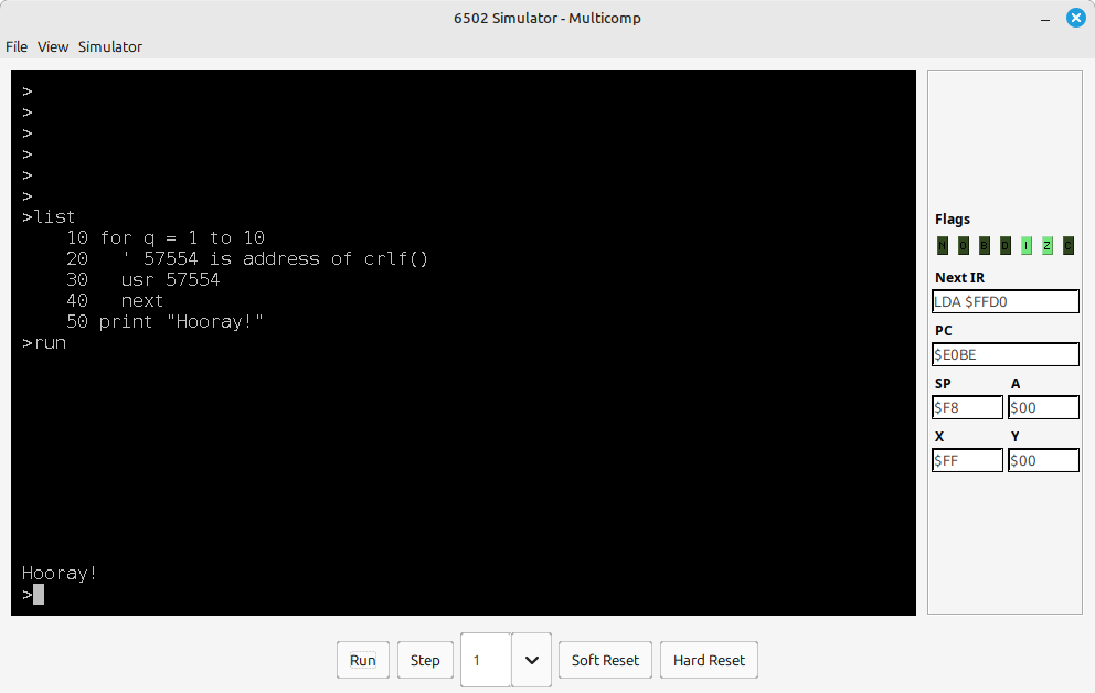

Usr, Ed? What? You mean like this?
That was easier than I though it might be, though it does require building a jsr and ret in the maths variables (hmm, have I missed a jsr (abs)?) but the target address can be any valid expression. I've called an internal routine here; building some code could be, um, interesting... (I mean, of course, is left as an exercise for the student!) though I suppose a routine to return the address of a given line could be helpful.
At the moment there are still around 250 bytes left...
