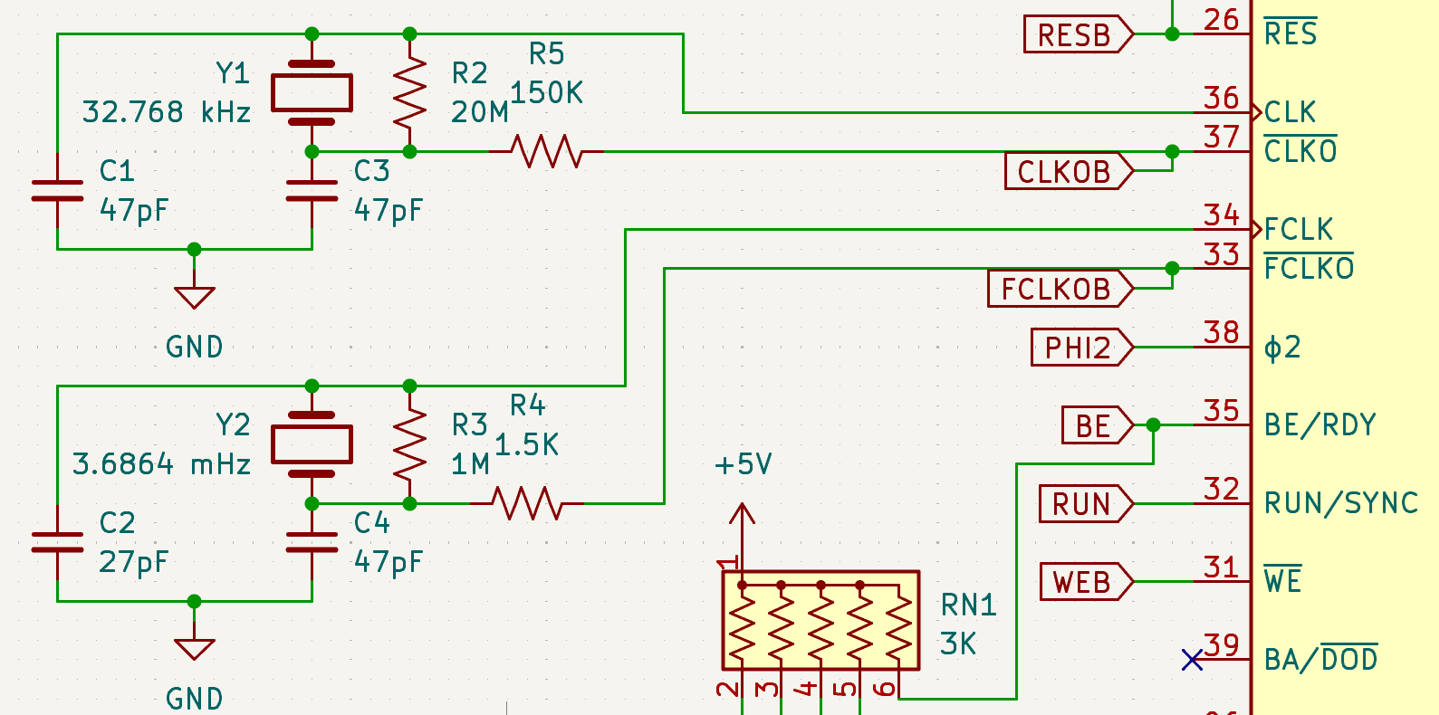

I constructed a test circuit for the crystal and confirmed that it is working. It oscillated at frequency that looks like approximate 3.6 MHz on my analog scope.
This raises the question as to why it does not work on the PCB with w65c265. I'm not sure how to debug that.
I may try driving FCLK pin from the working oscillator to see what happens.
Re: An Improved MENSCH™ Microcomputer
Good news!
I connected the external clock output to FCLK, put a scope probe on PHI2, and powered on. PHI2 was running at the external clock rate according to my scope. I started TeraTerm at 9600 baud, attached a USB dongle to the FTDI connector, and hit reset. The WDC monitor output was displayed in TeraTerm. Woot woot!
So, the base system works with a kludge external clock. Now to make a permanent fix before moving on. Some options:
1. Buy a can oscillator and use three wires to connect it. This should be easy as pads to ground and FCLK are nearby. Only +5V requires a short lead to the 65c22 socket. The three leads should secure the can oscillator well enough for hobby usage.
2. Debug the crystal oscillator circuit. FCLK as an input works, and FCLKOB can drive an oscillator. I also had a working crystal. So, the problem seems to be the combination of the two resistors and two loading capacitors. Possibly with the geometry and lengths of PCB traces?
I again compared my schematic to the W65c265QBX datasheet, and it matches. So, the problem with option 2 is I don't have a wide selection of SMD resistors and capacitors to experiment with. I also don't know what values to use instead of the values from the WDC datasheet.

Excellent news. The problem is that as you say there's not a lot to be going on with.
Though I might suggest that the high speed capacitors (27pF, 47pF) are higher than I would expect; perhaps something on the order of 11-15pF? You might increase R3 but it's dependent on the internal gates.

You might want to compare the values to what's on p.58 of the W65C265S data sheet at http://6502.org/documents/datasheets/wd ... 3_2010.pdf . They're quite different.
* The loading capacitor values are the same, but they're swapped between legs of the crystal. Does this make a difference?
* The resistor values are 100 ohm versus 1.5K ohm, and 800K ohm versus 1M ohm. However, the crystal frequency is different.
I would imagine the 100 ohm resistance would provide much more current to the oscillator.
I may buy components of these values and a few others and give them a try.

Good news, minor weirdness and annoyances, and next steps.
Good news first.
* My Mouser order arrived yesterday.
* I built a 74HC04 crystal tester on perf board, hooked it up to my scope, and it displayed a square wave at the expected frequency. So, I will keep the tester among my diagnostic tools.
* I replaced the PCB resistors with the values from the data sheet (e.g. 100 ohm and 800K ohm) and installed the crystal. I hooked it up to the scope and the PHI2 wave form looked good. This raises interesting questions about why the 65c265QBX schematic and the W65c265 data sheet don't agree.
* I connected the board to TeraTerm and it displayed the WDC monitor.

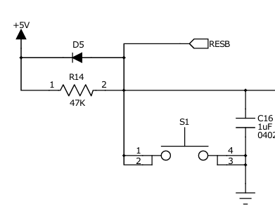

I understand some of my instability/weirdness issues and have fixes for some of them.
* Selecting auto for TeraTerm's new line setting fixed some of TeraTerm's weirdness.
* The power led is dimly lit when the USB adapter is connected but no power is applied to the 5v rail. I think there's leakage current from either the data or reset lines via the microprocessor. It seems harmless though.
* The reset instability has nothing to do with the lack of an EEPROM. In fact, it was made worse by adding one.
I reread the W65C265SXB schematic and noticed a 10uf cap across the USB power rails. When I run my board off USB power C10 100uf is not across the power rails. I think this results in stability issues which worsens as more chips are added. When I run the board off battery power stability noticeably improves when using the CPU and a RAM chip. If I revise this PCB, I will move C10 after J11 which should fix this.
However, putting the EEPROM on the board worsens stability issues. It's like pulling teeth to get a clean reset. Adding the 65c22 would likely make things even worse, but I plan to test this.
I'm not sure what to do about this. I have decoupling capacitors across all IC's. I also gave each IC its own power and ground connection. Should I add more decoupling caps?
Plug in the USB, but not the power, and check Vcc... around 4.4v, I suspect. Depending how much load other chips apply, and the abilities of the USB port, it could be lower. (The power is going through a PN junction in the protection diode, to the Vcc of the chip that's receiving it).
You might test by applying power before USB (and the other way around) and seeing which is stable. That might be an issue if you're expecting/requiring serial port operation as part of the boot up sequence, but you may be able to get away with a mechanical reset switch after everything's connected.
Test 1: I plugged in USB without battery power and checked the 5v rail. It had 2.7 volts on it, and it didn't matter if the EEPROM was present or not. I think this confirms power going through the protection diode.
Test 2: I plugged in battery but not USB, hit reset, and then plugged in USB. Most of the time it was not a clean reset. Moreover, hitting reset while USB was plugged in would sometimes yield a clean reset.
Test 3: After getting a clean reset and working system. I let it run for twenty minutes and exercised various monitor functions. It was stable the entire time. So, I hit reset and it failed to come out of reset. Hitting reset multiple times eventually resulted in a clean reset with previous memory contents intact.
Test 4: Since the 65c22 isn't part of chip select reset processing I installed the 65c22. The good news is it didn't make the problem worse.
Test 5: I did in all in test with all chips on the board with only USB connected. The 5v rail had 2.68 volts. I connected battery power and kept hitting reset. Eventually i got a clean reset with all chips installed. When it wasn't a clean reset the various chip select LEDs were on indicating the CPU was using the internal ROM to do something.
Test 6: I used the monitor in EEPROM write protect mode to try and deposit values into the EEPROM and its contents were unchanged. I put the EEPROM write jumper in the write enable and used the monitor to deposit values which I confirmed by reading. This is a big win as it proves the system can update its own EEPROM.
In spite of these frustrations, I feel like things are almost working. After a clean reset the system is perfectly usable.
I'm using the DS1813 eco reset with a 3k pullup on the reset line. So, I'm not sure what the problem is. I will look at the various WDC schematics to see if I'm missing something.
Update: I read through the w65c265sxb and w65c265qxb schematics again. Both use the same reset circuit which I have added as an image. The w65c265sxb has 270-ohm current limiting resistors on the serial port's rxd and dsr lines, while the w65c265qxb has no resistors and is identical to my schematic. Both are powered by the USB port, so they never have the no power scenario my board has. Looking at their reset schematic the 1uf cap controls how long the RESB line is held low. I'm not sure how it compares to the DS1813.
You may have to bodge something to isolate the Rx input... perhaps as simple as a schottky diode and a resistor or two?
That 2.5v floating around is definitely going to mess with your reset circuit, but I would expect it to be fine once it's powered up and reset - is there a difference between powered but no usb and powered _with_ usb (at Vcc)?
(I tend to power from the USB line, using an FTDI cable with a VCC output. Warning: those cables come in 3.3 and 5v versions, but that refers to the signal levels; the Vcc is 5v from the USB circuitry in both cases).
