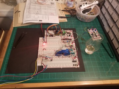

Merry Christmas, 6502 world! Here's a bit of Christmas Whisky and Wiring:
Is it a good idea to mix these two things? Well, at least today it did no harm!
:D :D :D :D :D :D :D :D :D :D
The project got *more simple* as I worked today. I kept going "wait, I'm not using that one for anything now, it came come back off!" The grand total, in terms of chip count, ended up being 9 ICs, a few ROMs, and a full-can oscillator. Here's where I landed:
I always start out tidy, but when I get into the thick of testing things I don't seem to be able to escape from the flying leads! O well. I did have to move the bypass caps back to the power rails. They were just getting in my way too much, and sometimes shorting out against IC leads. (Plus, they wouldn't fit over the ROMs or socketed ICs.) Still, it runs VERY stable now - I can poke it and prod it and jiggle the wires all I want and it doesn't react. Whee!
It's basically finished, in the sense that this is as far as I thought it out before I started building. The "framebuffer" EEPROM can be pretty trivially replaced with some RAM (the fast SRAM I have has an almost identical pinout). There are some immediate options for expansion. If you see that long green jumper wire going from the character ROM over to the left hand side of the top breadboard, that's the A14 line. Right now I just have two character sets in the ROM, and I can switch between them by manually moving that wire. But the ROM is 32k, so it can hold many character sets. I believe there are 3 address lines free for character set selection, so it could have up to 8. There are also some free frame-buffer address lines (3 there, as well), so I could maybe do some triple buffering. :lol:
I wonder how hard it would be to add some real terminal features, like a hardware cursor, to this. I think the next step is to sit down with a big pad and draw the schematic so that I don't lose the design if something bad happens to the breadboard! :shock:

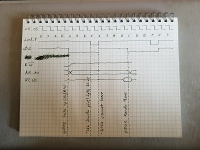

I did order some dual-port RAM; but it will take a while for it to get here. Also, it is a bit like solving the problem with money, rather than with brains. So in the meantime, I'm taking the opportunity to try and understand interleaved access using Ø1. There is surprisingly little information about how to do this to be found, beyond the general observation that many old designs took this approach, and the general observation that "the 6502 stays off the bus during Ø1." I don't quite see how this is true. It appears to me that the 6502 uses the address bus for the entire cycle, setting up the control signals (including the address) near the beginning of Ø1, and holding them all the way until the end of Ø2. I can see that, if you are fast enough, you could disconnect the 6502 from the address bus, complete a transaction, and reconnect the 6052 in time for it to finish what it was doing; but that seems a lot more complicated than just hooking an inverted clock signal up to a clock pin (or, in my case, gating RAM access with an inverted clock signal).
Here is a little timing diagram I made. My video circuit timings are at the top: a 25.175 Mhz signal, and a LOAD_P pulse. LOAD_P is generated by inverting the terminal count of a `163 that counts 8..F. The `166 shift register gets the next byte of pixel data from the character rom on the falling edge of LOAD_P; the `590 x/y address counters increment on the rising edge of LOAD_P. Below that is a timing diagram for a 6502 READ cycle, which I copied and slightly simplified from one of my books. Am I making a mistake somewhere?

That is exactly where I have my '166 loaded as well, at the end of PHI2-low.
The 6502 is ON the data and address buses while PHI2 is low. But it is not required for it to be on that bus, thus you can use the BE pin or some '245s. The problem with the BE pin is that if you attach it directly to PHI2, it will take the signals OFF the bus at the start of PHI2-low. But the 6502 reads in data on the falling edge of PHI2, so you could have some glitches there. What I do is extend the BE high period through PHI2-high part of the way into PHI2-low.
If you do it this way, make sure you qualify your RAM to the second half of PHI2 high. That was a big problem I had with some previous boards.
Also, if your master 25.175 MHz clock is directly connected to the '166 clock pin, good. If you are using the inverted signal, I found that I get glitches. THAT was an issue I had for many past boards and didn't even know it until I just tried it one day.

I had a kind of discouraging day over the weekend: I rebuilt the circuit from the schematic, both to check the schematic for errors (I only found one!) and to tidy up the breadboard, make some wires shorter and so on. The previous messier version actually seemed slightly more robust - the new tidier version has a noisier ground. I get some purple vertical bars if I plug the LCD's ground line in some places, but not in other places. But, that wasn't the really frustrating part; the video looked good on my IBM monitor I've been using for test; and I could navigate the frame-buffer as expected (I made a new ROM that puts a 'V' in each of the four corners and uses some of the semigraphics characters to draw a box in the middle.) But then I plugged it into my larger and newer ASUS monitor; it doesn't like my signal AT ALL. It's drawing a bunch of extra Vs during the blanking period, there's a lot of vertical glitching. I've had to travel back to IL for a funeral, so I won't get to work on it this week, but it is frustrating. I guess maybe my IBM monitor is more forgiving than the other one, and my signals are not as good as I thought they were. :cry:
OK, that makes sense. The chip I was thinking of using for this project has the Rockwell extensions, but not the WDC ones, so no BE pin. I think that means I will need some buffers to isolate the RAM from the CPU so that the 590s can drive it during Ø2 LOW. I do have a drawer of buffers, so that shouldn't be too hard (I hope!)
Yes, the '166 and the '163 that produces its load pulse are both clocked directly by the full can oscillator. I think that part of the design is good! In addition (in concept, since I'm still just drawing pictures and haven't hooked a 6502 up to this yet) the same '163 that generates the load pulse will also generate Ø2, so they should never get out of phase.
