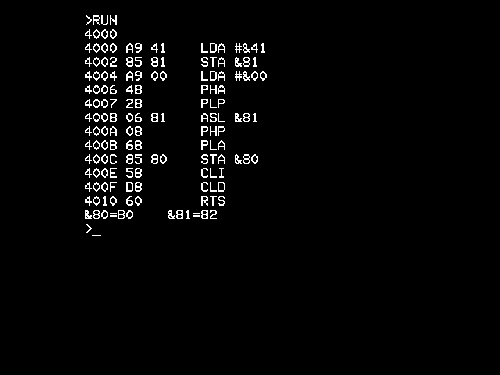

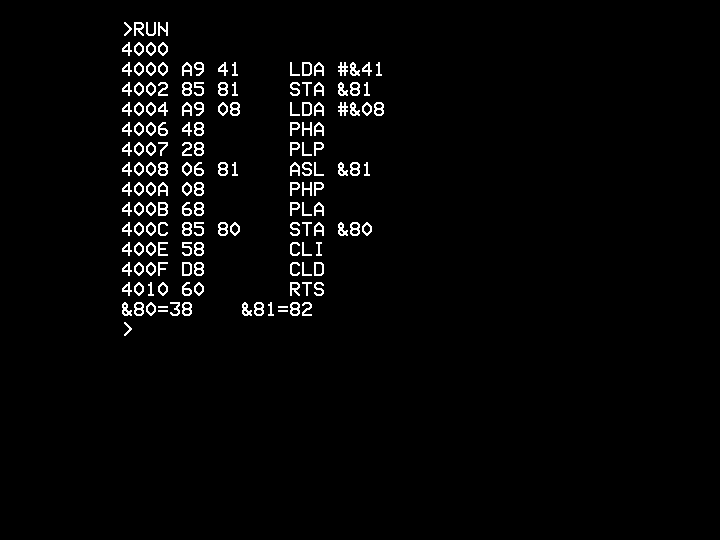

I've hit possibly the most subtle issue yet; it depends on the combination of:
- RDY being used (this is the most important pre-condition)
- Read-Modify-Write to ZP (e.g. ASL, ROL)
- Decimal Mode (for ASL anyway)
The bug results in the N flag being inconsistent with the result.

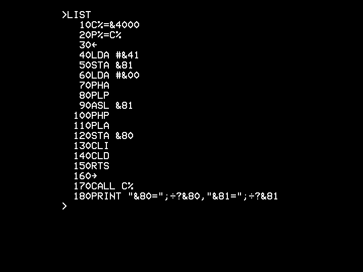

In following tests, location &80 is the flags after the ASL, and bit 7 (the N flag) should always match bit 7 of the result (in &81).
First, with decimal mode off:
Then, with decimal mode on:
I think I'm correctly following your suggested pattern for using RDY with syncronous memory. I also checked your implementation of RDY, and this looks solid to me. Every use of posedge clk is qualified by RDY, and this is the only use of RDY.
This is with the generic version of your core (I haven't tried the spartan6 version for this failure)
Looking at the microcode, there does seem to be an unexpected (to me) difference between &14C and &1CC
@14C  000_00001_01_000_0111_10011_00_00101100     // ASL, NZC   -> @12C
@1CC  100_00001_01_000_0111_10011_00_00011111     // ASL, NZC   -> @11F
If I change the test code to use ROL, then I see failures in both cases (i.e. N=0 in both cases, even though the result is &82).
The microcode for ROL is:
@152  100_00001_01_000_0111_10011_10_00011111     // ROL, NZC   -> @11F
@1D2  100_00001_01_000_0111_10011_10_00011111     // ROL, NZC   -> @11F
Any ideas?
Should all of these routines finish at &12C/&1AC?
Dave

Do you know how the RDY input is behaving ?
Arlet
Joined: 16 Nov 2010
Re: My new verilog 65C02 core.
Post by Arlet »
I haven't been able to reproduce it yet, but I suspect I know what it is, and it is related to the microcode differences you're seeing.

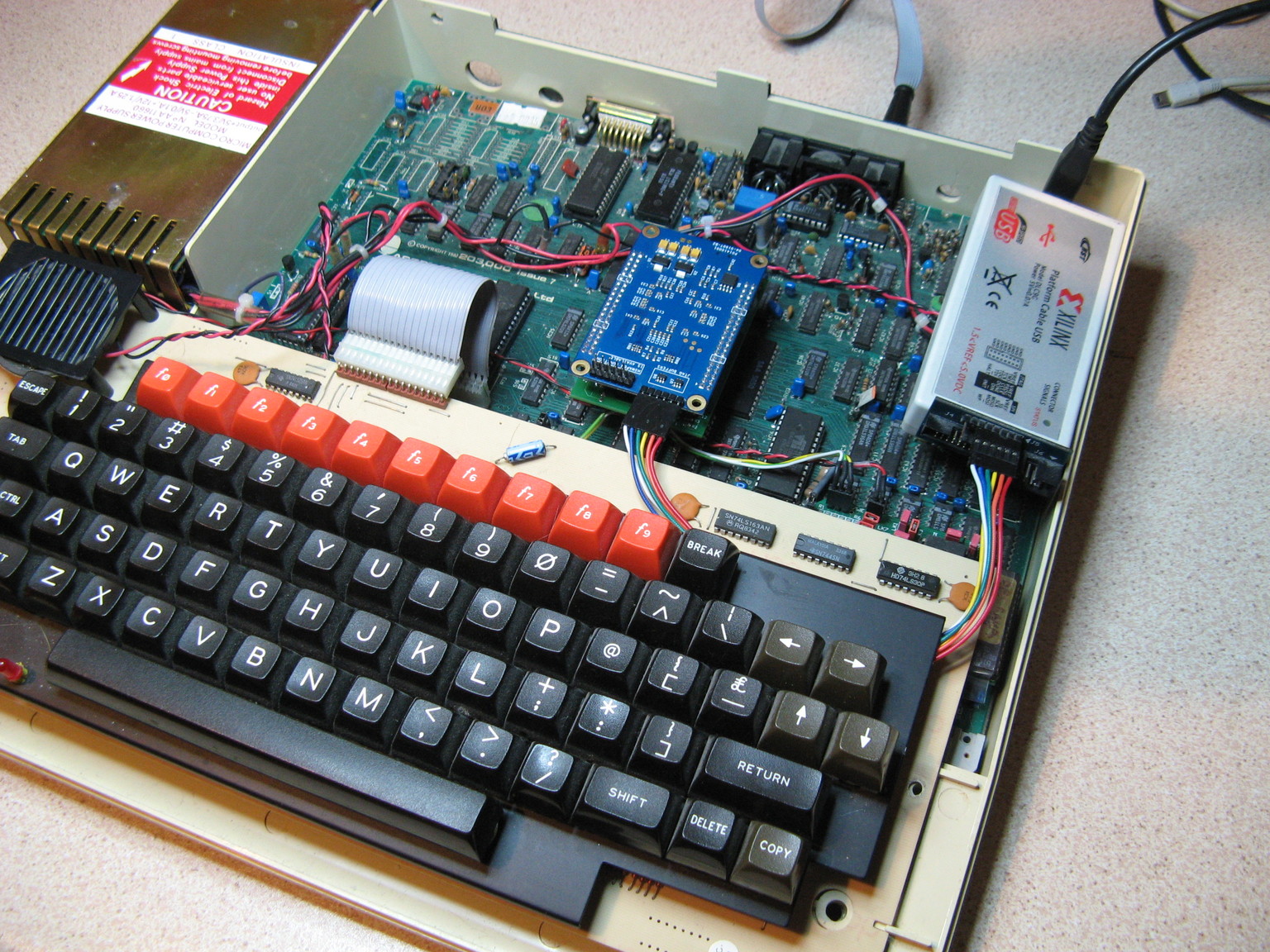

This is in a project called BeebAccelerator, which replaces the 6502 in the Beeb with a Xilinx XC6SLX9 FPGA (currently the same hardware as my ICE. For testing with your new core, the FPGA maps 0x0000-0x2FFF, 0x8000-0xFBFF and 0xFF00-0xFFFF to "internal" block RAM.
The core is currently running at 50MHz. If cycle is deemed "internal" then RDY is kept high and the access is served from block RAM. If a cycle is deemed external, then RDY is taken low immediately, until the Beeb's 6502 clock is at an appropriate phase, when RDY is taken high again to allow the external cycle to complete.
With the test case, zero page and stack accesses are internal, but all code fetches are external (&4xxx is in external memory). So RDY will be low most of the time, which just occasional blips high for 1-2 cycles.
However, I still see the bug if I run the code at &2xxx, which is internal memory. In this case, I would expect RDY to be high most of the time. But that depends on what address your core puts out in dead cycles.
Dave

Ok, I forgot to update address mode bits when copy/pasting lines in microcode. Fixed.

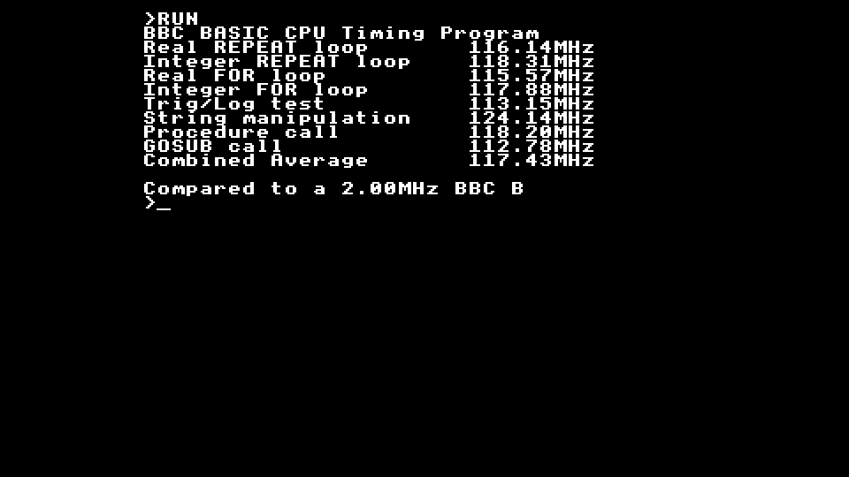

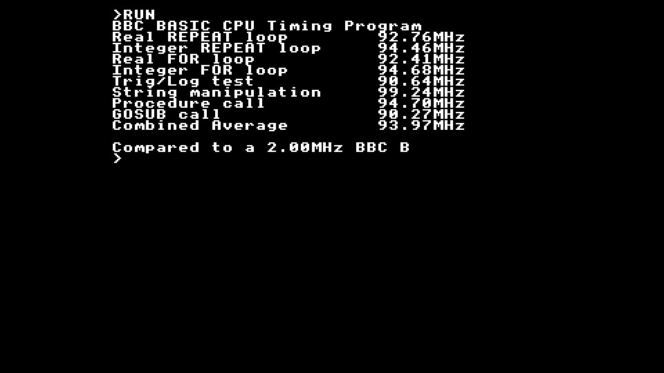

Thanks Arlet, that now boots again and seems to have sorted the RDY original problem. :D
Here's it running with an 80MHz clock:
The generic version doesn't quite meet timing at 80MHz:
Post by Arlet »
Timing looks to be dominated by long paths to/from block RAM. Did you run smartexplorer ?
The path you quoted for the old core is not representative, because it's an unusually small bit of logic that happened to get really long routing delays.
An issue that the new core suffers from is that it needs to be tied to a ROM for the microcode, which limits the routing options. Hopefully it will improve with the distributed version.
Arlet
Joined: 16 Nov 2010
Post by Arlet »
The ASL+RDY+SED problem was because of an earlier method that I came up with for calculating the NZ flags after a read-modify-write. The problem is that the ALU result happens a cycle earlier than other instructions, because the result still needs to be written back to memory, and then the next opcode needs to be fetched.
My solution was to snoop on the data bus during the write cycle, and grab that data to determine the NZ flags (the C flag already needs to be stored in a flop for BCD carry)
Later, I came up with a better method, where I just let the ALU perform the same operation for 2 cycles in a row, and then use the 1st one to write the data to memory, and use the 2nd cycle for the flags. I tested that method with binary ASL, then did INC/DEC, but didn't do the rest until later. But then with all the porting back and forth between generic/spartan, the changes must have gotten lost.
And apparently, snooping the write cycle doesn't work properly if you use RDY.
hoglet
Posts: 367
Joined: 29 Jun 2014
Post by hoglet »
The Spartan6 microcode changes seem to work.
No I haven't - it's not a tool I'm particularly familiar with.
Am I likely to see much of a difference?
Understood.
When you use large block RAMs, the system speed does seem to be dominated by routing delays associated with high fanout nets used to construct the large RAM.
Yes, this is quite painful in Beeb Accelerator, as I would like to use the full 64K. The Xililx tools don't work well with inferred RAMs that are not a power of 2. So if you try to inferr a 62K RAM (leaving 2K for the microcode ROM), it ends up overallocating and then fails. So to try out your core I've had to constuct the memory myself (currently using a 16K and 32K chunks and an additional mux). This may also be impacting performance.
So I'm very much looking forward to the option of the microcode being implemented as distributed RAM.
Anyway, keep up the good work, it's been fun debugging these (minor) issues.
Dave

Even though it doesn't come close to meeting timing at 100MHz, it does in fact run, and appears very stable:
The 15% CPI increase is nice to have.
And these are the slower -2 parts....
What speed parts have you been using?
