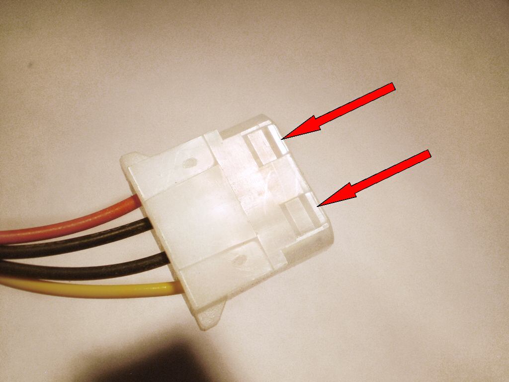

DerTrueForce wrote:
Molex connectors are also really flippin' hard to disconnect
The connector on the PSU end has four concave structures which are engaged by four convex structures on the drive end. You can sabotage one end or the other, or both. Shave the convex structure to reduce its height (you don't need to eliminate it completely). And the concave structure can be widened to reduce the lip at the edge (marked with the arrows). A file is the safest tool to use for this job.

FWIW, some judicious surgery will make a Molex easier to disconnect. Just cut away a bit of the plastic.
