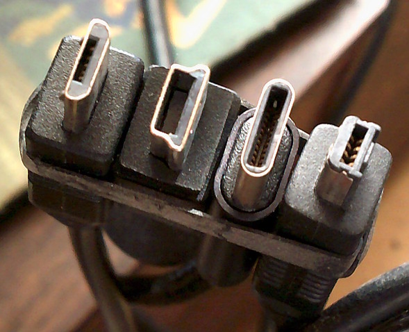

Another thing that I don't know anything about, is USP.
USB?
This requires hardware support. USP is a lot faster than a basic UART --- but I don't know why transferring files at high-speed is needed --- my 65c02 cross-compiler had the Apple-IIc target and MS-DOS host talking at 19,200 baud, which was adequate for my purposes.
And if it weren't adequate, even the 6551 was specified to be able to do at least 115,000 bps if you don't use the internal baud-rate generator, and other UARTs will go faster. RS-422 can do 10Mbps at 40 feet, and RS-485 can do 35Mbps at 33 feet. Both can go at least 90kbps at 3/4 mile. USB can only go 16 feet. I understand that USB is much too complex for the technician to write his own drivers, he can't make up his own cables, can't really troubleshoot it, etc.. I don't know how they can call it "universal" (in "universal serial bus") if there are nine kinds of connectors and male and female of each, or call it a bus if normally one connector only goes to one device. Edit, 10/17/18: I was looking for a USB cord for something and I picked up cords with four of the smallest USB connectors I happened to have on my desk and rubber-banded them together for a picture. Actually, none of these fit the USB connector on my Samsung Sprint phone. That one is yet another size, just a hair wider than the widest one here:
