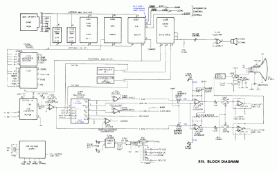

Thanks to the link Ed provided, I've been able to examine the Vectrex ramp-generation circuits, which I find to be delightfully sparse and elegant. Here is the Block Diagram (stitched together and annotated from pages of the pdf file):
This brings me back to my original supposition that, at the lowest level, the interface to the Vectrex accepts an X and a Y speed command from the CPU for each move of the dot (ie, the CRT's electron beam). In my previous post I assumed the Vectrex used coordinate-based commands, as apparently used by Cinematronics; I've since edited that post.
Referring to the Block Diagram, the signal ZERO can be used to discharge the integrator capacitors, returning the dot to 0,0 (screen center) and thus providing an initial reference. Except for this "calibration," the dot travels point-to-point in a series of relative motions. For each individual motion, a Y value from the DAC is latched into the Y Sample & Hold, after which the (unlatched) X value is written to the DAC. Then the CPU triggers timer 1 of the 6522 VIA, thus asserting the RAMP signal. For a controlled time interval, the integrators slew positive or negative at a rate proportional to the respective signed values of X and Y. At the end of the interval the dot freezes indefinitely; the integrator cap's "remember" the dot position until the next motion commences. (However, the calibration step would need to be repeated occasionally.)
Finn wrote:
the slower you move the beam the brighter or thicker the line, because it dwells longer on the screen.
Yes, exactly. But also: it is the X and Y speeds which, relative to one another, determine the direction (slope) for the line that's drawn. The line length is determined by speed and by the time interval. (At least that's how I see it; comments & corrections on any of this are welcome.)
I dont know the exact hardware details because i am using BIOS functions to move the beam.
That totally makes sense -- for what you're doing you need to direct your attention to the BIOS calls. Others (like me) can't rest until they've grokked the hardware interface. :D
