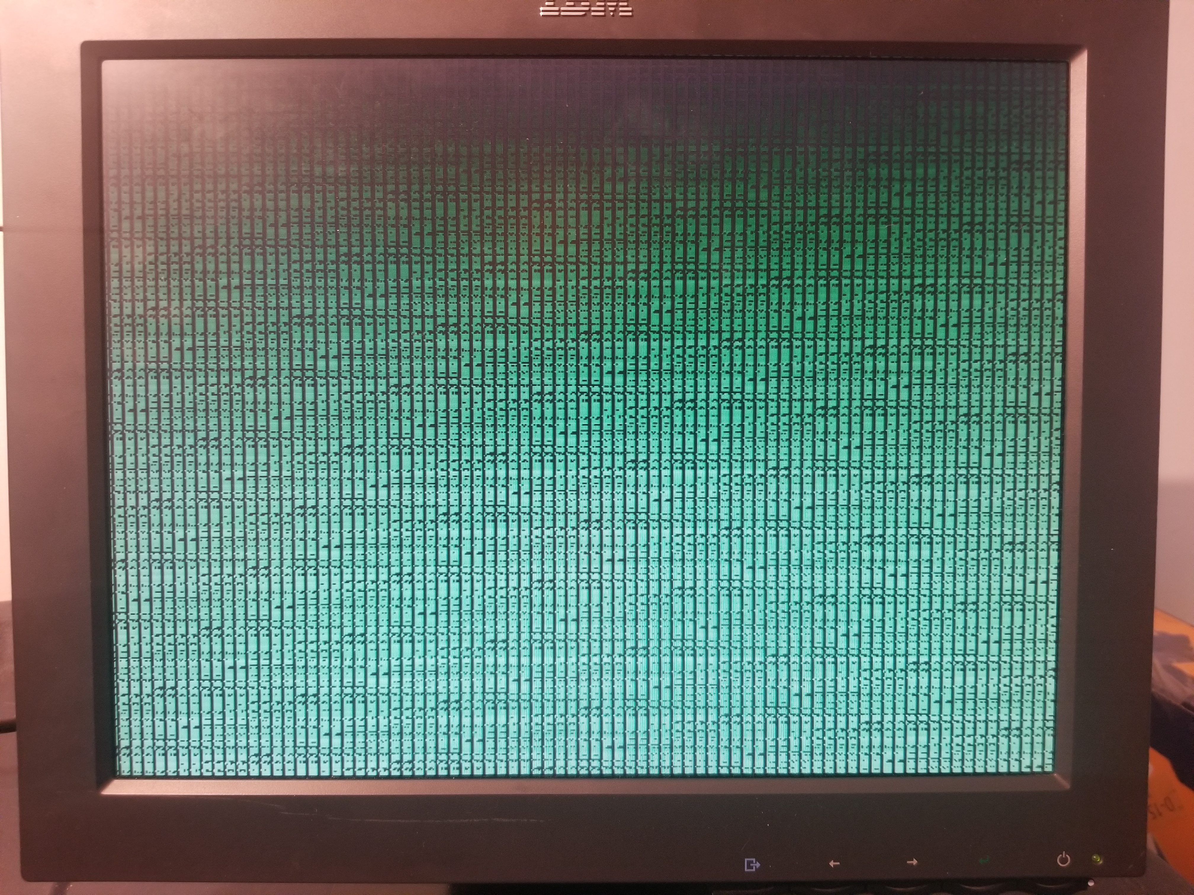

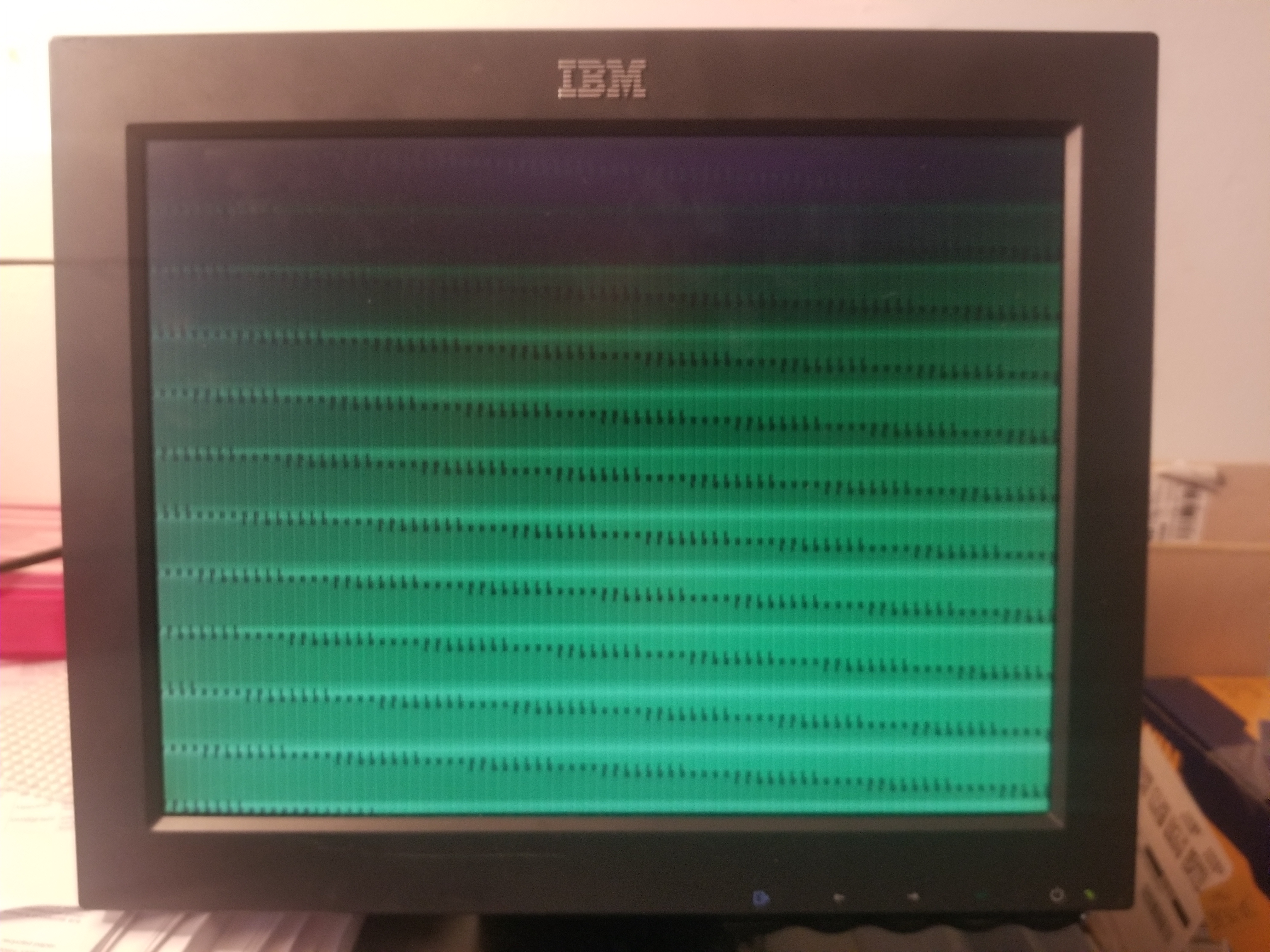

As requested, random ROM junk:
I think this one is an early version of the SYNC signal generator ROM.
Here's Blue April's system firmware ROM (the first 256 bytes of it, anyway):
Edit: one thing to notice here is that you see each byte twice. This is what I would expect, because I tied the "character ROM" (i.e., random junk) address lines to the sync ROM's address lines. This means that the "character ROM" incriments whenever the sync ROM does, which is every 16 pixels. However, the output stage is running on the character clock, so it loads every 8 pixels.
This is with a 74hc166 (synchronous load) shift register.
Because the counters start in an unpredictable state, right now the output can be off by up to 7 pixels when I first power up. To fix that, I made a little reset circuit to synchronize all the counters. Right now it's just a push-button; I will need to convert it to a power-on reset circuit for the finished thing. But it does work! When the system is on and pixel 1 is where pixel 6 goes (or whatever) you can push the button, and everyone jumps over to where they belong. :)

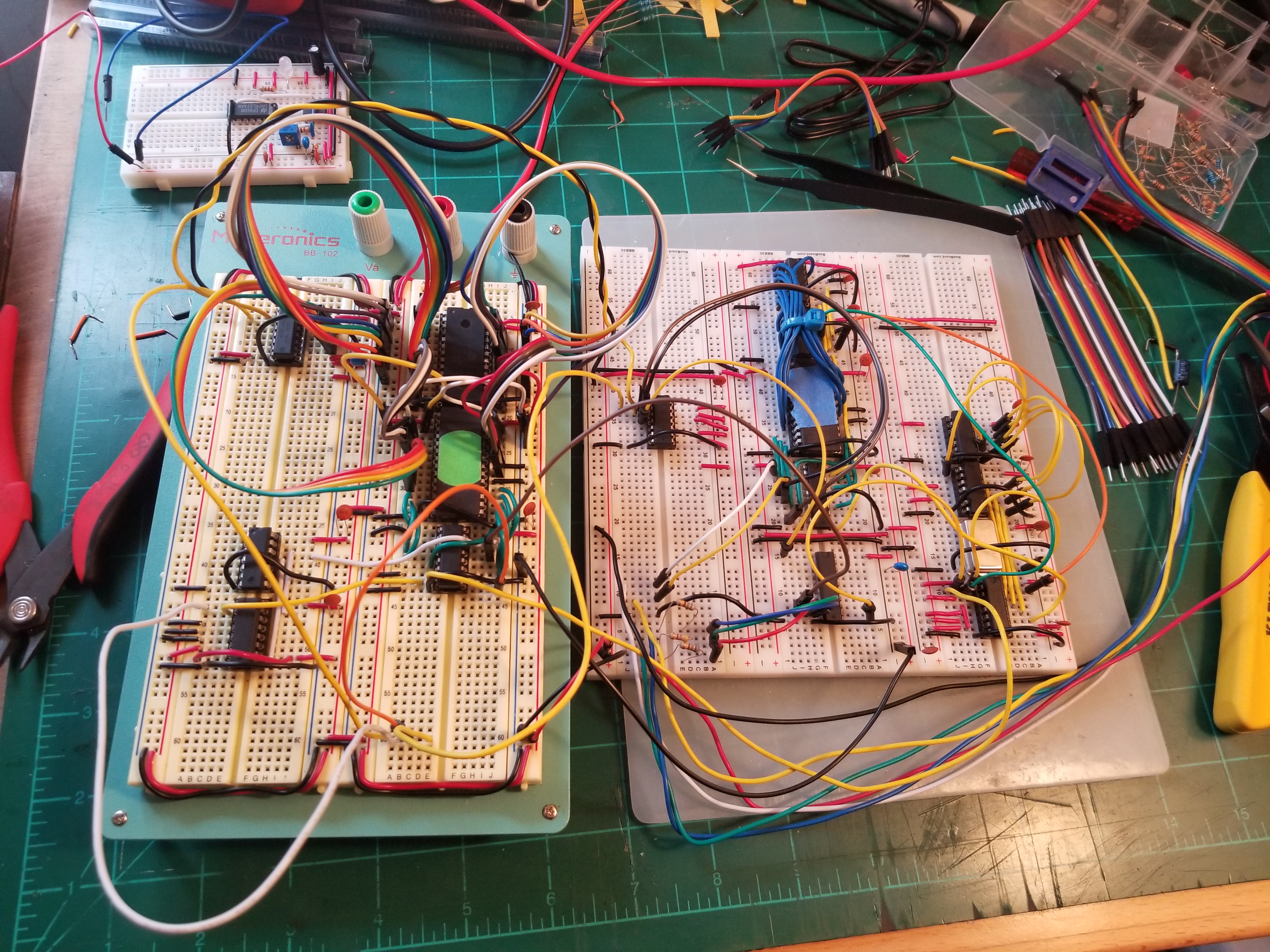

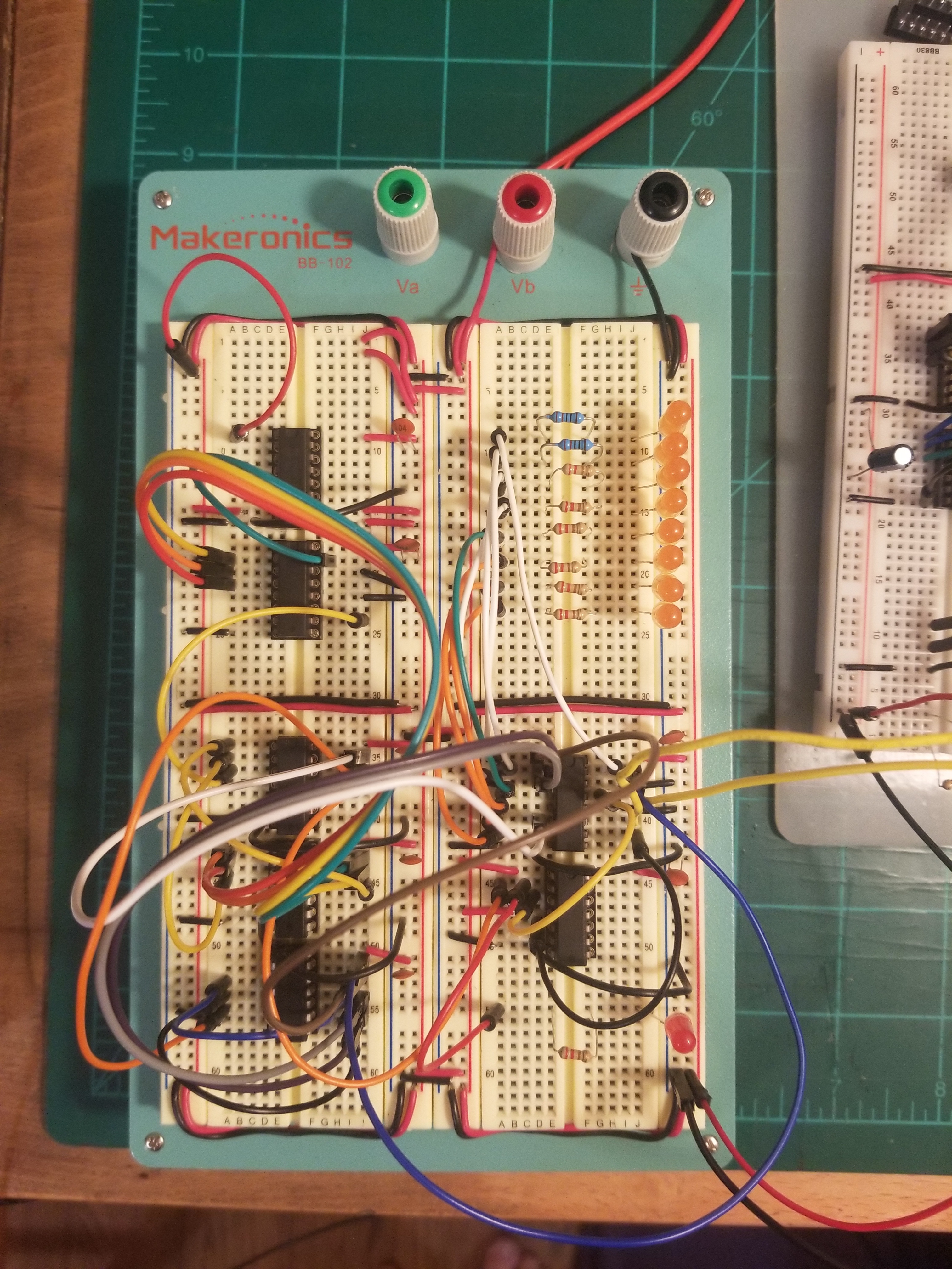

I made a little bit of progress today. I thought pretty hard about how to make a linear address generator and couldn't come up with anything simple. I'm reluctant to go back to the 6845 for various reasons (one of which is that I just don't like to give up on something until I've figured it out). So, I decided to use row / column addressing. That makes the counting problem considerably more simple to solve, at the expense of some wasted RAM.
So I started building some timer circuits. The first one was easy; I need a 0 - 15 scan line counter to tell the character ROM which line of a 16-pixel tall character we're on. It will count 0 - 15 one time for each line of characters, 30 times for a whole frame. I can use a 74HC163. It, by nature, counts from 0 to 15 over and over again. :)
To get the row part of the RAM address I need to count from 0 - 29. That takes 5 bits, which is more than a '163 can do without cascading, but I have some more '590s. I used a few AND gates and a NAND gate to detect "29" and issue a reset signal. I set up some LEDs to test it, and it worked fine.
Then I moved on to the column part of the RAM address: 0 - 79. I made exactly the same circuit as for the row counter, except that I needed to gate 7 bits to generate the reset instead of 5. This one didn't work. I did a lot of troubleshooting. I added a bunch of LEDs, used a slow clock, etc. No matter what I tried, it would reset as soon as bit 6 went high. I thought maybe it was crosstalk, or ground bounce, or parasitic capacitance, so I added a bunch of bypass caps and ground return loops. No change. It would reset, even though the LED on the reset pin never went out! So, I added a flip-flop to latch the reset signal, and that fixed it.
I'm not sure what to make of this. The row counter is identical, except for gating two extra bits to detect the reset condition. Maybe I should add a latch to that one too, just in case...
On the left:
74HC163, 74HC590, 74HC00, 74LS08, 74LS08.
On the right, my trouble lights, 74HC590, 74HC74.
All those loopy jumpers must be pretty noisy. I wonder if I could get by without the flip-flop if I replaced them all with nice flat wiring.

Paganini wrote:
...No matter what I tried, it would reset as soon as bit 6 went high [...] So, I added a flip-flop to latch the reset signal, and that fixed it.
The '590 has an asynchronous reset, so any glitch on the reset input as logic is settling, e.g., due to logic hazards, could cause the counter to reset. Logic can be designed 'hazard free', however the latch you used is an appropriate and simple solution. I would think it's a good idea to use a latch for the row counter reset too, as it's possible it would suffer similar problems under some operating conditions.

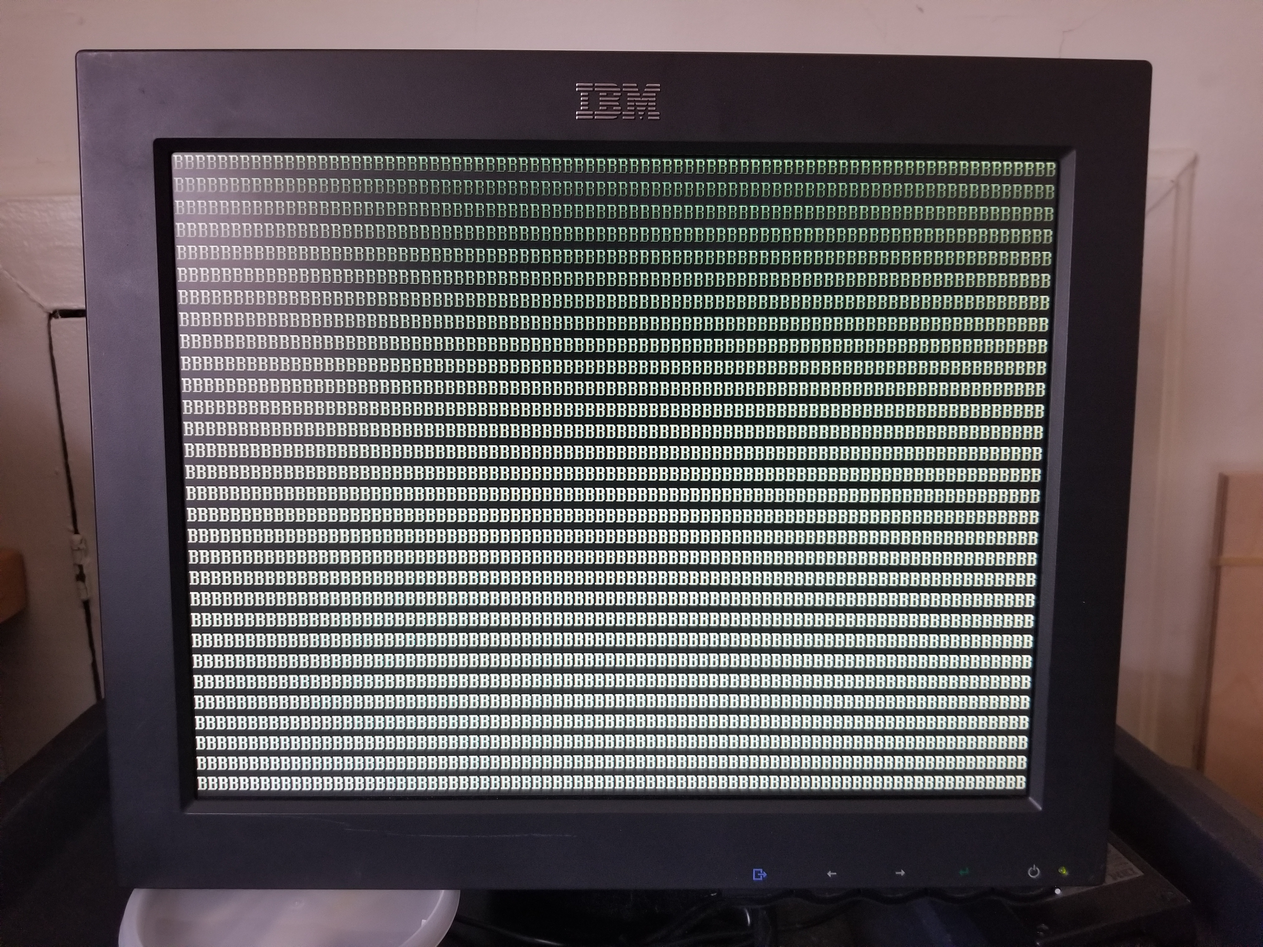

I've been trying to write this post for a while, but I keep being interrupted! Holidays are a busy time for a musician. Anyway, a while ago Chad requested a photo of the character generator ROM in action. Here it is!
This is proof of concept, more or less. The 'B' is being decoded and displayed the way it really will be in the final version. The differences are that, for the moment, instead of a RAM frame buffer, I have an EEPROM with 0x42 stored at address zero and all the address lines tied low; and that to get stable vertical output I have all the counter reset pins tied to the VBLANK signal.
Nice B's! I'm an type-A person myself, har har :)
I'm impressed, very good! The display is crystal clear, very good!
Are there intentional spaces between characters that are hard wired? Or are those gaps in the software/ROM?
My biggest concern is the timing. Not to press you, but I would be cool to see the the RAM -> ROM -> VGA.
I don't think there's any space that isn't part of the glyphs; the "white" space (as it were) above and below each line is present in the character generator ROM (the glyphs are 16 lines tall, but the characters are shorter than that). The space between the 'B's (AAAAH! NOT THE Bs! AAAAH! THEY'RE GETTING IN MY EYES!) is also part of the glyph; I think it's one pixel fore and aft.
I almost had it today! Well, ROM -> ROM -> VGA. I had stable video for about 10 seconds using the row / column counters, and reading from the ROM framebuffer. There are just too many long wires though, and the clock signals are suffering. I'm going to have to consolidate onto fewer breadboards and rebuild a few areas. I think part of the problem might be that I had to use some LS gates, and their signals are pretty weak and bumpy, even with pullup resistors. When my next Digikey order gets here I will be able to swap them out for HC parts, and also reduce the chip count a little (using 4 input gates instead of 2).

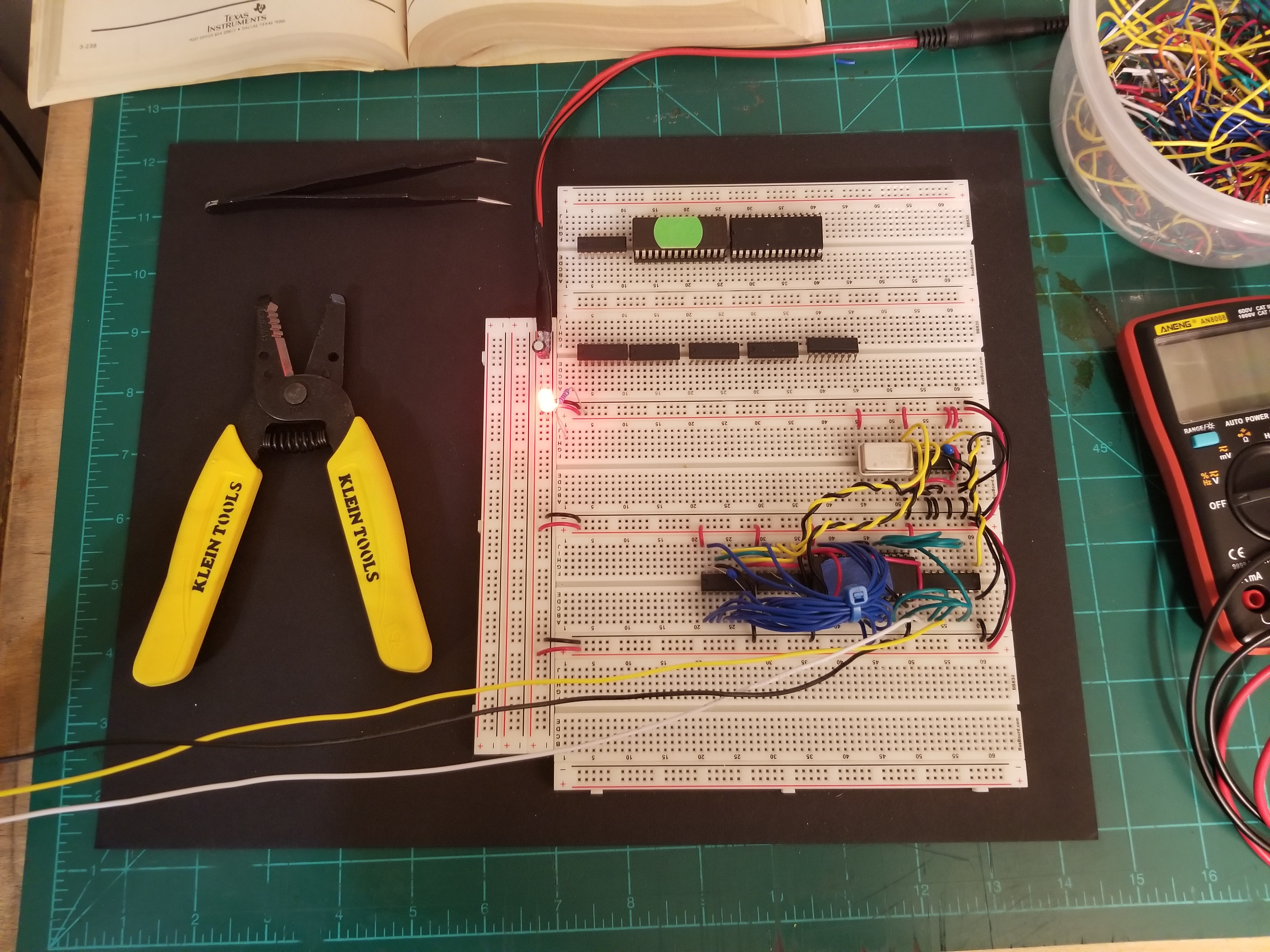

Migration in progress:
The sync generator still works; that's a good sign! I got too impatient to wait for my CAT6 to get here, so I rolled my own. Maybe I will replace those chunky clock wires, but they're working fine for now.
